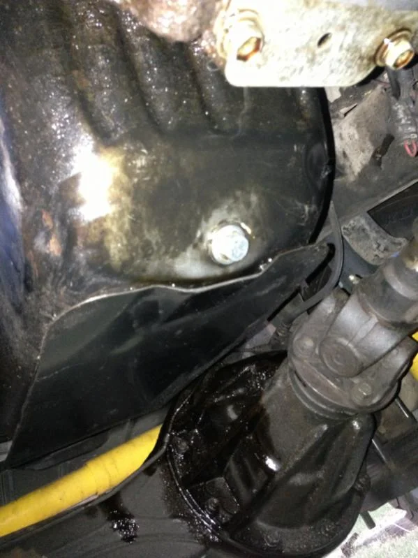

Just to revive this one a bit...for all other FJ60 noobs thinking an oil change is no big deal.
Holy crap. I used one of the big plastic oil pans...but oil still went everywhere! Came out like a dam burst. Poor driveway.
I would recommend anyone to use a wide-open, large vessel of some sort. Nothing with a small hole. A large-ish, low-walled bucket would be best, I think. It is what I will use the next time.
