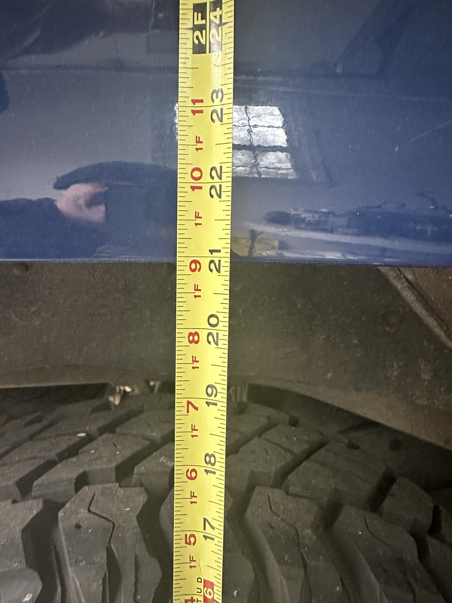

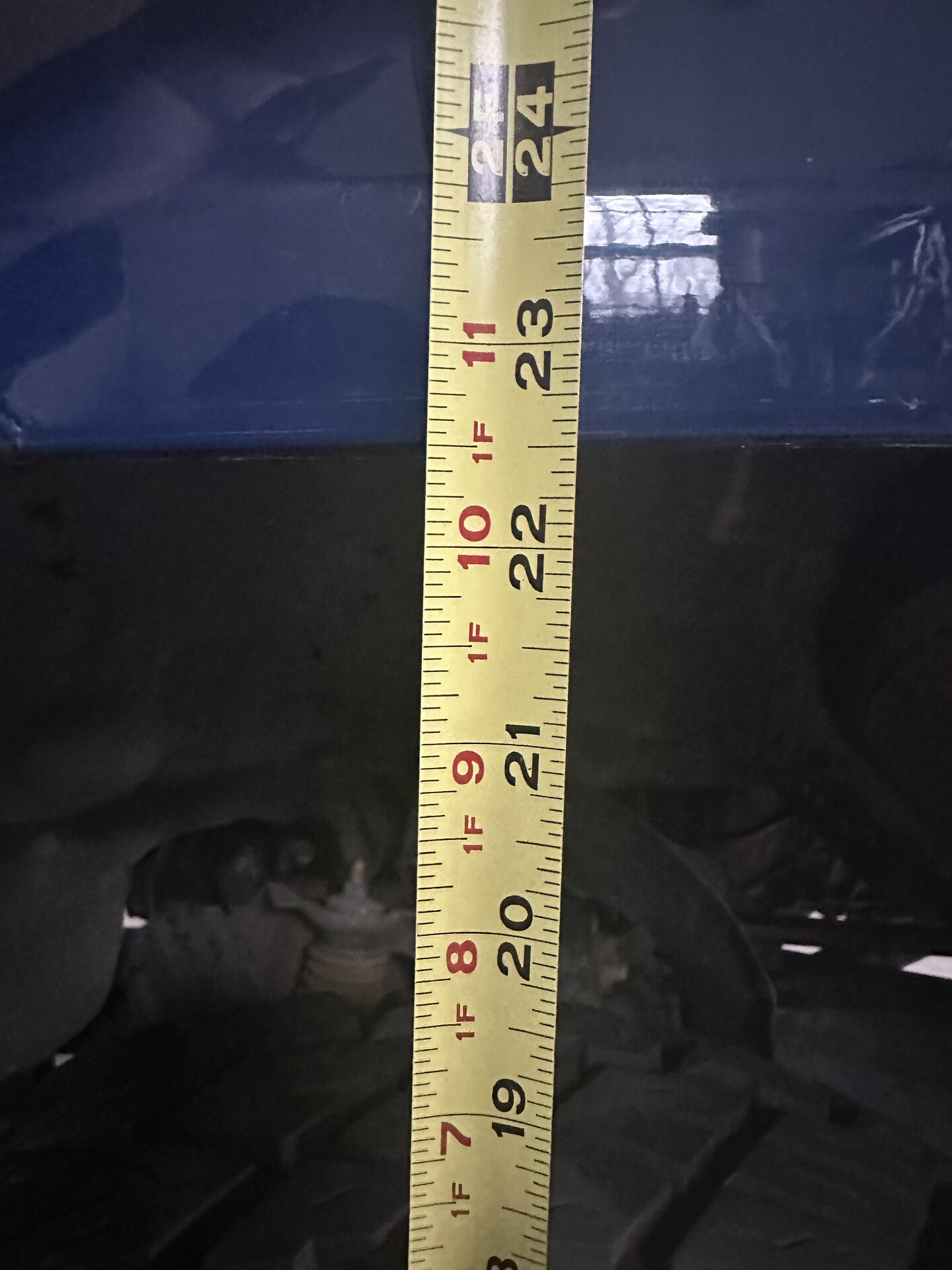

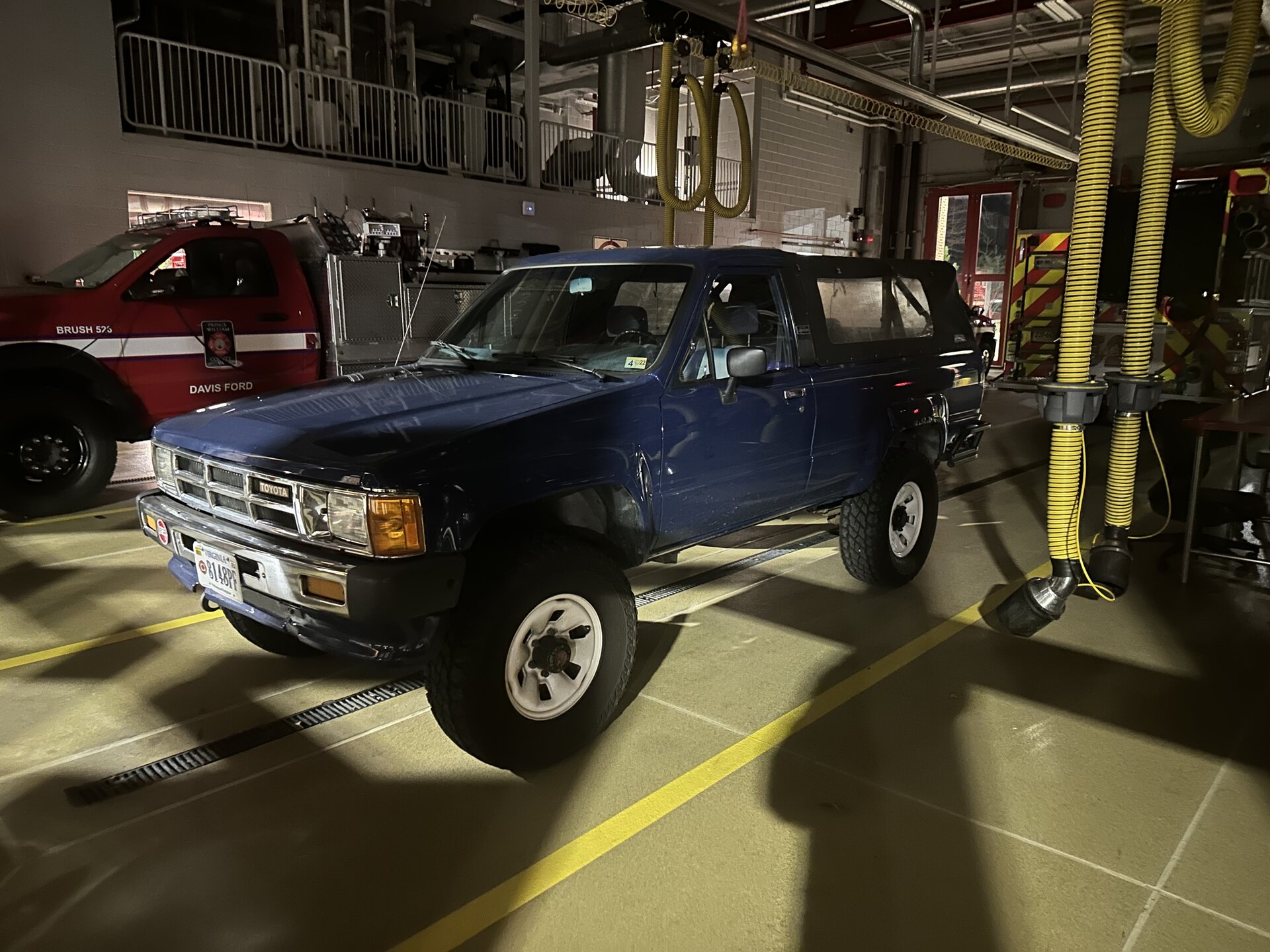

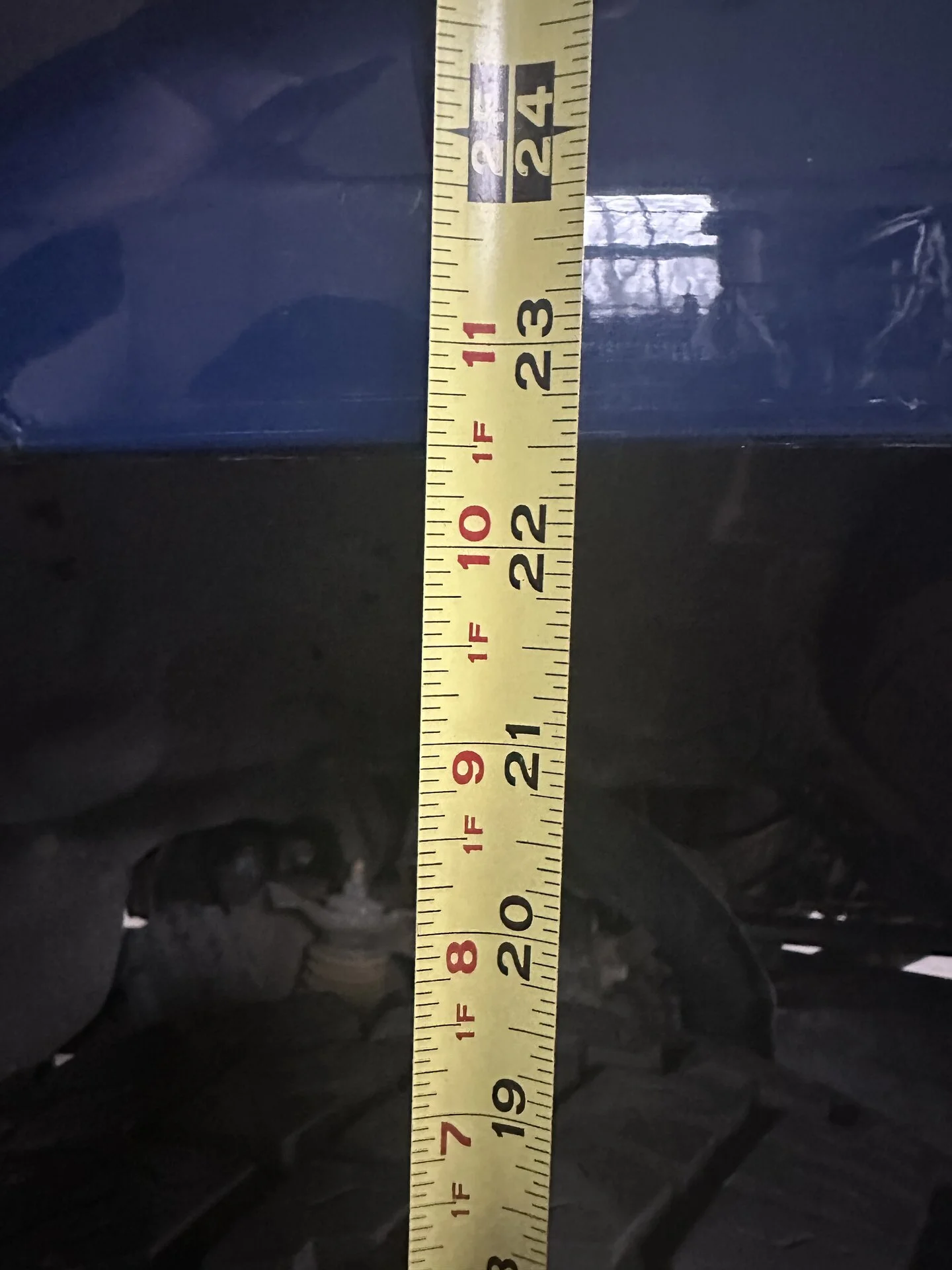

I'm basically trying to figure out how my truck is currently configured.... It needs new suspension... everything under there is pretty worn... I'm fairly certain it has an AAL in back with torsion bars cranked up front.... but when I refresh I want to keep the same measurements... more or less... I'm also running a soft top... So I am debating an OME kit or Dobinsons kit and pulling leafs or just new stock springs and seeing what that yields then doing an AAL if needed. I'm not interested in doing Chevys. I also then have to figure out shocks... seems most of the shock options are more for 3" of lift + or stock. At least the billsteins. In any case... I have a lot to think about, I'm just mostly concerned with how to get the rear basically where it is now with new stuff.
Front from center of hub
Rear from center of hub

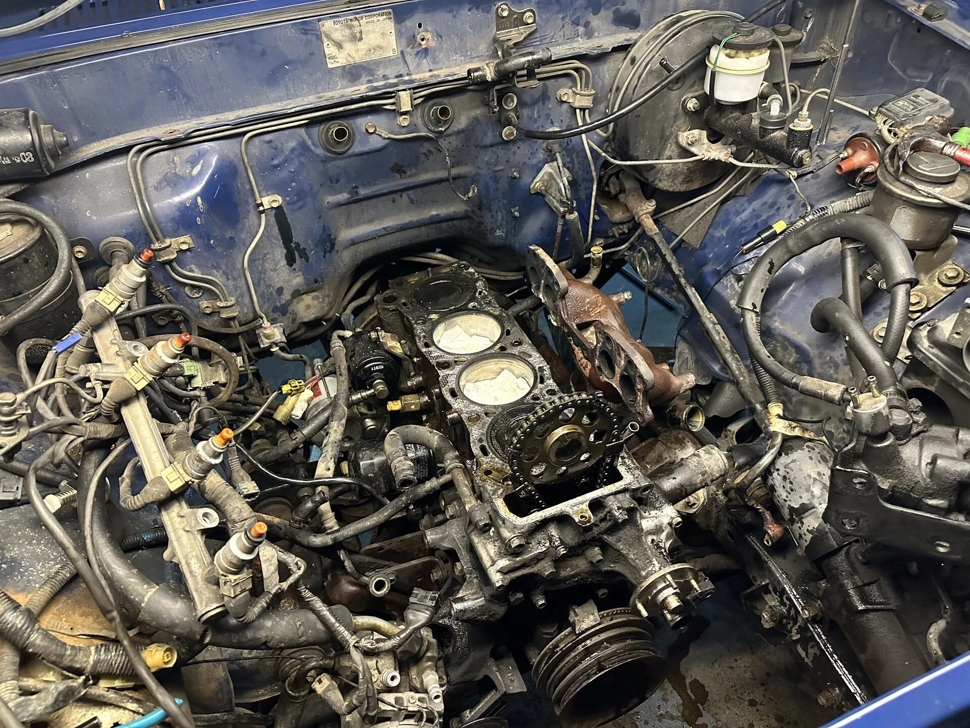

I’m still trying to decide what I’m gonna do. I want a 60 or 55 project but if I can’t get a good trade or price for the 4Runner I’ll probably throw on an all new suspension. It’s in my garage right now getting new timing chain and all new gaskets/seals fan clutch, hoses etc…..

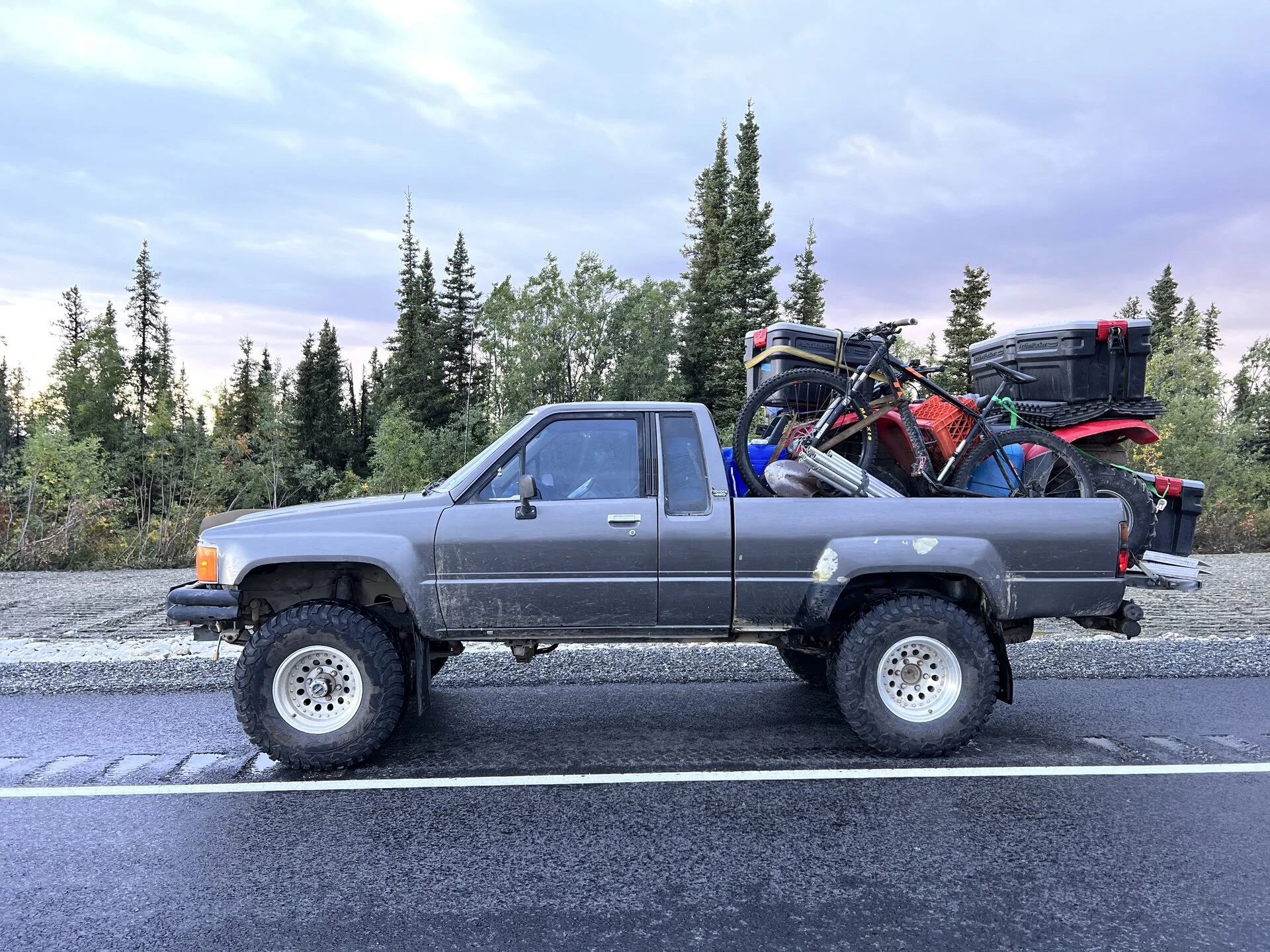

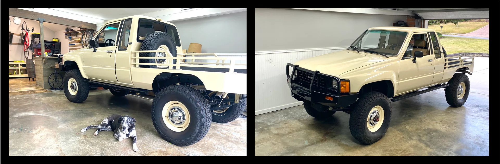

I've got a hundred miles or so on unmodified OME springs. They are stiff (!) and the truck is a bit taller than I'd hoped. 100 miles isn't enough to get these to settle, but given how few miles I put on this truck, it makes more sense to shortcut the process and pull a leaf.
for reference, the tires are 33s and Louis is a 70lb Catahoula ;-)

That’s a sweet looking truck!
I’ve got the heavy OME springs under my ‘85
Unloaded they were uncomfortably stiff in the rear, I tossed approximately 600lbs of scrap steel in the bed last summer and hauled that plus my normal loads for a few months. Much, much better now. The truck actually sits level-ish and rides pretty well.
Even stiff it handled better than the skyjacker kit that was on there previously.
It’s worth noting the suspension is two years old now, a 30gal aux fuel tank lives in the bed, and I’ve hauled loads heavy enough that the truck felt unsafe above 45mph…
Time will help, although the front end was also stiff until I put the winch bumper on… now it feels like it’ll need another leaf in the future.
Here it is moving my summer camp. I got the little diesel strung out to a whopping 65MPH at one point!
