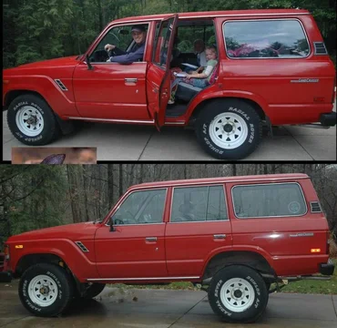

Hey Jeff.
I did the medium heavy at the front and heavies at the back... it had a stink bug...
I def did not like the way it look (yeah I know its supposed to be good for yah, but hated the look) so I went and bought some extended shackle and 4º caster shims... for the front and put a 4+ rear bumper... now it seats nice and level when empty..
but it sags when it fully loaded (1800@ + 5 people) with climbing/riding gear....

Negative Stink
Negative Stink:
