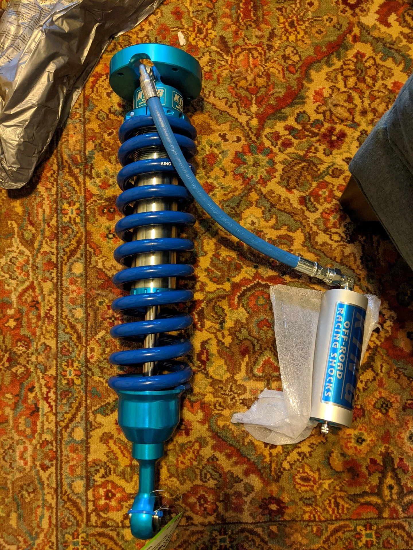

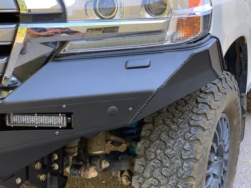

Let's start with the Kings. They will last as long as the truck, parts are readily available, they do well to absorb smallish bumps compared to say Icons and will do it very well over 8 hours of washboards, potholes, and rocky roads.

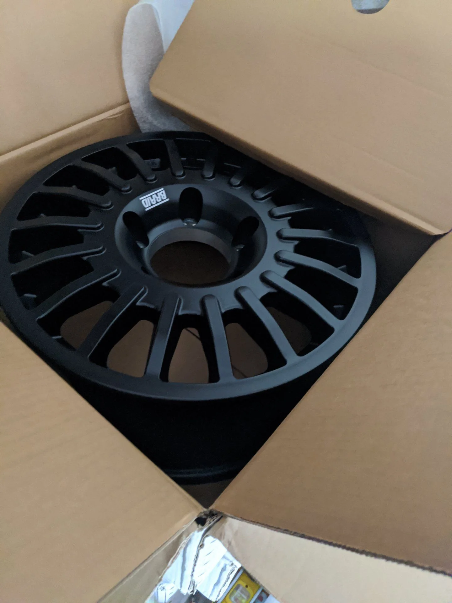

Braid winrace rims I could get the offset I wanted in a 17" and their quality is top notch.
Dissent because they make durable and light protection.

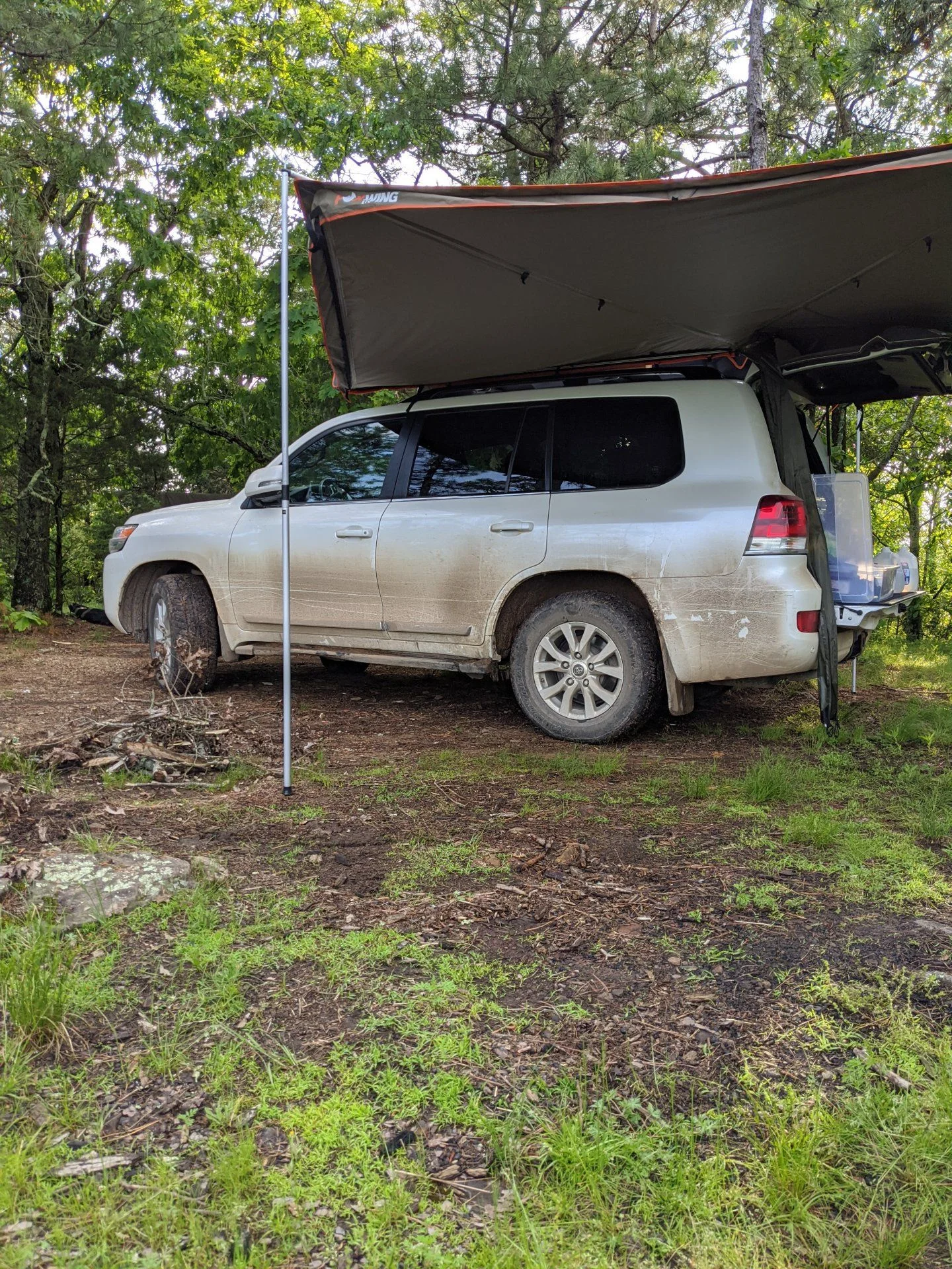

The Thule helps considerably. I drool over $300 aluminum cases, but the Thule swallows sleeping bags, pillows, thermarests, chairs, tables, and duffel bags--the bulky lightweight items I want on the roof all in an aerodynamic box. Concerns about durability have not been borne out.
Next to the the Thule I can slide two RV5 Oztents and an awning without exceeding weight limits.

Phase I: Thule, tents, awning, Yeti, bike rack

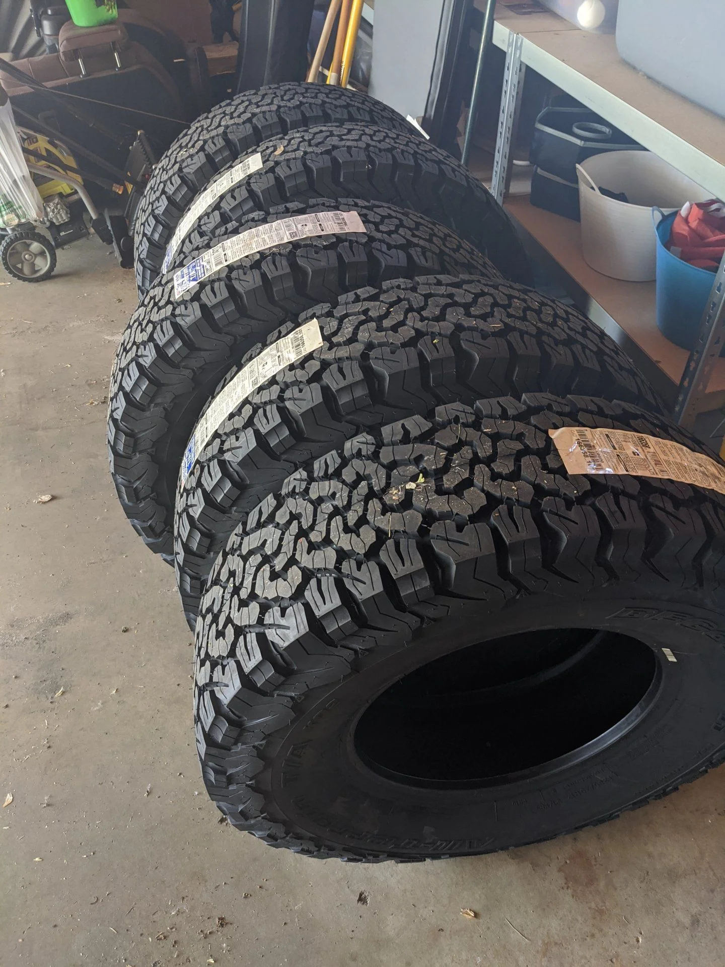

- 285/75/17 KO2s
- Braid Winrace T 7.5 wide rims at 40 mm offset
- King 2.5 remote reservoir coil over shocks, standard length and valving, no fins nor bypass, 650lb springs in front, 440lbs in back. SPC UCA.

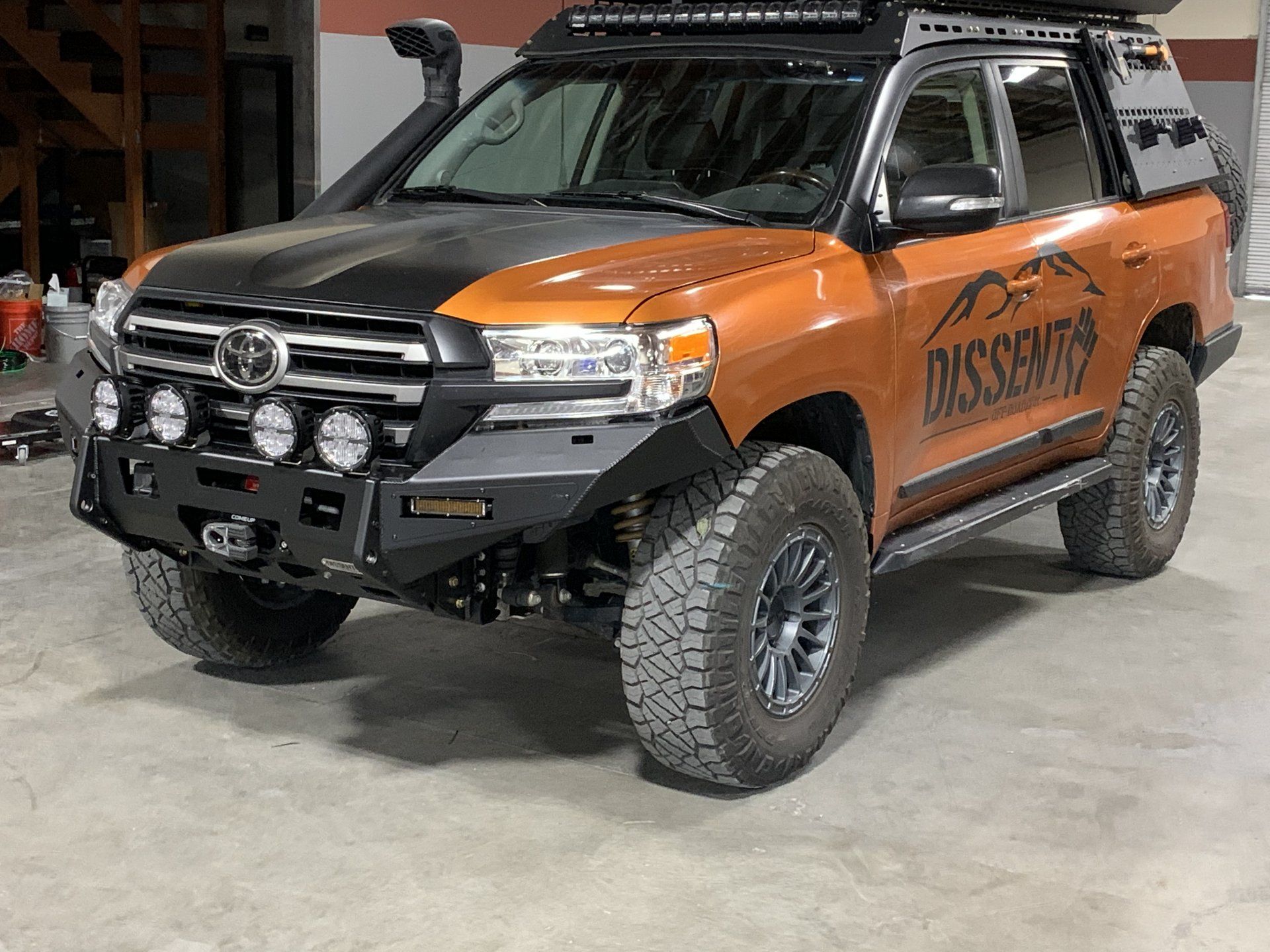

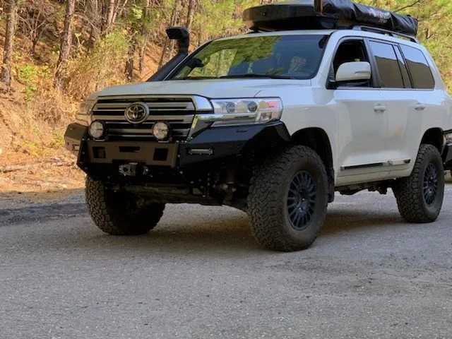

- Dissent aluminum front bumper with lights on and in the bumper
- Winch
- Dissent aluminum rear bumper with tire swing out and storage
- Dissent sliders and armor
- Long ranger fuel tank

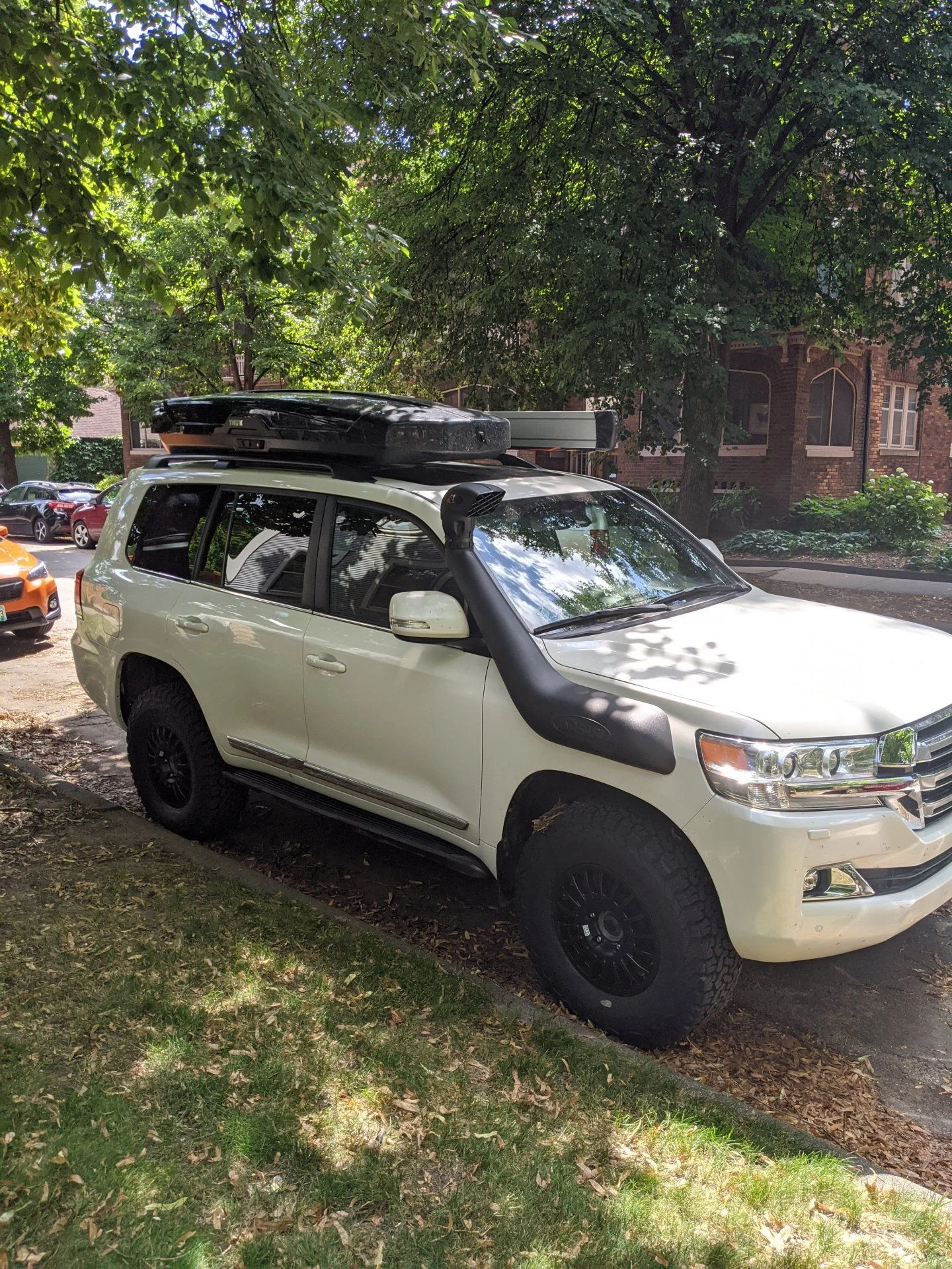

- Safari snorkel
- Air tank to reinflate tires
- Diff breathers
- Cell booster

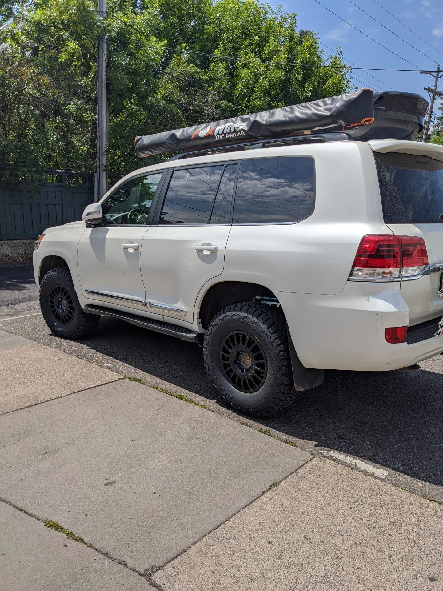

- Roof rack
- Thule cargo box

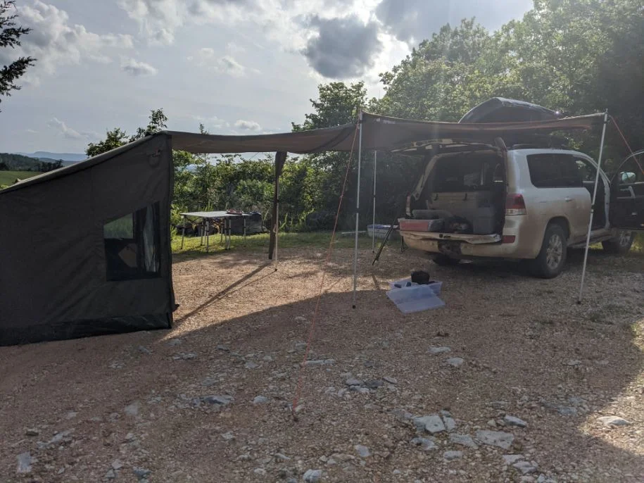

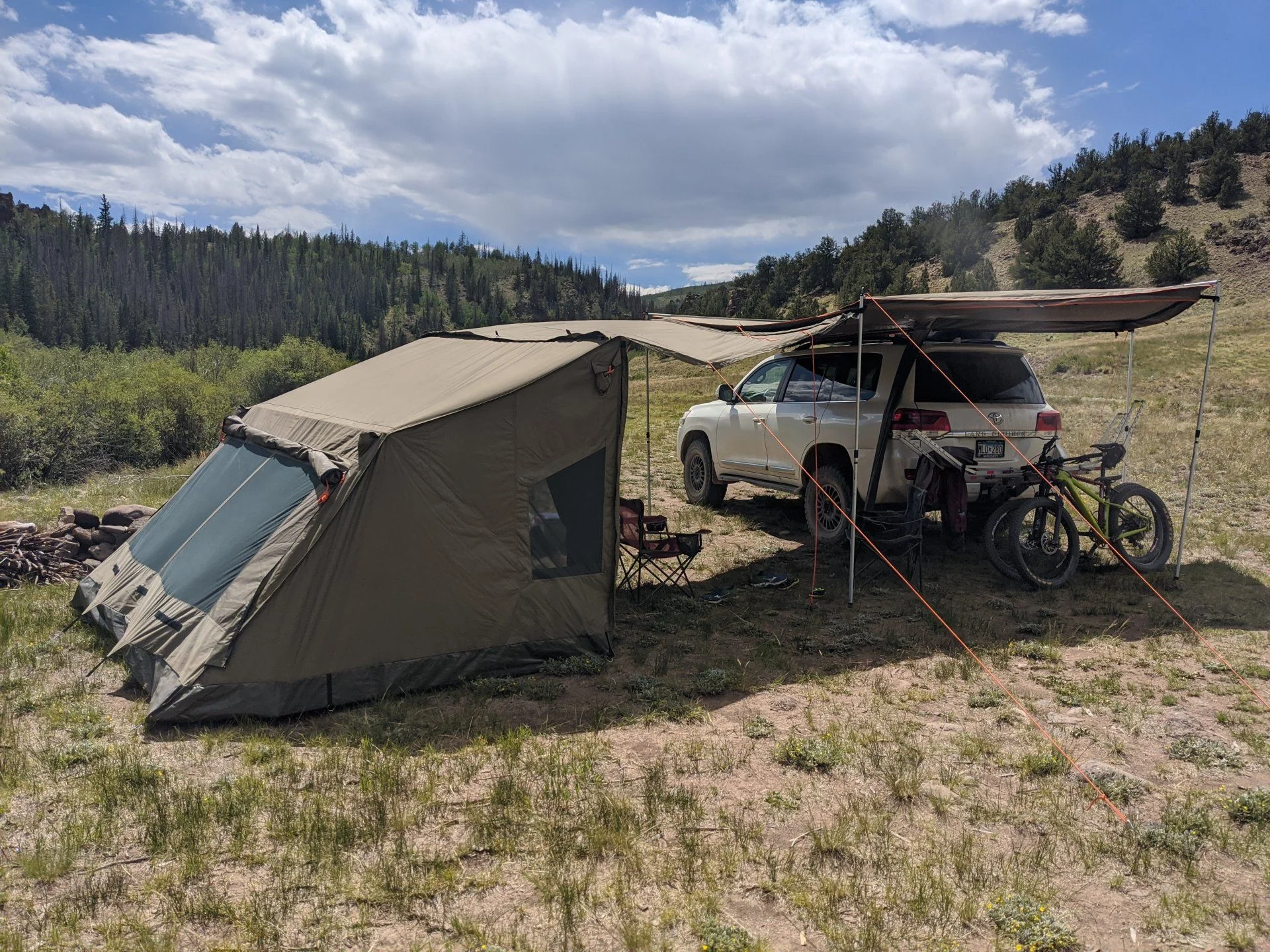

- Oztents
- Awning
- Yeti cooler
Long ranger fuel tank, snorkel, and diff breathers to decrease the risk that I strand myself and the family by being a numbskull which I have the proven capability of being (see my post on electrical damage due to driving in a mud puddle).
Three kids in the second row, one in a third row seat, with one removed gives me some space internally.
