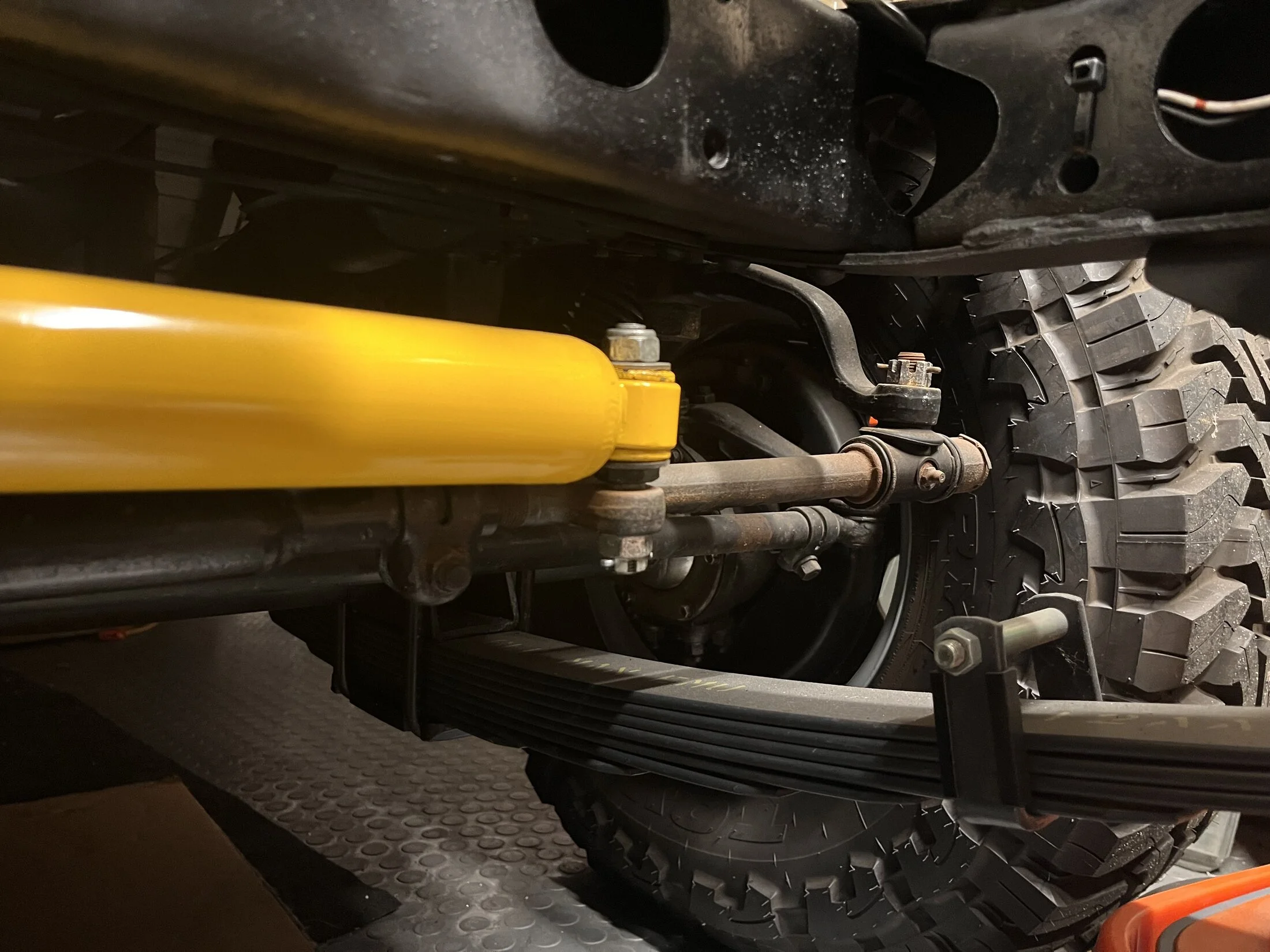

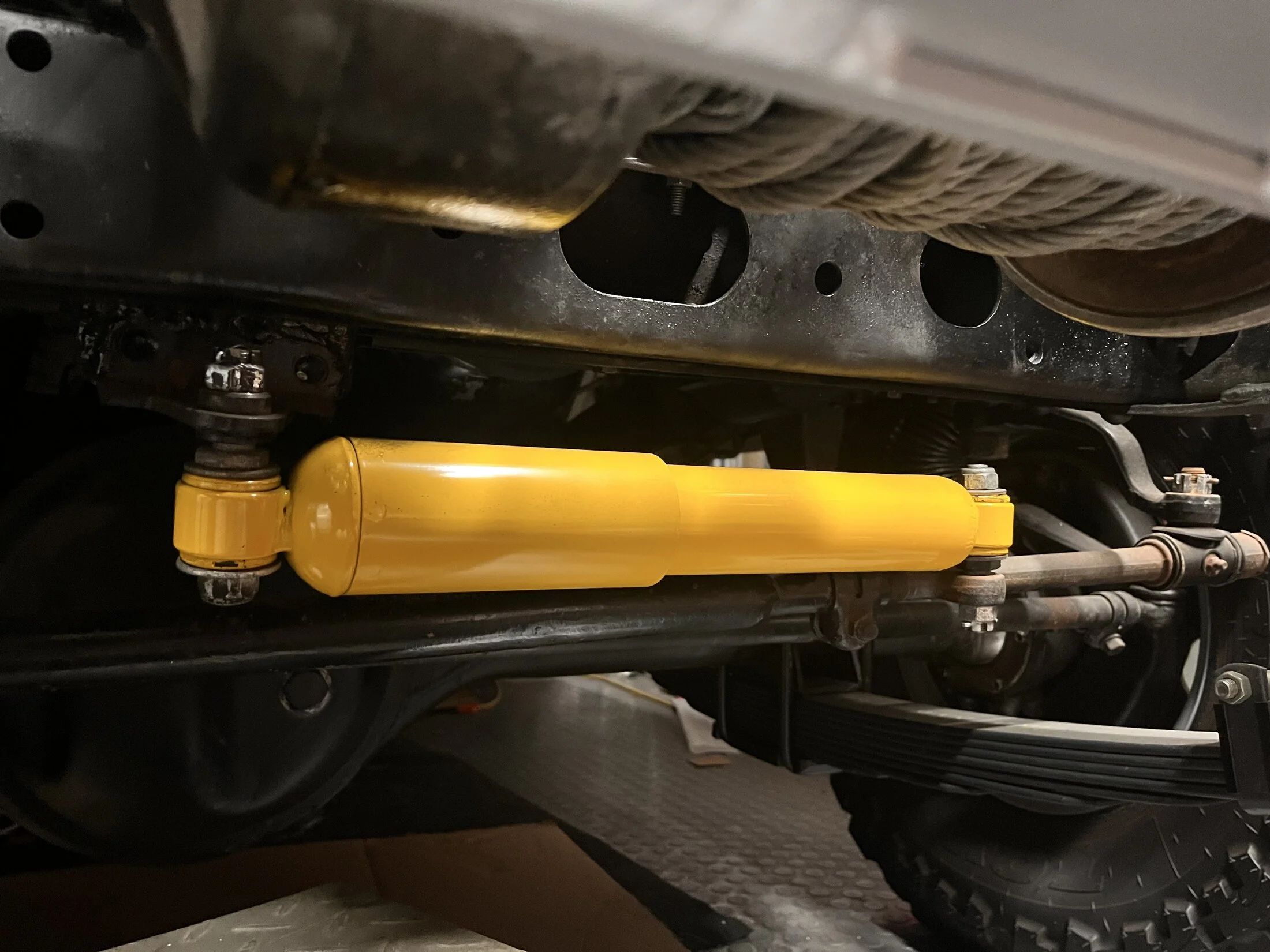

I think @bikersmurf figured a way to use a stk dampener. I run Scout steering which is similar and I dont run a dampener, but my steering geometry is spot on. You might not need one.
I can’t take credit for it as I saw it done locally by another mudder. He used 70 series TREs I believe. I used a mini truck and a 60 series damper.
Details…
