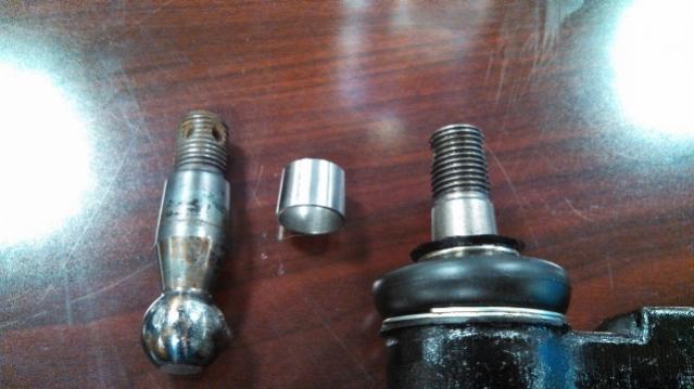

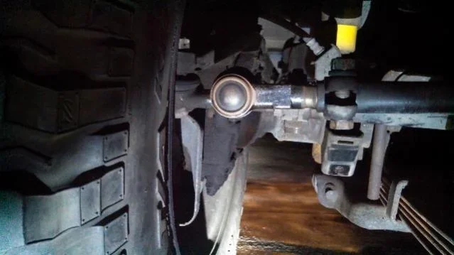

I put this tre from an 80 on my 62 to eliminate those funky spring-loaded jobbers. Just had to machine the tapered bushing since the stud is smaller
dozer...
So, all you need is the tapered bushing and the 80 TRE is bolt-on?
It seems that many shops don't tighten the drag link ends - they don't know what they are. An easy and cheap fix for 60-series. I run them quite a bit tighter than spec, after cleaning them out and fully greasing them. Tightening those is usually the single biggest 'steering slop fix', followed by slightly tightening the steering box.
The bushing is 4140. No pics of making it, just made it on a really old lathe at work. I'm sure tightening the OE ends would have cured the slop, but I needed tire clearance. The OE end rubbed the tire when turning left.
