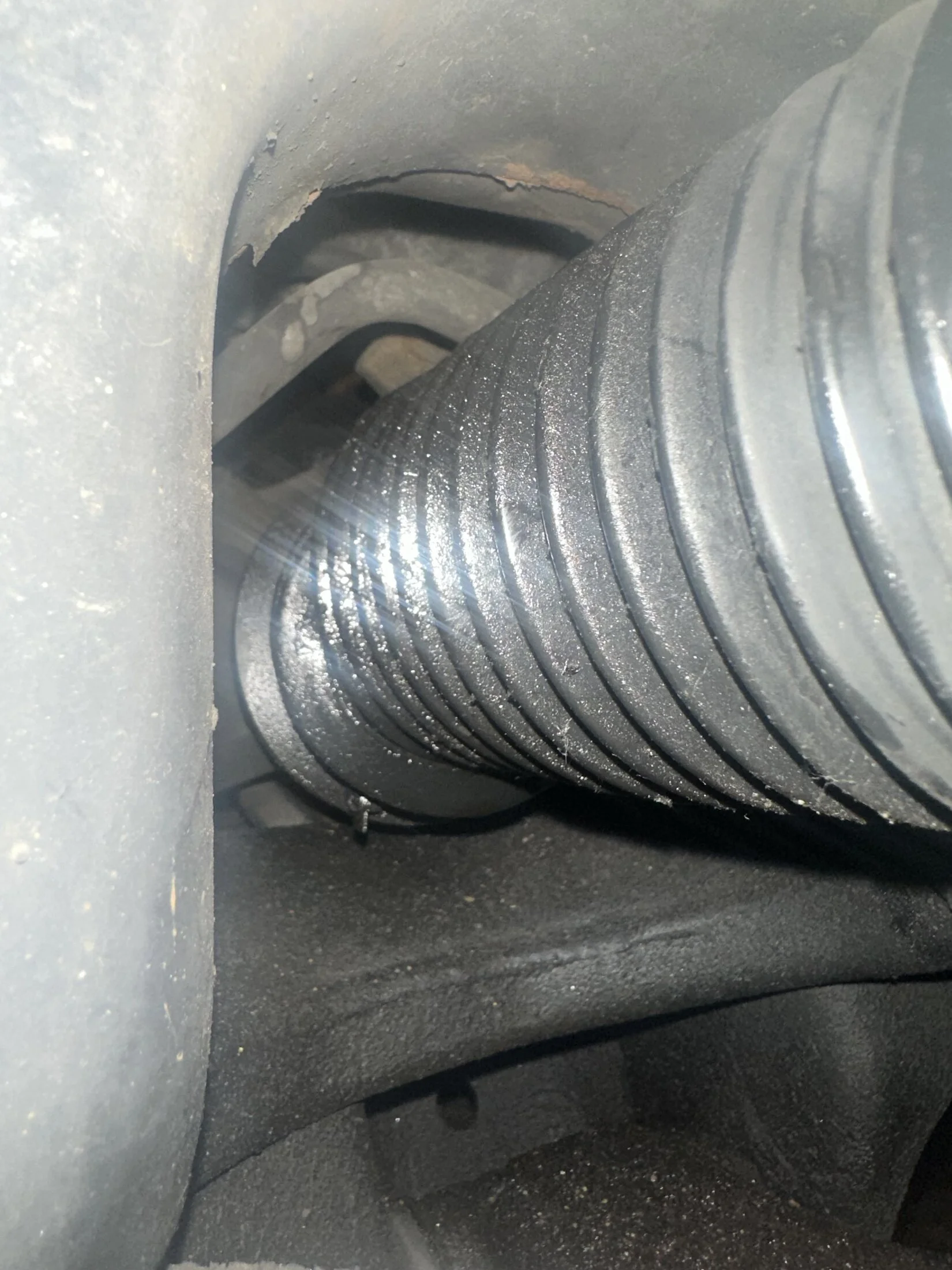

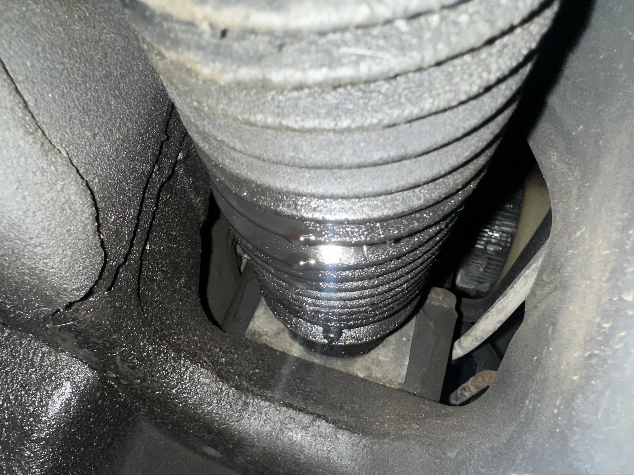

Mild leak at output shaft and bad mounting bushing. Or bad leak at output shafts (inner TRE boots filling with fluid). Then I'd R&R R&P.
Also some of these aftermarket racks are junk. They tend to have to light preload on pinion. Result in a tiny bit loose steering feel (i hate that). So I like swapping in OEM R&P.

According to the previous owner, the leak only requires adding a bit of fluid every few months. He included a half-full quart, and said it took 2 years to use the first half. The stop leak advised here, I forget the exact name, has already been added.
The steering feels pretty good.
I'll attach some pictures on the leak at the boots but it sounds like you already know what it looks like.
