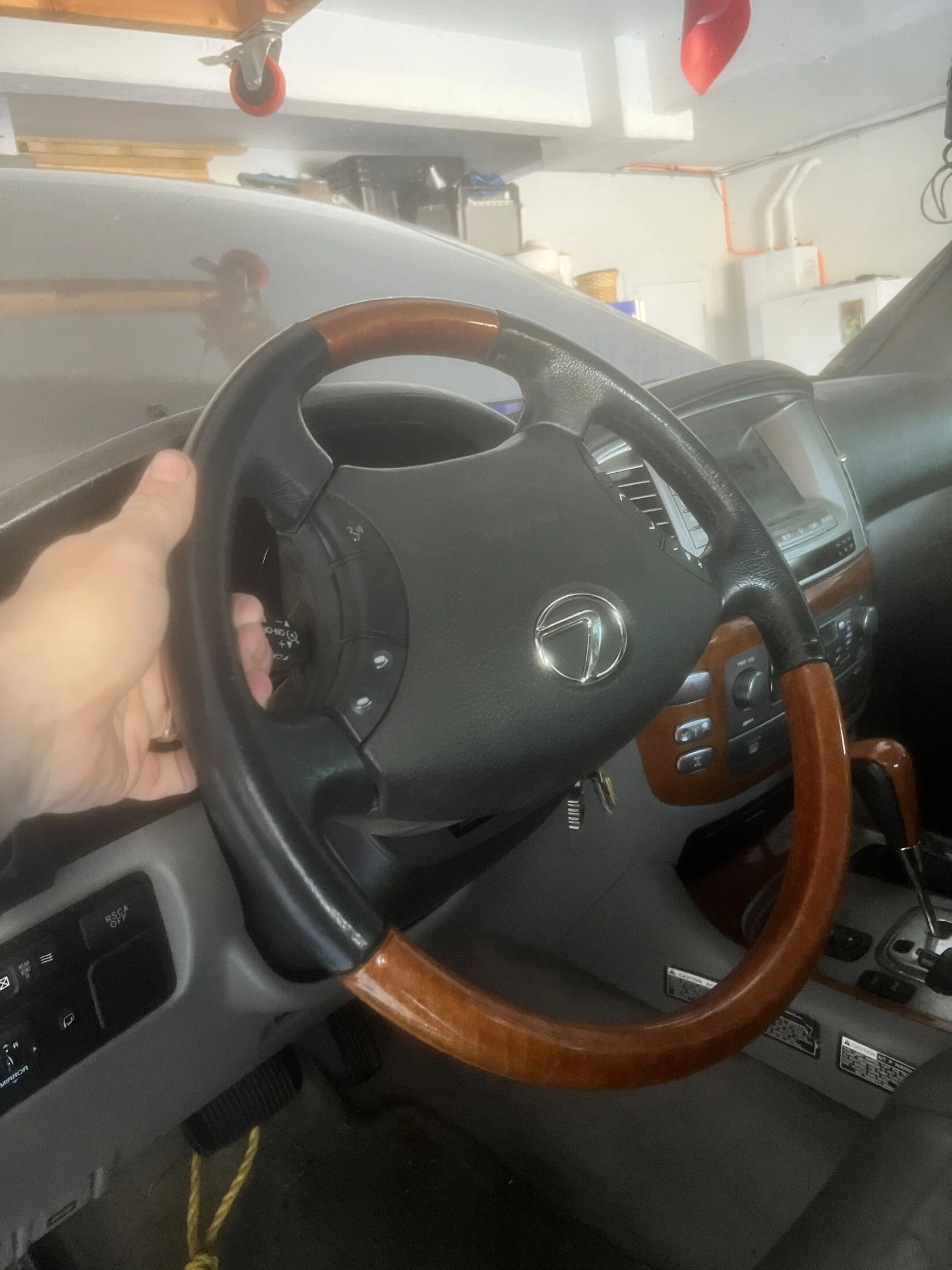

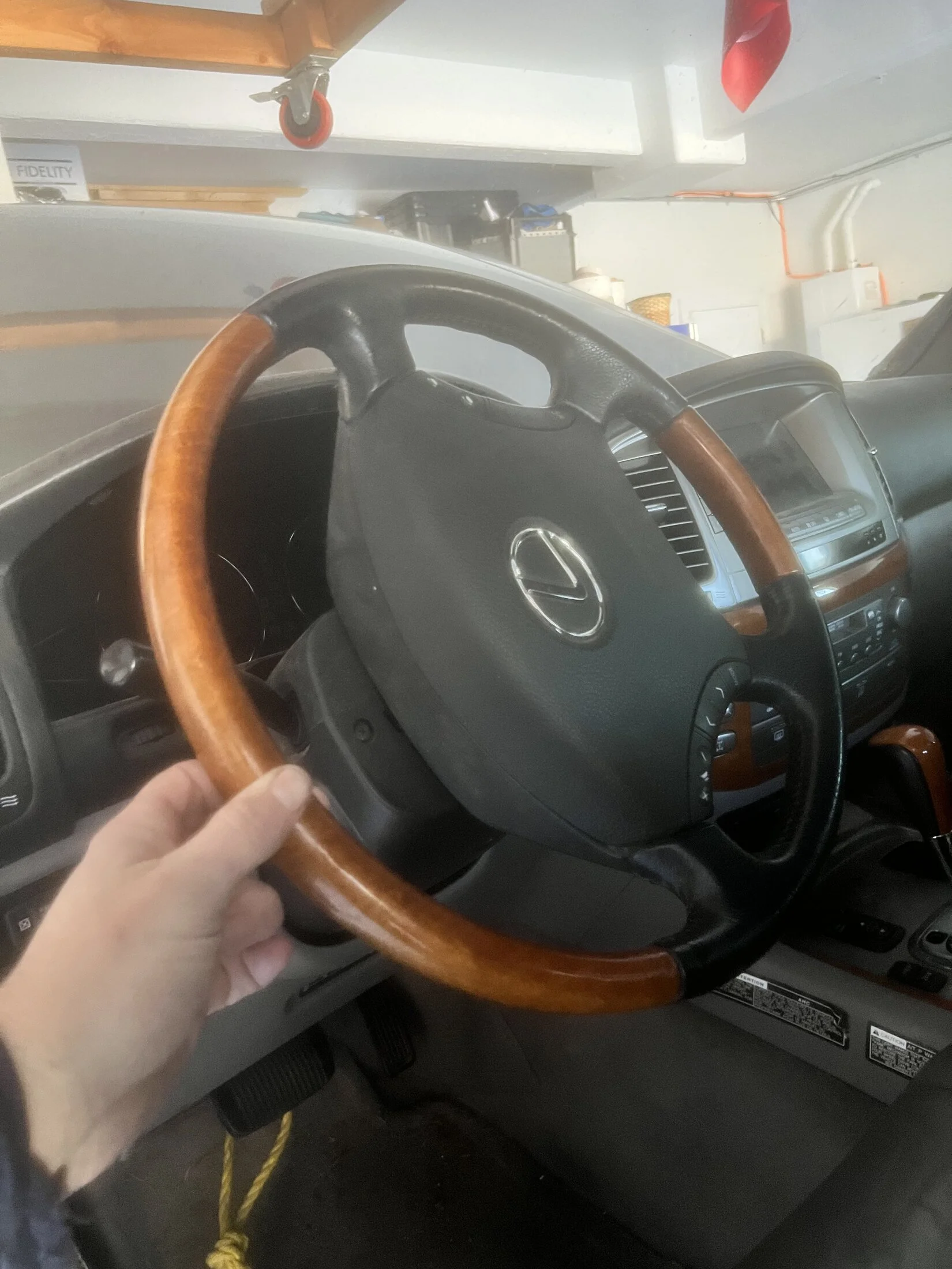

Just got done replacing LCA bushings #1 & 2 on both arms and replaced my steering rack. Both jobs not so fun but happy to be on the other side of it. All my front end is more or less buttoned up at this point and wanted to check the community’s feedback before I go any further.
I followed all the guidance to the best of my ability for steering rack FAQ page. After getting old rack out (steering wheel centered and held by a rope to the brake pedal) I measured the inner tie rod length end to end on both sides to make sure it matched the old one. I was able to get it out after a lot of cursing at the truck and cutting the stubborn PS return line without turning the wheel in any direction - so as far as I’m aware I took the thing out at center and put it back in at center.
Of course after the install it doesn’t seem to be center. I noticed it before I put my front end parts back on but thought there might be a possibility it was off due to things not being synched up. Well it’s still off and it definitely bothers me and am wondering if anyone has any best practices getting this thing back at center.
Where I’m most confused is that after I put my tires back on and with the steering wheel at center, they were only very slightly turned to the left - imo at a small enough degree that I figured outer tie rod Adjustments would sort it out no problem. But the issue as you can see from the pics is that my full turn left is limited and my full turn right I think is going farther than normal.
In summary - what’s not clear to me is how to approach this. Because if I go through the trouble and undoing the rack and getting the steering link back off I imagine the game plan would be to move a few splines counter clockwise and link it back up. But wouldn’t that screw my centering up pretty significantly? (Again with my wheel at dead center I was only slightly off to the left). Also how many splines we talking here? Anyway to verify that I’m on the money or at least close? Or is this all just adjustments and testing at the wheel? Lastly what’s the golden rule for verification for centering - is that a full left turn is equal to a full right turn?
Sorry for the 21 questions im definitely a bit out of my element here.

In your OP, showing steering wheel orientation Where is in different positions at each lock (knuckle stop). Dash lights are off, indicating engine off.
So start engine, drive making normal turns, LH & RH. Then stop and try again, while engine still idling.
With VGRS system. We need engine idling, to check steering wheel. We turn steering wheel lock to lock ( Knuckle Stop to Stop). If we get, ~ 2 1/3 turns lock to lock, this indicates VGRS is working. More, ~ 3+ turns, VGRS is off (in fail safe).
When engine off, and key turned off. VGRS locks in fail safe. Which is same gearing as non VGRS system steering. Where steering wheel turns more than 2 1/3 turns lock to lock. This is the same, as VGRS gears adjust gears too, during higher speeds driving. Where it takes more turns/input of/to steering wheel, to go from lock to lock. Steering wheel may or may not have been centered, as engine & IG key turn off.
When battery disconnected, then reconnected. VGRS light blinks, steering wheel may or may been off center. We drive ~21 MPH, VGRS light goes out. We then make normal turns ( i do figure 8's) and steering wheel centers. It's learning where, the center/zero is again.
In a properly aligned steering system. How far steering wheel turns from lock to lock and to what orientation. In a non VGRS, is based knuckle stops. In VGRS system engine idling. Is based on VGRS calibration and knuckle stops.
When we mechanically change, steering wheel position. ie, like during R&P R&R, TRE R&R or changing thread count of TRE.
Then if after a mechanical change, if steering wheel is off center. Alignment shops will need to set steering wheel to center, through tech stream! Any one with tech stream, can easily do this. But it is fastest, while on the alignment rack. Fastest, because when we know wheels are straight ahead. We may need to repeat a few times, when not on alignment rack. Until steering wheel where we want during straight driving.
Centerening the rack, is when rack out the same distance on each side of rack housing. We measure this, by length inner TREs out of rack housing, which are inner TRE are attached to rack. There is also color match marks on the pinion gear input shaft boot, of new OEM R&P. We line the match marks, when rack centered. This set rack & pinion, dead center. Now to center steering wheel. We need the splines (teeth) of #2 intermediate shaft. Fitted so it lines up with steering wheel level/centered.
If we're off by 1 spline, on the pinion input shafts splines to intermediate shafts spline by that one tooth (steering wheel not centered). Steering wheel will be off center, about 5 degrees from zero point. If the alignment TOE was off, before R&P R&R and we set thread count the same. Alignment is now likely off. In non VGRS, we reset pinion to intermediate shaft splines or pull steering wheel and reset by moving splines to level. In VGRS we can simple center in tech stream, SWEET!.
One of the biggest mistake alignment techs make, when setting toe of VGRS system. Is centering steering wheel, by holding it level, as they set toe. They may get, a very uneven thread count on TRE, doing this. They do not understand how VGRS works. What they must do. Is work to get thread count the near same (best practice), and ignore steering wheel until TOE correct. Then once mechanical alignment done (toe, caster & camber). The go into tech stream and center steering wheel.
