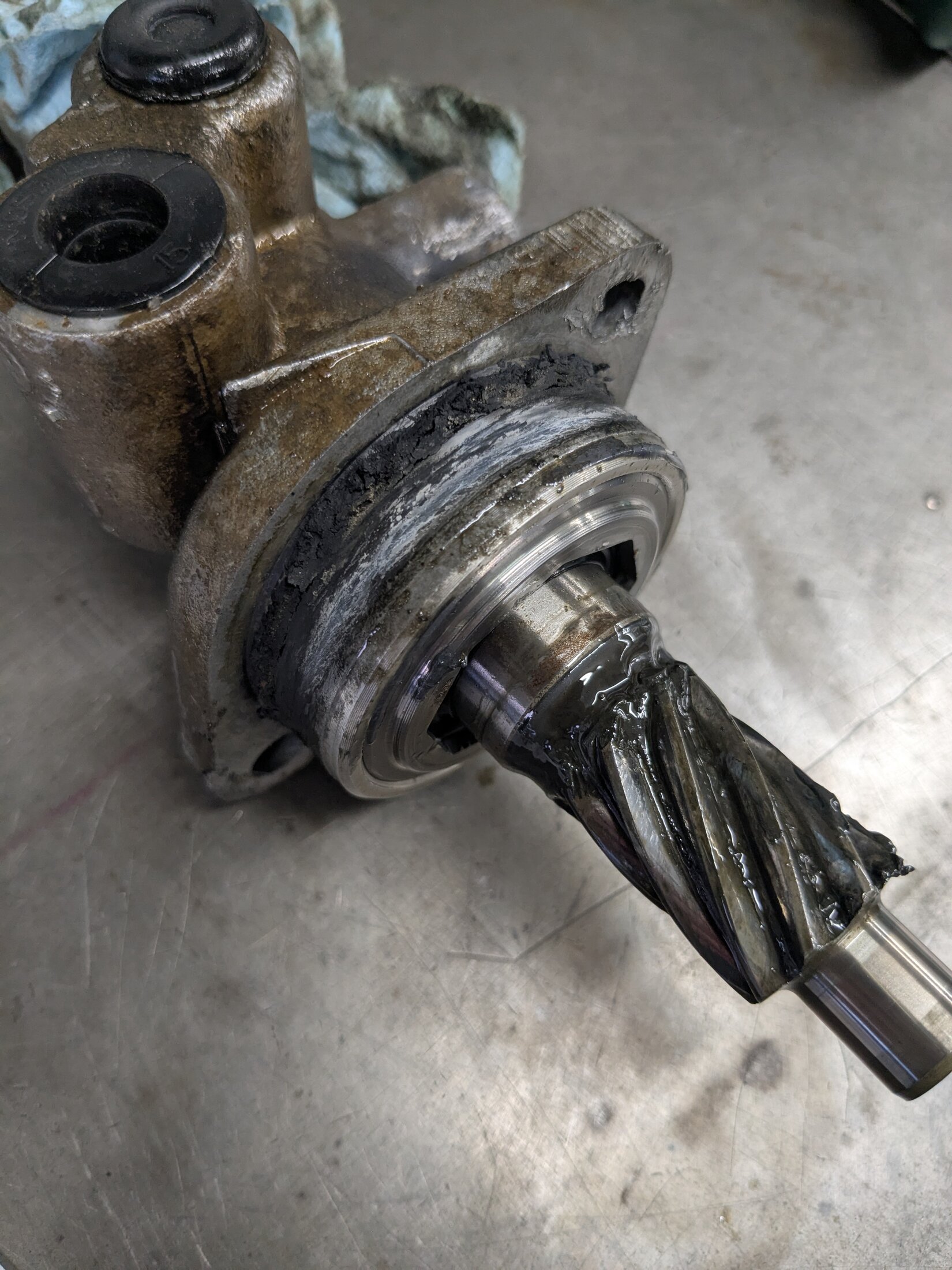

Next step was to unbolt and remove the pinion housing. That's all the instructions provided by Toyota. I'm sure that's how it works on a nearly new rack or one that lives in CA. However even though my truck is pretty good from a rust PoV the pinion housing was jammed solid. I finally got it out by quickly warming the rack housing up to 100C then rotating the housing fore and aft with plus gas sprayed intermittently into any crack. As the heat in equalised between rack and pinion housing it would become tight again and I'd have to wait for everything to cool and start again. I had to do three heat cycles to get it moving freely enough for the next step. This was the same but with the housing rotated 90deg so I could get the wife to apply a prybar under the flange whilst I wiggled, alternating from side to side to walk the housing up and out. Again this took three heat cycles as everything tightened up as the differential expansion effect wore off.

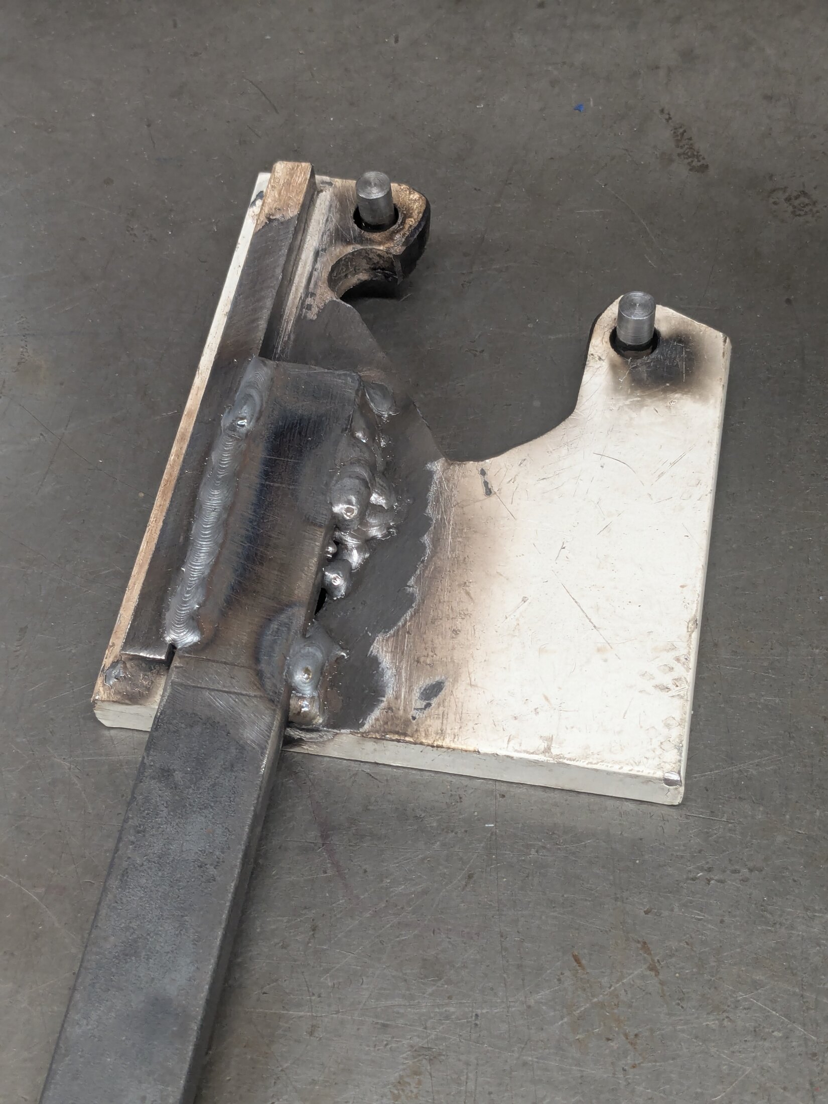

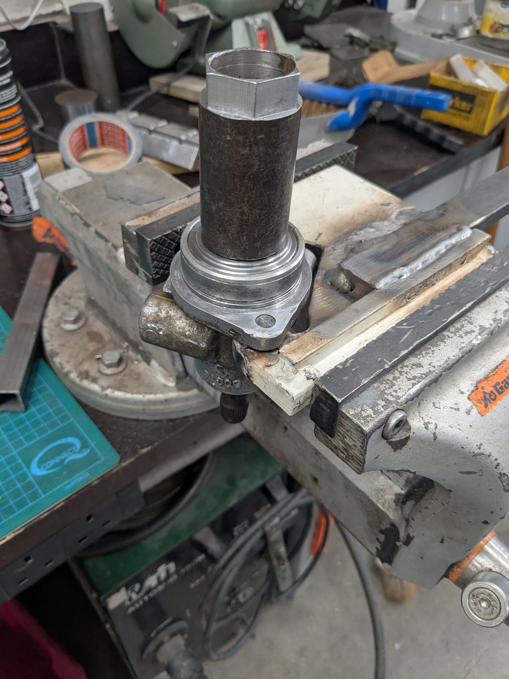

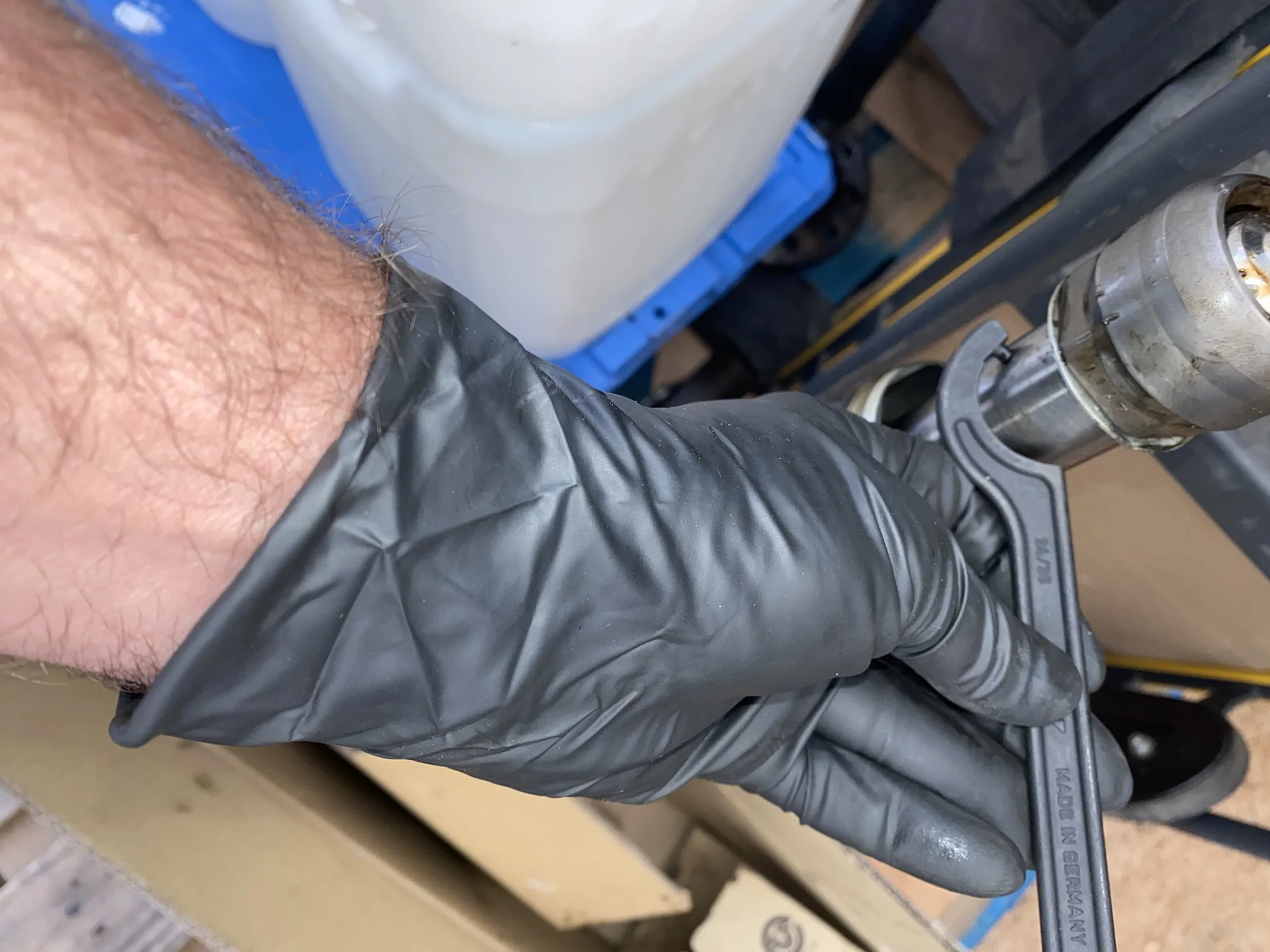

Hanging on to the pinion housing to rotate it was a challenge as there are no flats and plenty of features that you don't want to damage. I made a giant pin spanner from scraps around the garage. The pins are 8.5mm diameter (turned down from a 10mm bolt), welded into a 12mm chunk of steel that was hacked about to give clearance around the housing. I then welded a ~1m bar to it for leverage. It's not pretty, but it did work. It also made for a good work holding fixture for the next step.

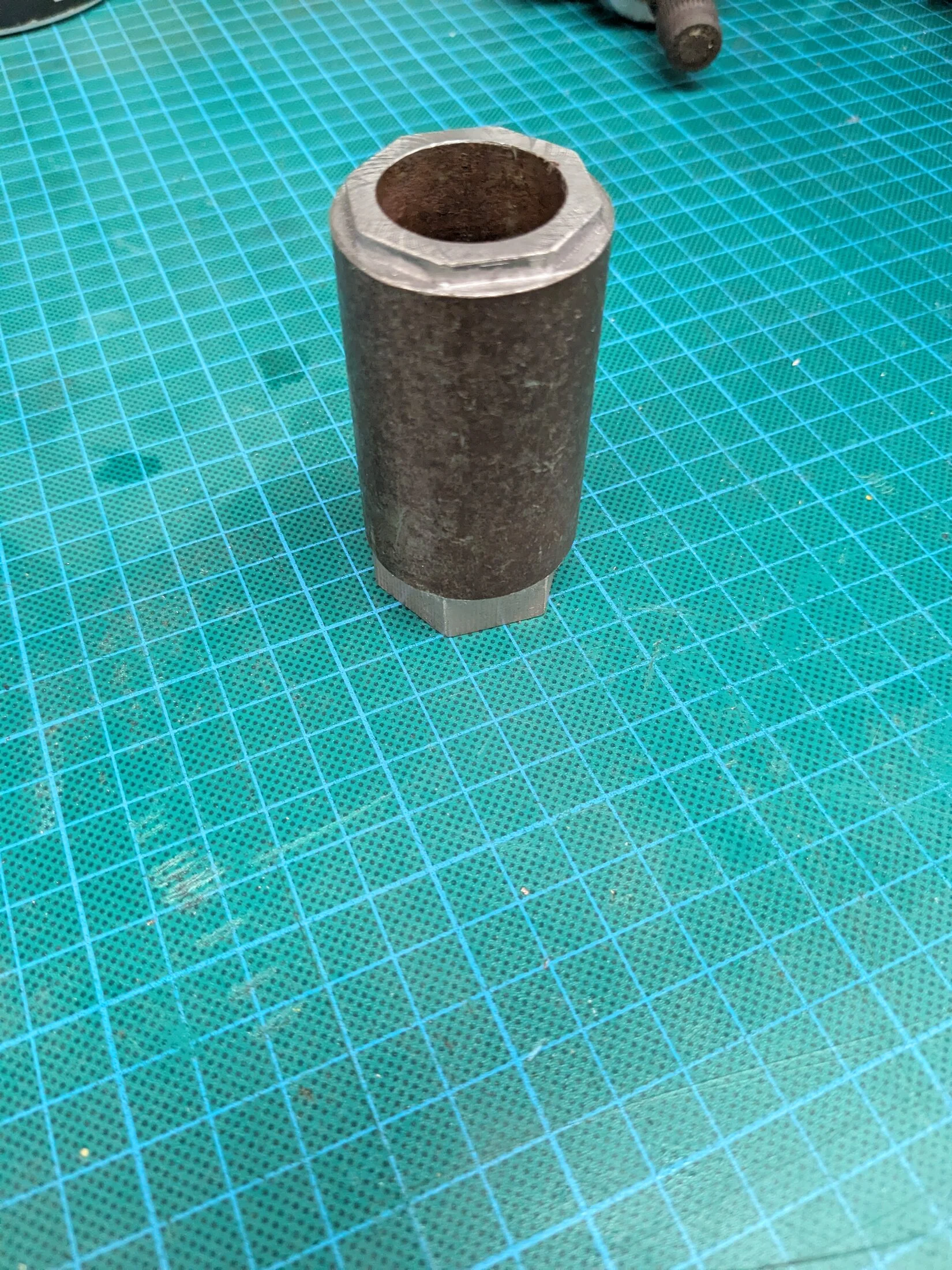

The pinion housing nut needs a special tool. It has to be hollow to clear the pinion, with a 32.5mm 8 sided 3mm deep 'nut' feature to engage with the internal form. I put a 32mm hex on the other end to grab with a socket. This worked a treat.

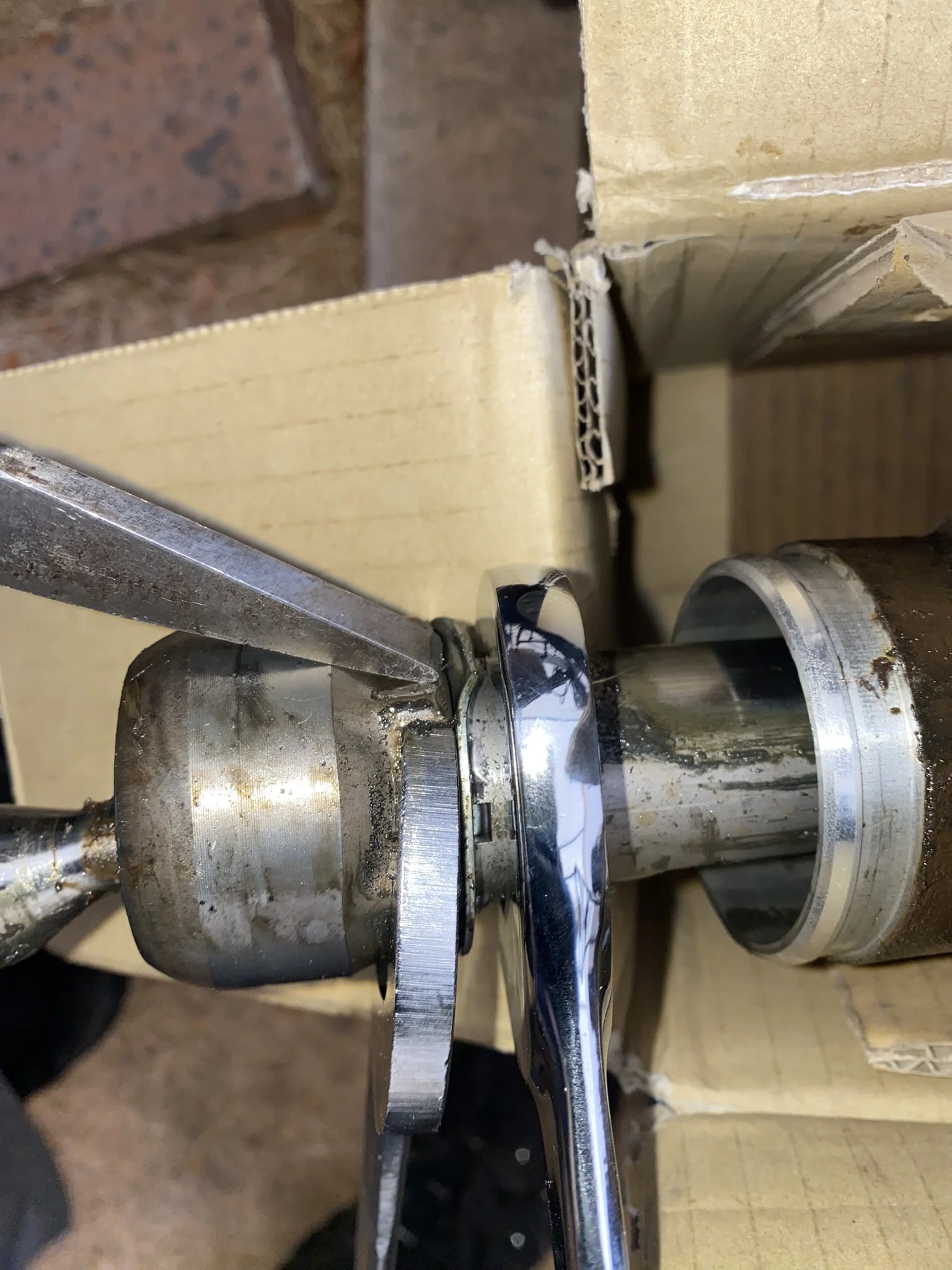

You'll also need a selection of specifically sized drifts to knock the oil seals out of and in to the pinion housing and rack body. The manual states to press the seals in and out. I did this for the pinion housing, but my press isn't tall enough for the rack housing. Tapping them out and back in with a hammer (carefully) worked fine. I made sure that all tools that went into the cylinder were smooth and burr free to avoid scratches, aluminium where possible and a coating of ATF doesn't hurt either. There's a special tool called out in the instructions for pushing the seals over the rack ends. I just taped up the ends of the rack with electrical tape - there's a taper onto the main part of the shaft, so the tape just protects the seal from the sharp bits at each end and doesn't increase the effect OD and risk stretching the seal.

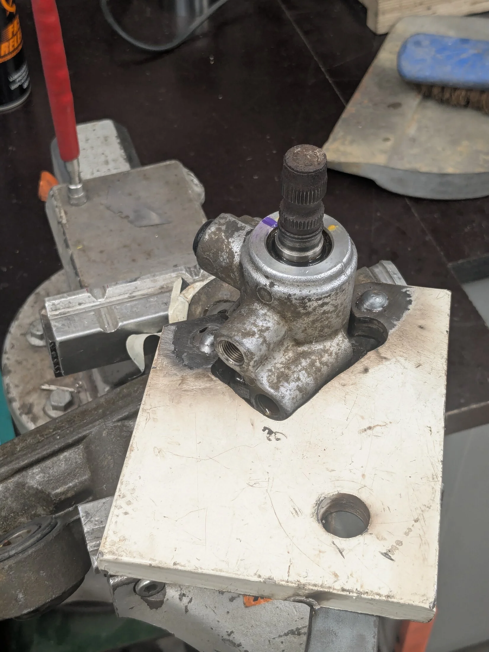

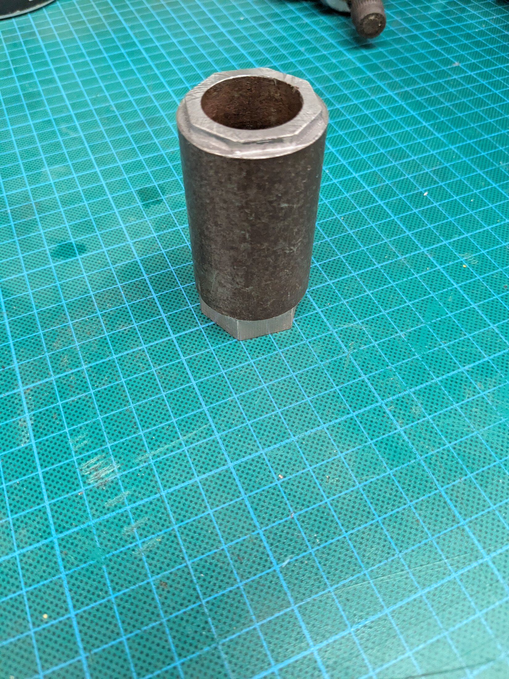

Great write up! I did this job when I had my engine out - I 3D printed a tool to get that octagon pinion housing nut off & it worked really well. My truck was 100% rust free though, so that likely helped! Did you have to put much force on yours?
The octagon nut wasn't too bad as it's protected from the elements. It was just the pinion housing that was a nightmare.

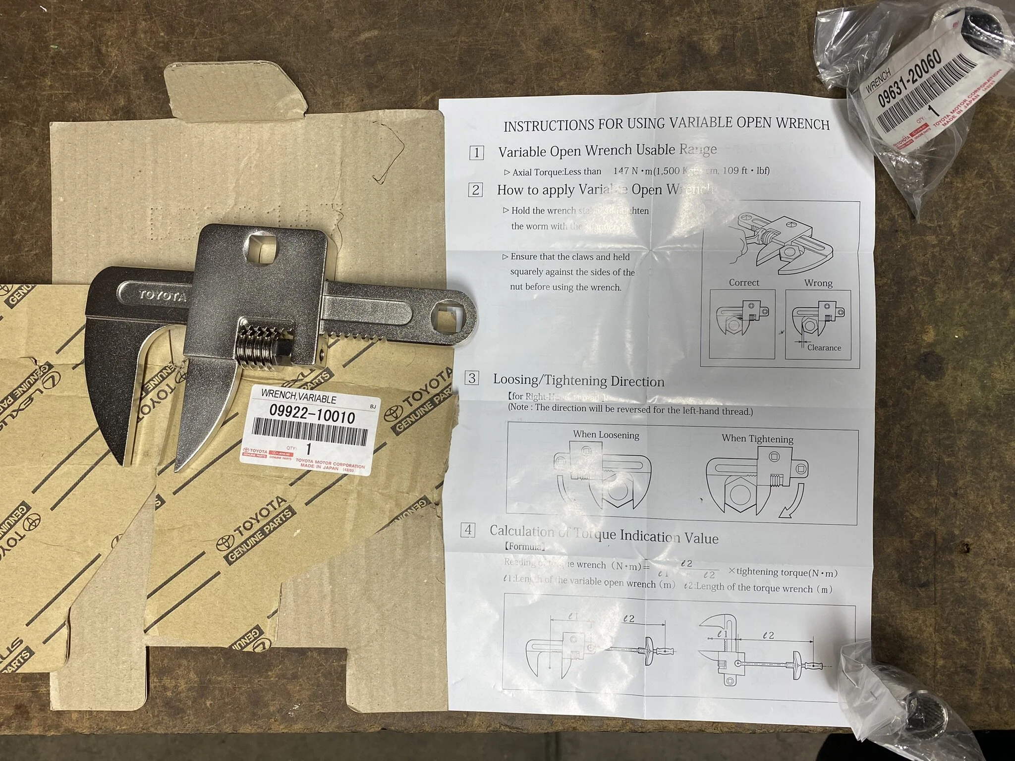

The 'variable open wrench' (09922-10010)
comes up quite a bit in the jobs I've done so far. It's £106 from Amayama, probably £150 by the time it's delivered though.

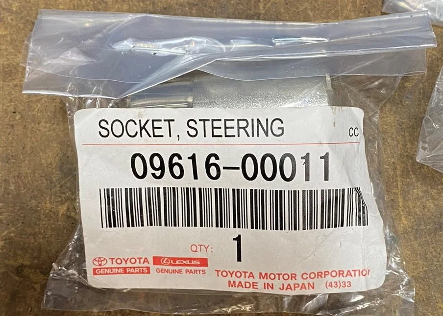

What's 0961600011 used for? I can't see it through the bag!

It does. I like that it has 10mm nut on span drive, to really bear down. Also it has also two 3/8" drive socket, useful for torque wrench. But, I use the forged wrenches more than it. Which they're better at breaker taught threads lose.

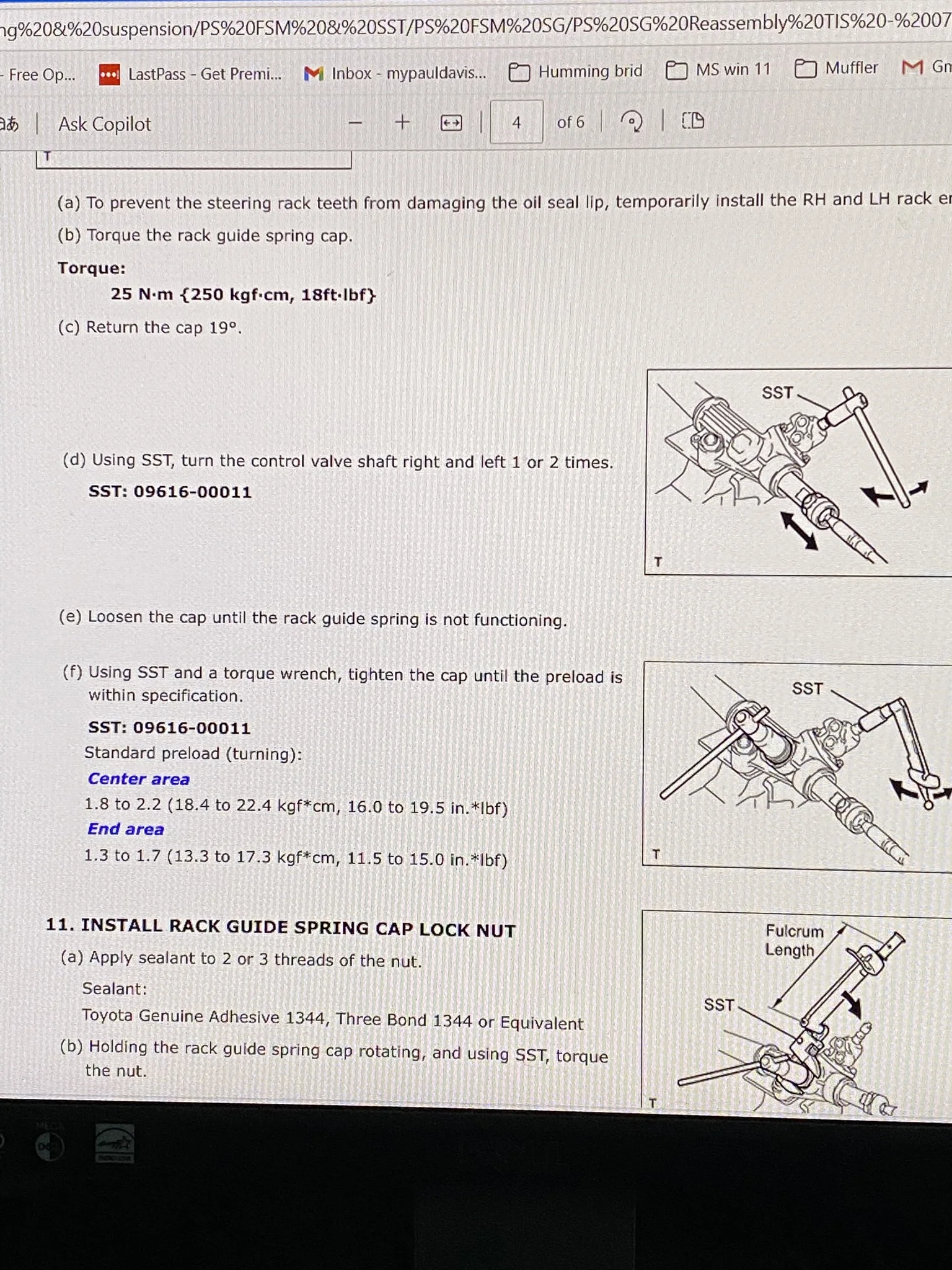

Setting pinion preload. Fits over input shaft.

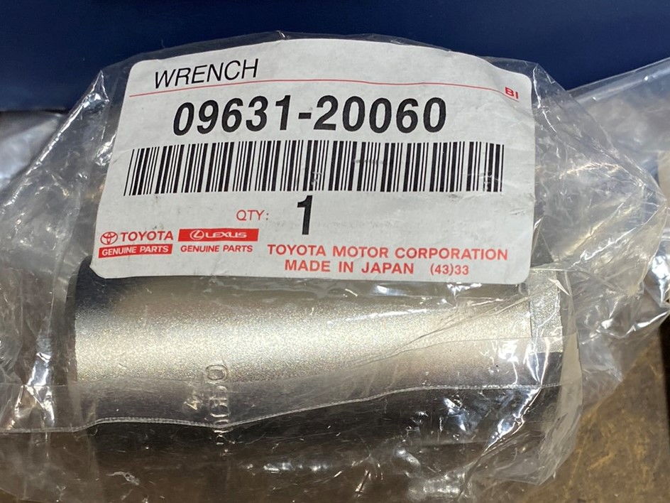

09631-20060 is seemingly NLA - the octagon drive.
I did wonder if the one in the packet was the preload socket. I reset preload to the original location and then checked and adjusted in the car by feel. I made a shallow 56mm socket for that job a few years ago, not sure it works on LHD though.
Because we were talking about it I had a look for the variable open wrench yesterday and found a used one on ebay for £47, looked in decent shape in the photos, so got that bought. I had bought a cheap aluminium version a while ago, but it was rubbish, keft deforming at low torque and I finally exploded the jaw trying to loosen the pinion housing!
