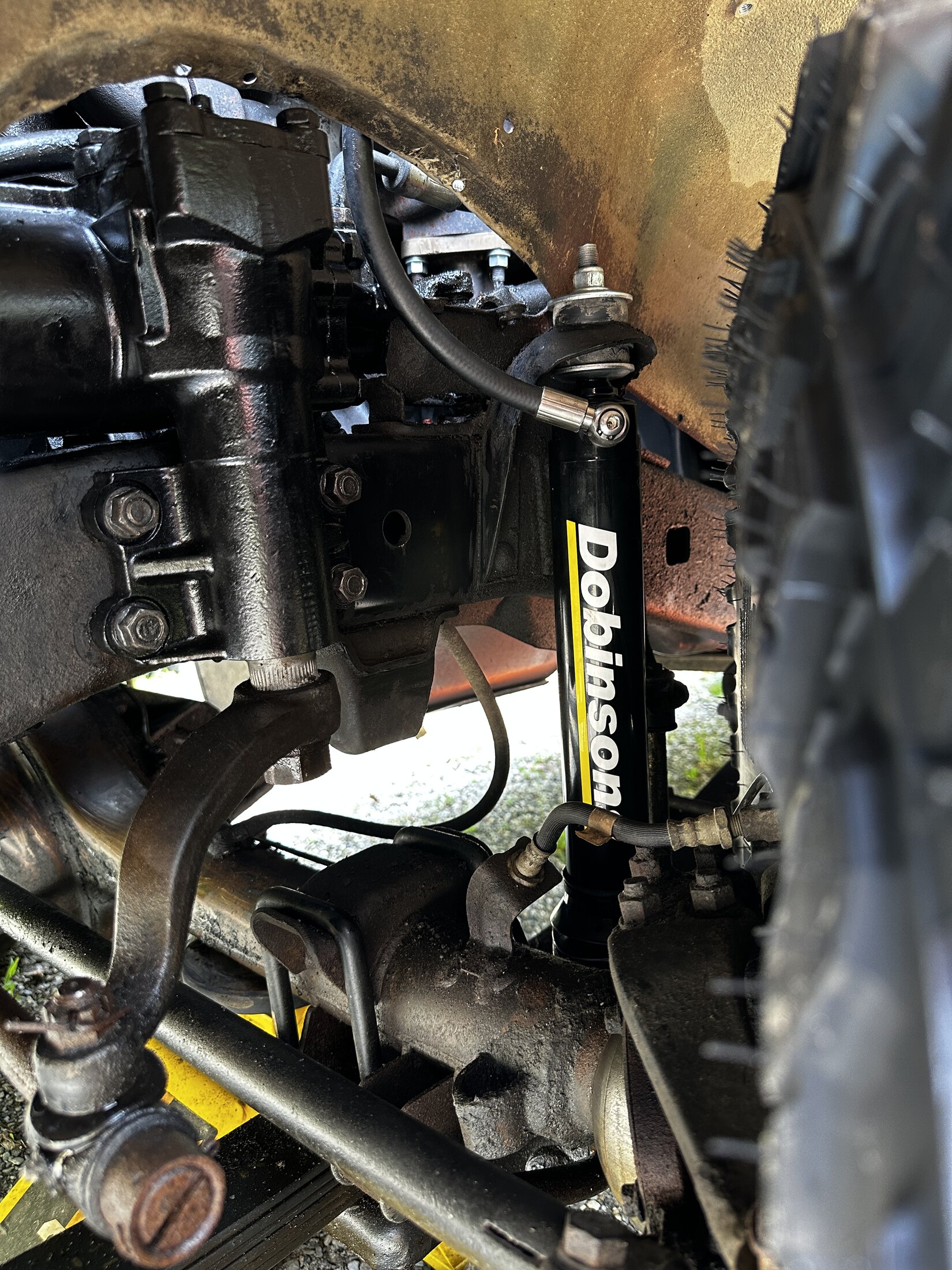

Thanks for the correction. Someone must have updated my old box then at some point during its life as I was able to bolt on the pitman arm I had. Or, they updated the arm. Can you tell from my picture above?
Cheers, James
