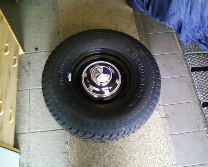

This is a non-USDM split rim center that was removed and welded onto a large ID 16x7 wheel "barrel". With 3.25 B.S. this wheel will fit both my 80 and my 40.I
from wich rim did you take the barrel? I wanted to use the white 6x16" Toyota rim, but the center of the split rim would be to small to be welded in that barrel....
Looks great, just what I want...
by the way, you can use your clips with the 16" split rim center and the hubcabs too...

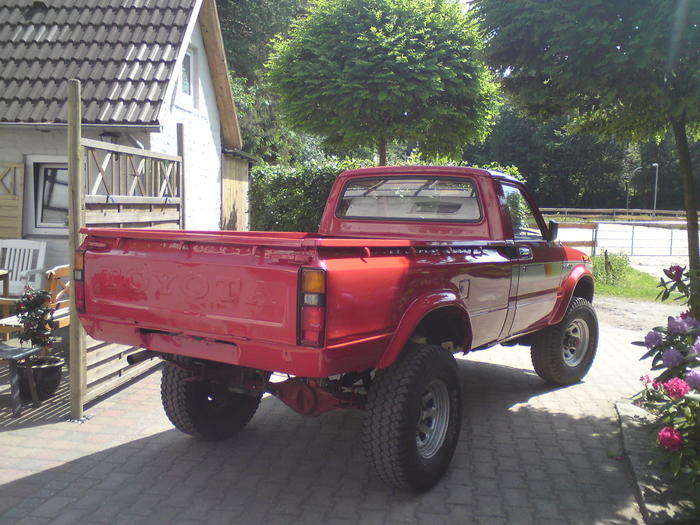

they are for my new daily driver, a ´81 Hi-Lux in almost new condition: (picture from the previous owner)
( I know we are lucky :D)
I want to fit the hub cab rims and got some in 15" without the clips. (the 16" are discontinued since last year and I din´t find any used ones..)
Got a few clips from SOR and try to rebuild them now...
still I would like 16" rims better and I would prefer non split rims...

Hi soenke, great looking pick-up was it restored ?? I see a little overspray on the axle casing.. very clean and from 81 - do you have the road tax break on cars older than 25 years ?
So why 16" but not split rims (factory) I thought as a overlander you would appriciate their simplicity :)
