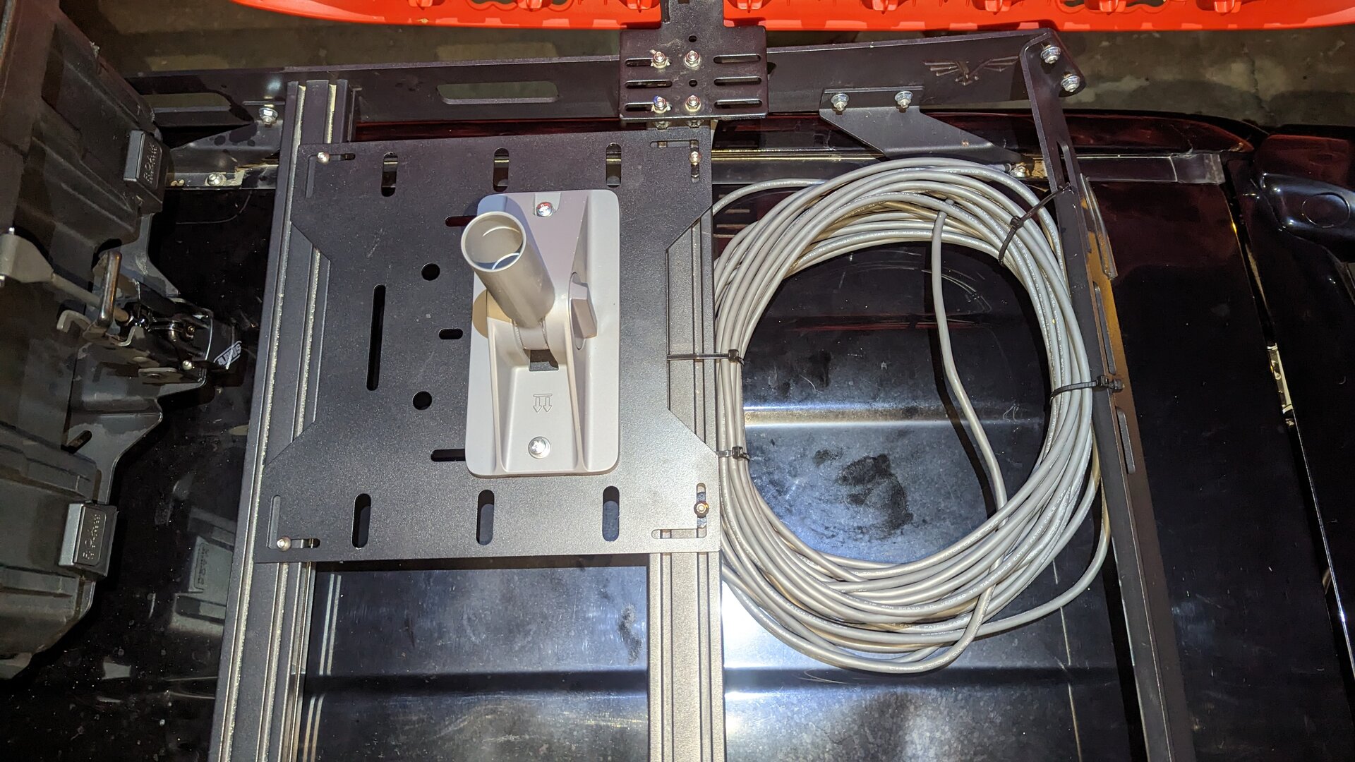

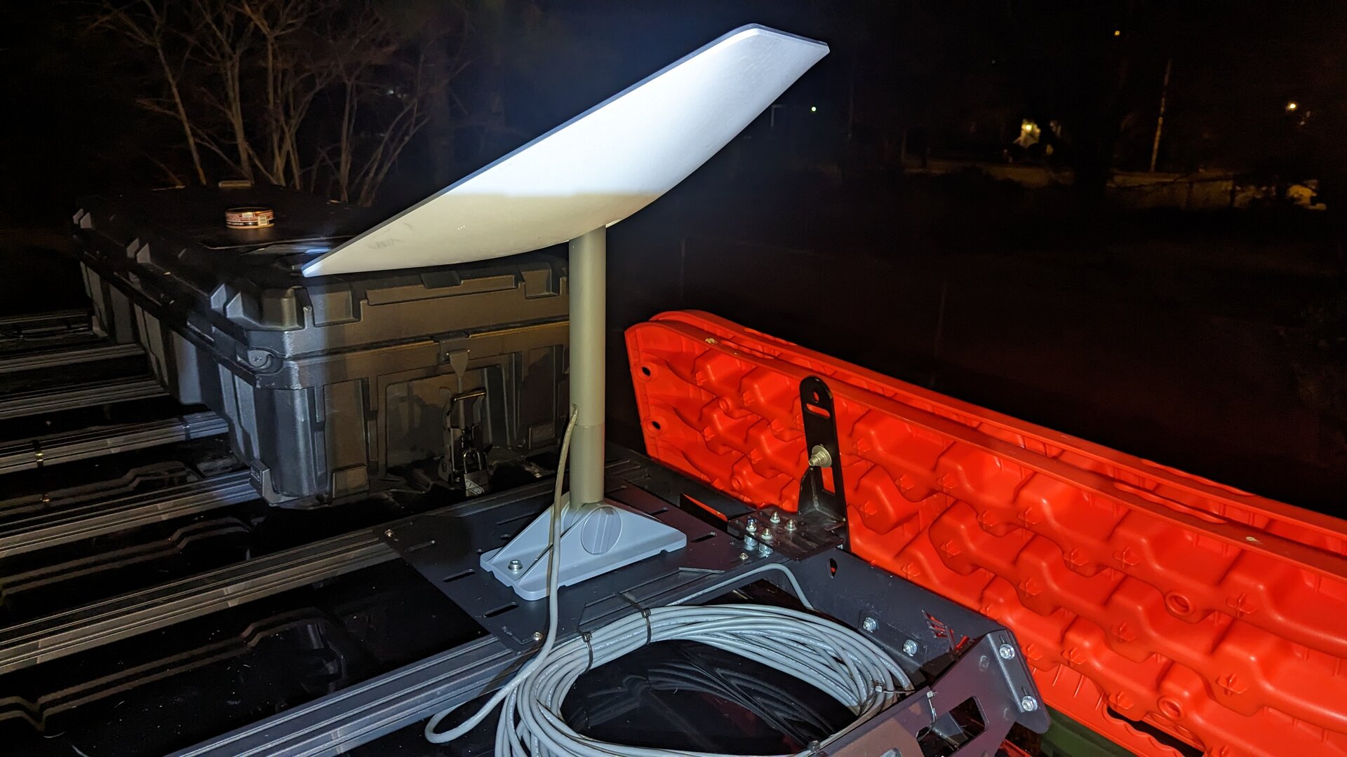

Ok, so I guess I am at a loss.
I am trying to come up with a way to route the cable for my Starlink from the roof of my 2006LC to the rear of the cabin.
Originally I was just going to run it through the rear window as pictured below but when it rained water ran down the cable and leaked into the back of my truck, it doesn't seal tight enough.
The Starlink cable has proprietary ends om them that are prohibitive of routing it through the top half of the tailgate where the center brake light is, I'm not even sure that would be possible anyways.
I really, really do not want to drill through my roof, does anyone have any ideas?
I included some pics to show current set up and to see exactly what I'm working with.

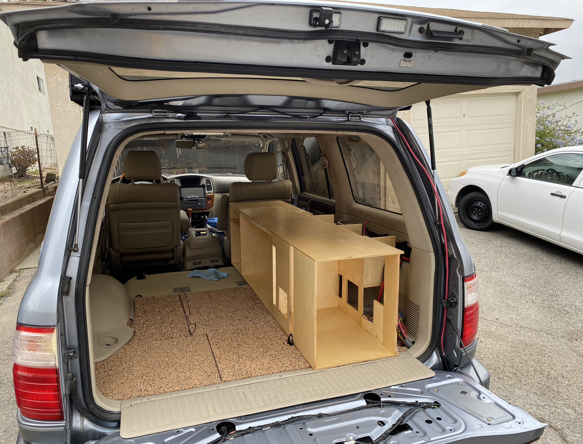

I routed the cables for my solar panels down the right side of the rear hatch and then underneath. There’s a plastic access plug there that leads into the rear of the vehicle if you pull the interior panels. Here’s a pic of the work in progress, the cables got fixed in place using cable ties with adhesive mounts. You can see the cables coming into the interior through a notch I cut into the plastic interior panel. Hope this helps.
Ran a larger set of solar cables in exactly the same way. This works pretty well, and there's enough space for a few of those stick-on zip tie holders if you really want to make sure it does not move.
Man I spent a solid 30 minutes looking under my truck trying to figure out how you got that into the cabin.
Its possible I POR15ed over the plug, but I can't find it to save my life, can you please take a pic for me?
Mine is 2006LC , I think yours is LX from the wood trim is it possible I don't have one?
EDIT: Never mind I found it, unfortunately, it's not going to work for me, the way I have my drawers installed plus carpet, plus a layer of killmat it would take me all weekend to run that, plus the cable is exposed under the carriage and I already smash the s*** out of my rear bumper all the time .

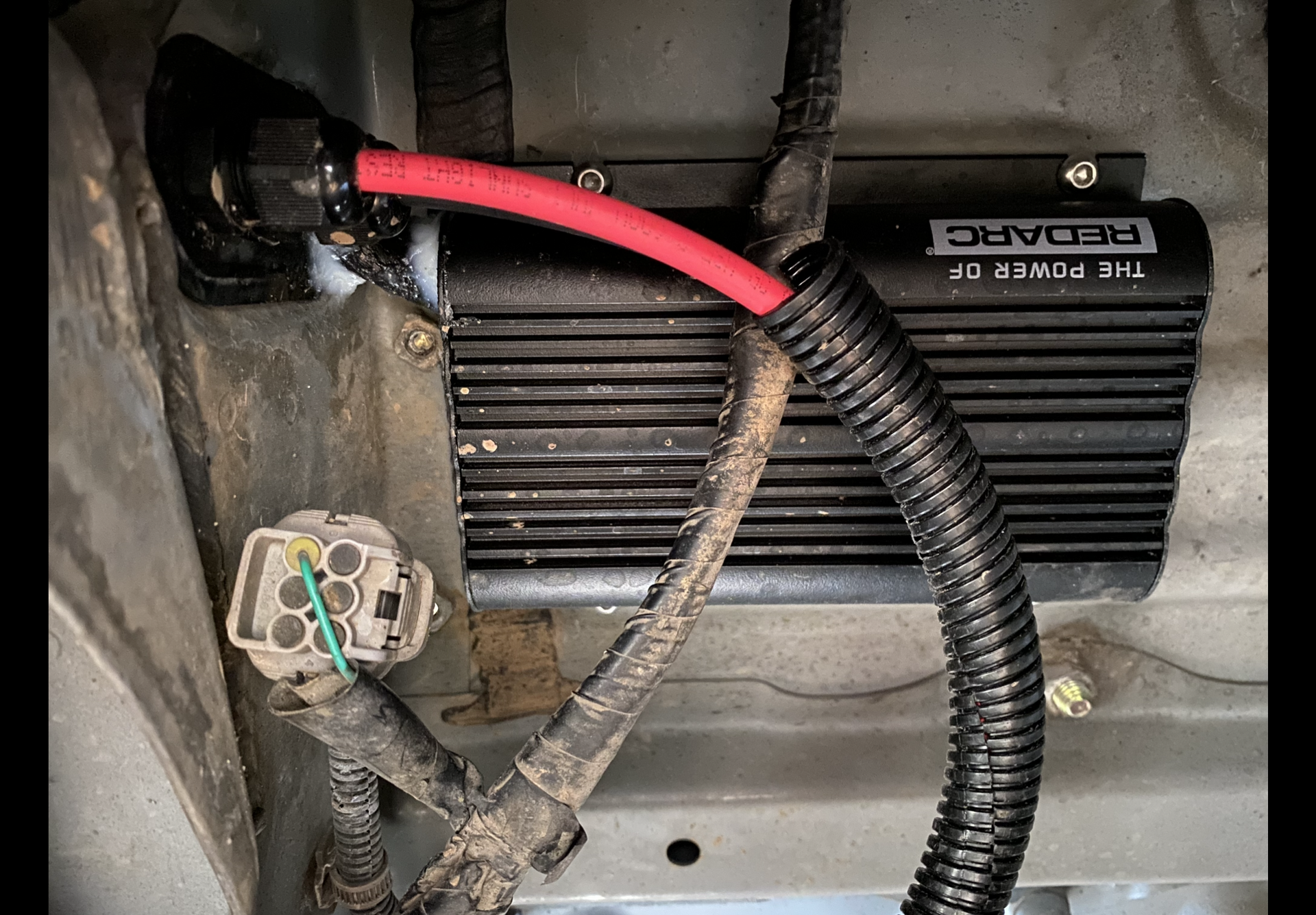

The plug is mounted into a vertical surface as you look towards the rear of the vehicle from underneath. It’s about 3.5 inches high by 2 inches wide. Here’s a pic looking straight up at a redarc converter that’s mounted upside down under the rig
. The cables run into two cable glands that are mounted into the plastic plug

View attachment 3221660View attachment 3221661View attachment 3221662View attachment 3221663View attachment 3221664
Do you leave your antenna up when in motion? How do you like that antenna bracket, is it the one for home installations?
The plug is mounted into a vertical surface as you look towards the rear of the vehicle from underneath. It’s about 3.5 inches high by 2 inches wide. Here’s a pic looking straight up at a redarc converter that’s mounted upside down under the rigView attachment 3225742. The cables run into two cable glands that are mounted into the plastic plug
I think one can cut the connectors and convert it to CAT6e and use a passthrough connector.
I'll upload some pics when I am done, no I won't be leaving it up, too much wind and its not exactly waterproof.

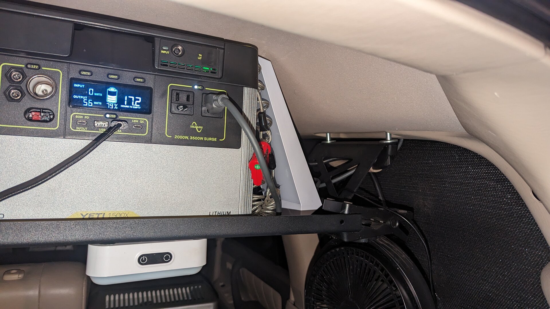

Either way, I found a way to route it through the upper part of the hatch and the back, I'm powering it with a goal zero 1500 with car link.
