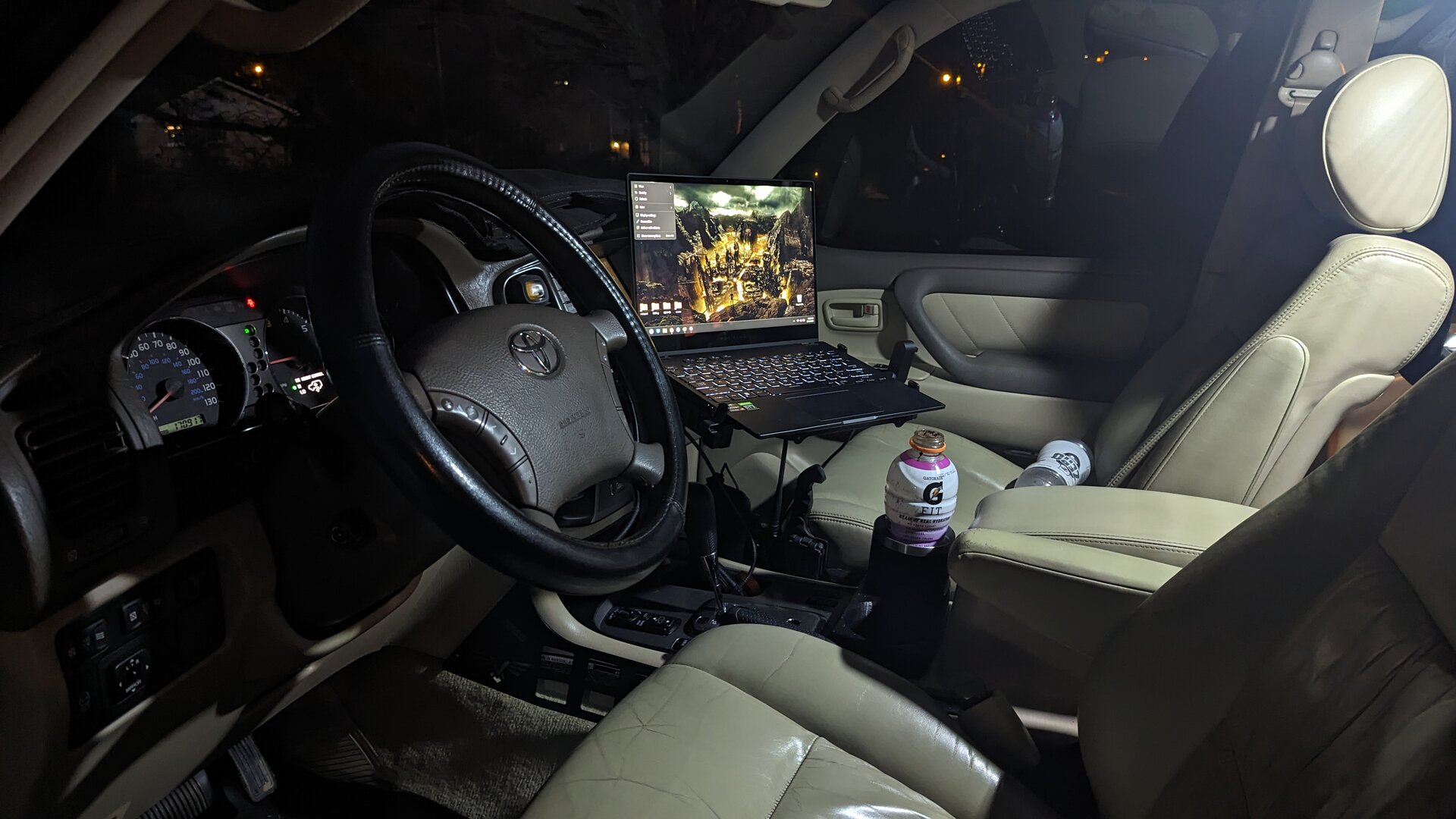

So for now I am mostly done and this is probably my last big project before I hit the road full time.
Mobile satellite internet.
At high speeds or particularly bad weather I'll still have to store the dish. I'm looking at mounting it flat permanently, but that's a pretty involved and possibly expensive job.
