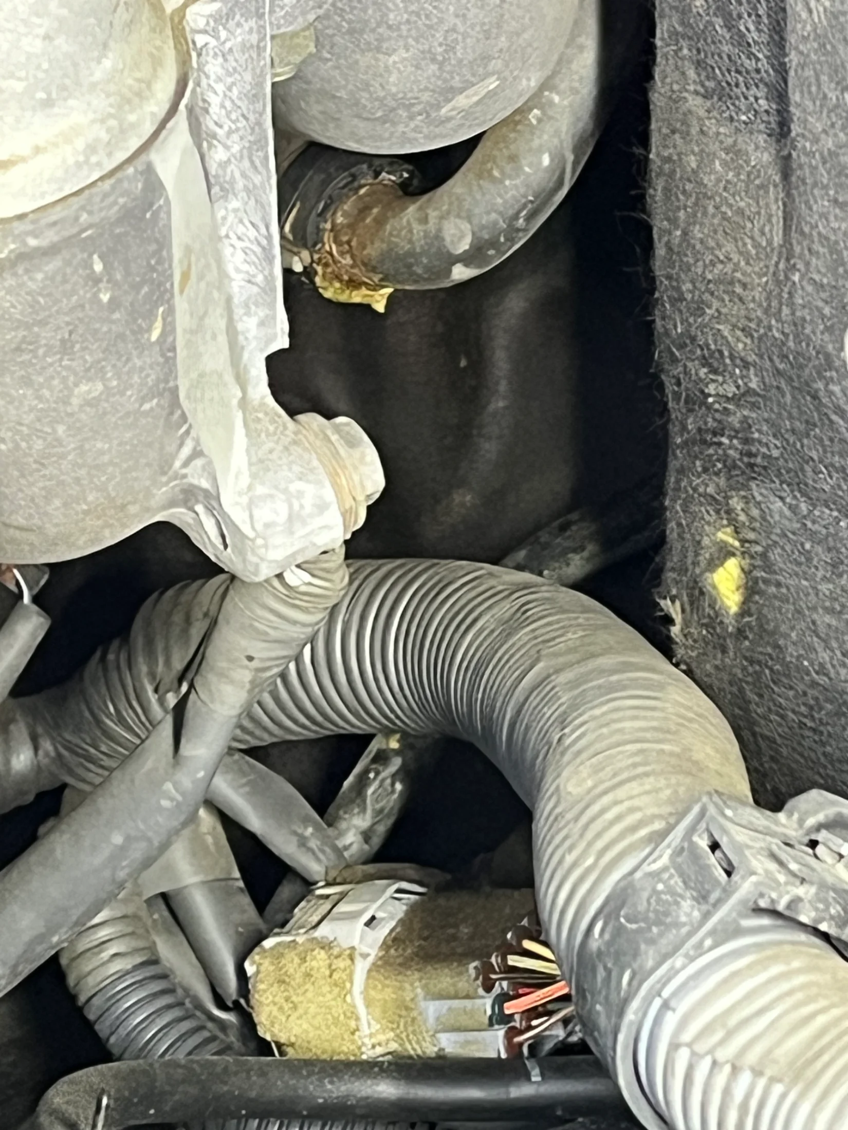

Recently my tranny has been acting weird from P to D. The tranny would feel hesitant, but still go. After a day or two like that, I got stuck after a full stop on an incline and revving up wouldn’t take me anywhere. I’ve done quite some research and experiment and this is what I found out:
-The truck seems to be starting in second gear. The L gear (with TC in High) works perfectly well. I have been using this for now to reach 15 kmph and then shift it smoothly to D. After that the tranny acts completely normal.
-ATF looks nice and red. Full and no leaks. All the other gears work fine, including with the TC in low. R as well. RPM are the same for every gear compared to before.
-No grinding noise etc. I have checked the linkage and seems ok. Makes me think this must be electronic. I know of the solenoids/cable up the throttle body/connectors to be potential suspects and I’m wondering if I found the culprit as per below:

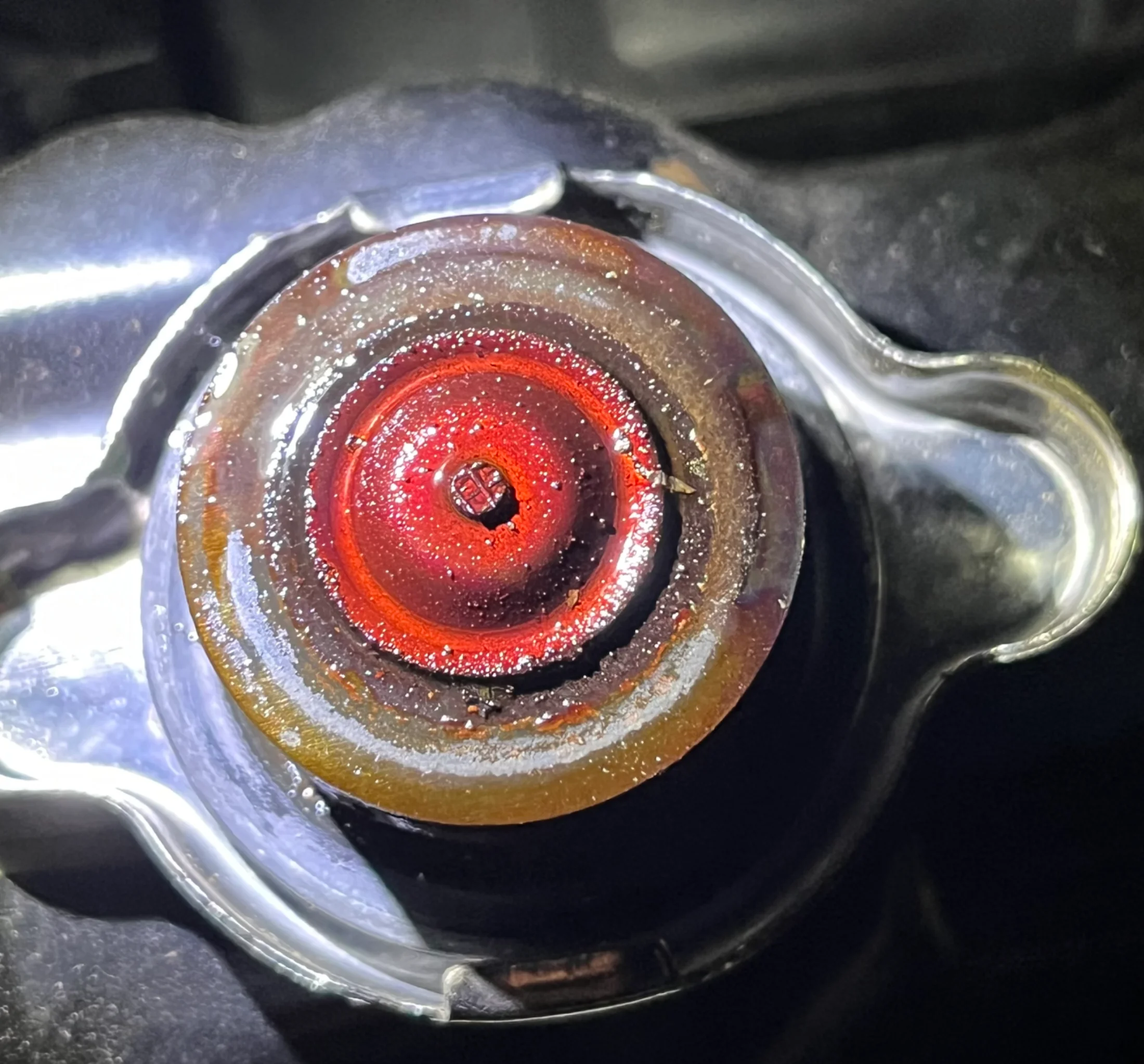

As you can see I have a PHH leak and my coolant is a bit contaminated, Radiator cap is corroded, coolant still green but with some
yellow flakes particularly in the overflow tank from the corrosion related to the PHH I think or plastic degradation (need to fix PHH and flush and see if that fixes, it’s been like this for a little while).
I have heard of the neutral safety switch that could be the culprit as well, is this what is on this picture? It looks like coolant has been dripping on these cables on the pictures below, I wonder if that could be the issue instead of the notorious solenoids. Any help appreciated !

What you have pictured is the engine to tranmission connector housing. The NSS is on the side of the transmission case. It has a shift rod and wiring connector on it.
Gotcha! I’ll have a look. It looks like that housing could have gotten moisture in and I’m wondering if that would be the cause.
It acts perfectly fine in Reverse, doesn’t feel any different. as well as in any other gears. Just tranny doesn’t want to start in first gear while in D.
The reason I asked was to differentite between a mechanical and an electrical/electronic control problem. Reverse and 1st share the same gears, mostly, so if reverse was also a problem it's most likely mechanical. Since your answer is no, you are most likely looking at an electrical/electronic control problem, as you guessed.
That connector housing contains the NSS wiring. It's EC1 on the EWD, for reference. I've seen these get really badly corroded when the PHH leaks, because it sprays directly onto this connector housing and the EC2 connector housing, immediately adjacent to it. At best, this is the reason most people lose the PRND2L lights on the combo meter. At worst, you go nowhere.
Pull it apart, if you can (it's a real pain the starter installed) and check the condition of the terminals. I've seen some connector housings full of green crud and still working (somewhat). You want it "operating theater clean" in there.
If it's nasty in there, pull the starter and de–pin the terminals, one at a time. This will allow you to clean them throughly and your problem (if this is it) will be solved. If they're just a little dull, but not covered in green corrosion sparkles, try spraying them with Deoxit.

Thought I’d give an update to help anyone with this happening. In the end it was the main transmission elec connector, one the pin was corroded. An auto tranny shop had a look as I didn’t want a random mechanic to start touching everything and not find and a couple of hundreds later it was fixed. Solenoids were fine. Frothing on the D for drive!
