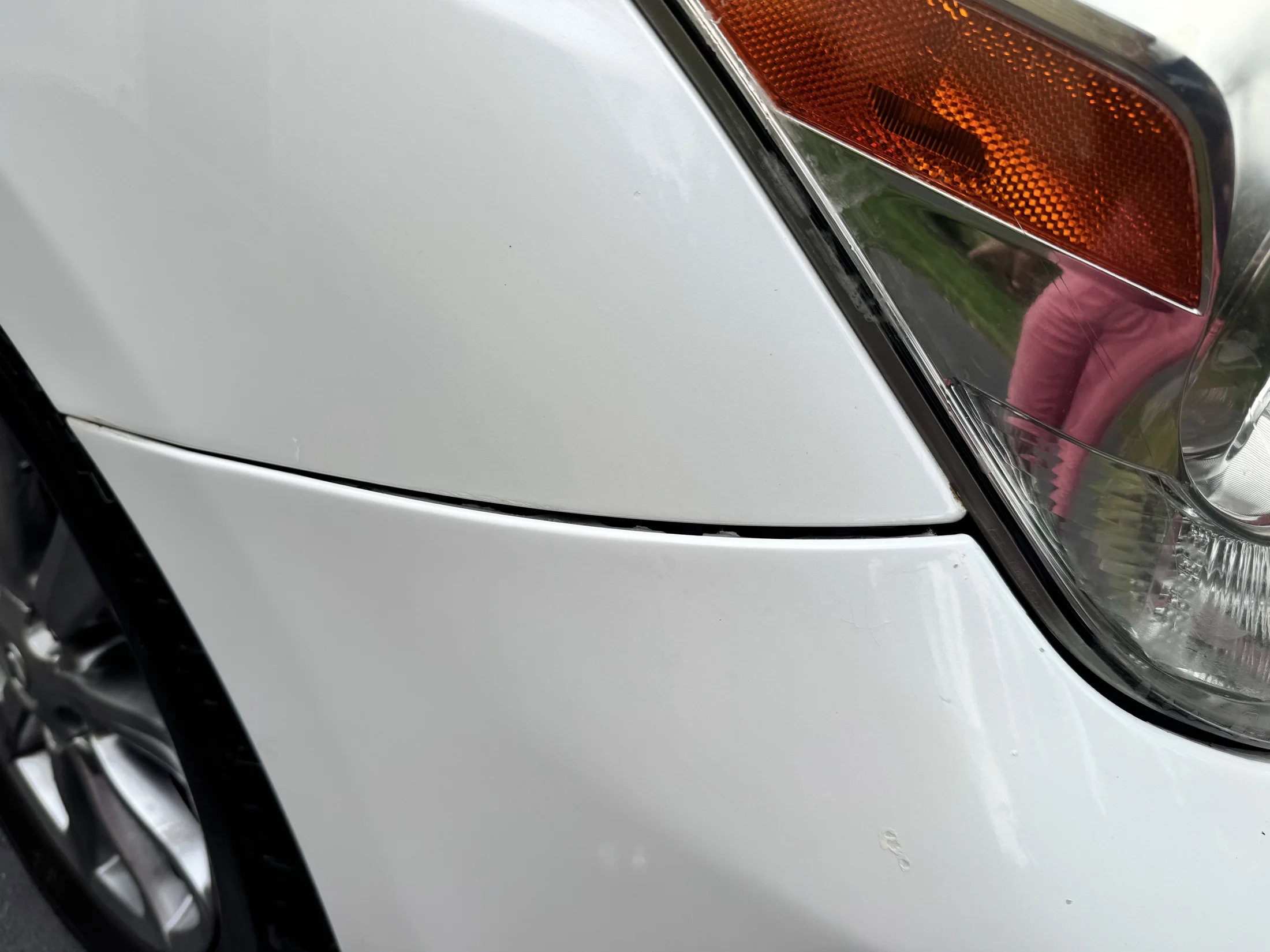

1. What is the part no or bracket high holds this gap of bumper in place? (See pic)View attachment 3971498
The bracket is probably fine but the detents molded into the bumper skin rounded off. Many of us have this issue.
The next time I have my bumper skin off I intend to see what I can do to reinforce or space out the detent molds.. but I'm not looking for excuses to remove it, so it'll be a while.

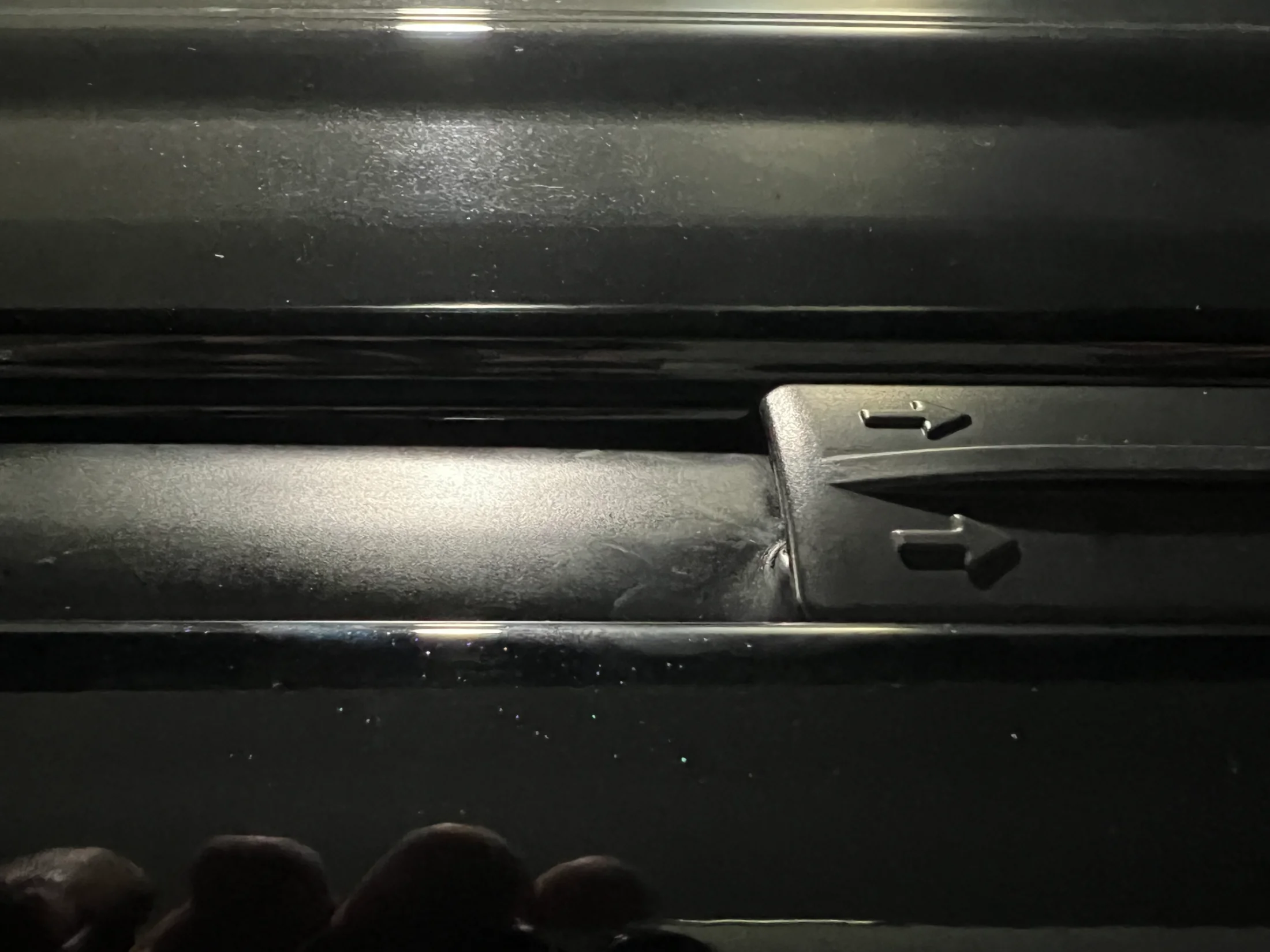

I had these rubber roof inserts replaced when I bought the truck. Looks like the tech put one of them in crooked.
What’s the best way to get it back out? Does the plastic piece with the arrows on it pop off?
Move the plastic piece in the direction of the arrows and the visible end will lift up.
If you’re removing the rubber trim clean the area under it and the bottom of the trim itself with a wet rag. The broken down pollen and leaves and stuff will act like lubricant to let the trim come out somewhere on the freeway.
Also when you get it out, if you look closely there is a metal strip molded into each one. This part has memory and if the trim is too curved it acts like a spring helping it all come out at random. You can pre-bend the whole thing to be straight or even bent upwards a bit at the ends.. this will help it all stay in place.
Thanks for the tips. I have lost many at automatic car washes.

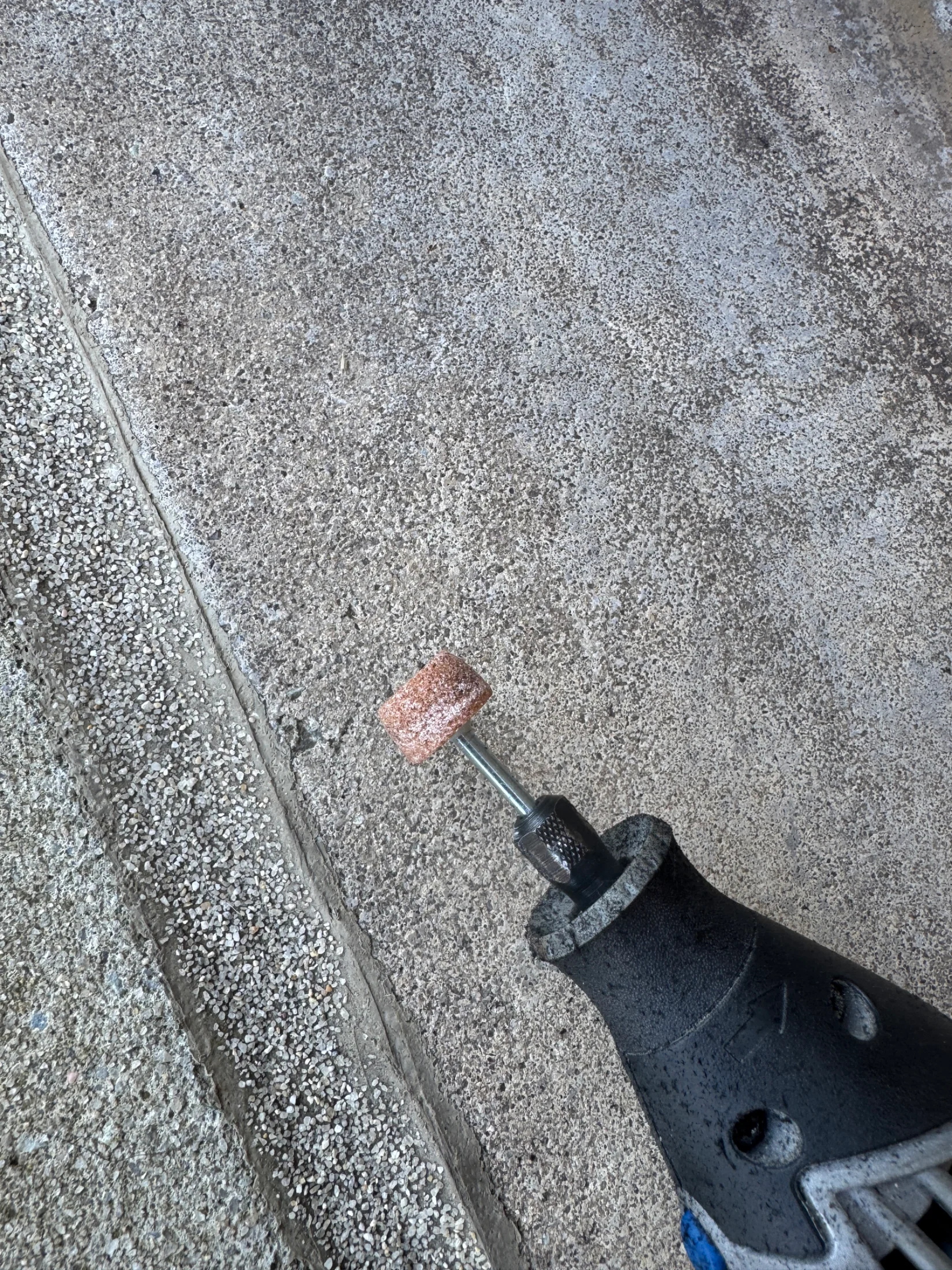

Following up, the nail clippers knocked down the spikes for sure, but I ended up using a dremel afterwards to smooth out the “nubs” that were left. Attachment I used pic below:

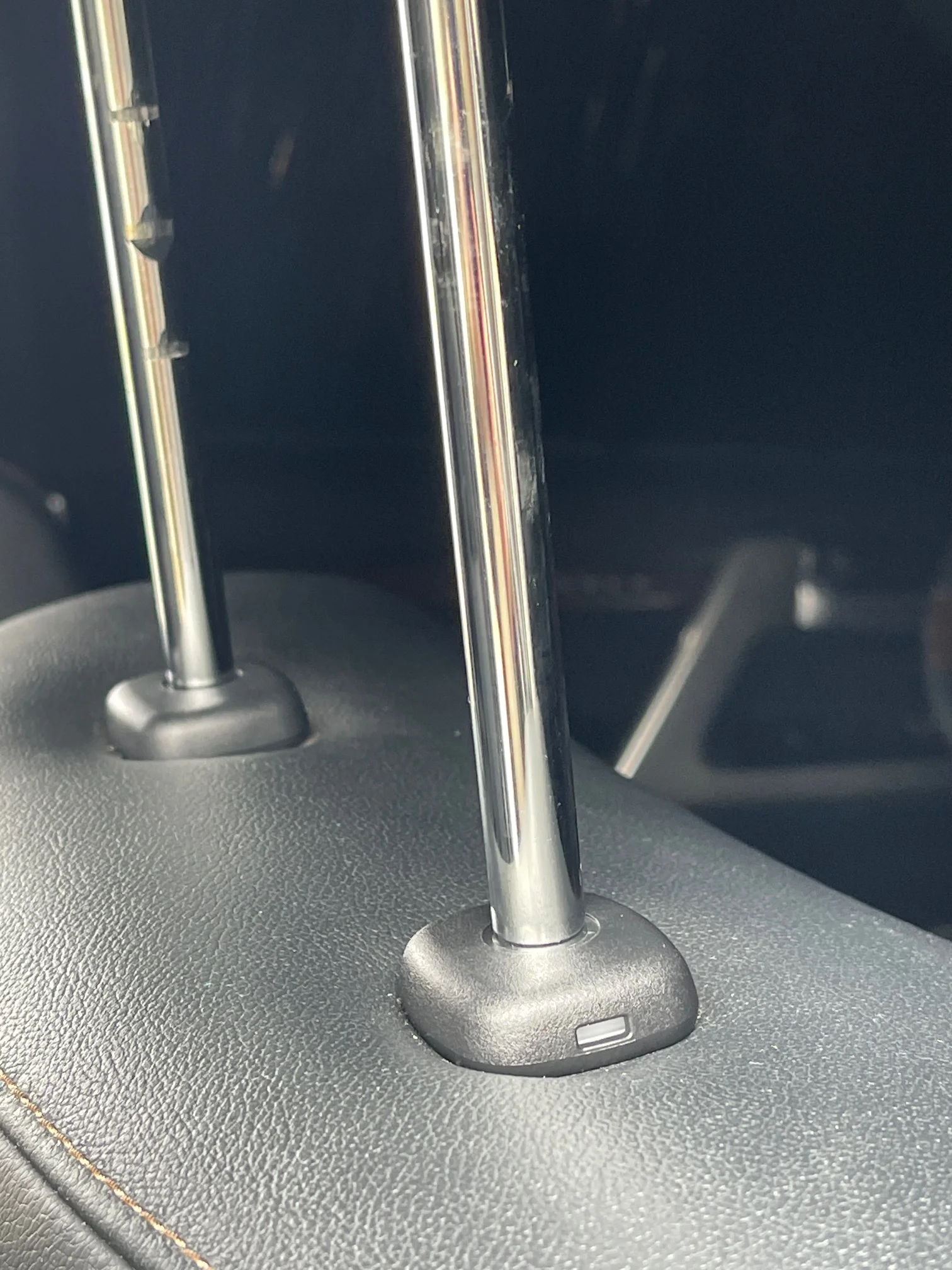

Here's my SQOTD....
Removing the headrests to install seat covers, and there's a little white plastic piece on one of the posts. The manuel sez to push it in with a flathead screwdriver while pressing the other side in to remove headrest.
Will that fall out when I remove the headrest or does it stay in the post, ready to be re-inserted? Just curious if that plastic piece disappears once you've pushed it in?

Here's my SQOTD....
it will stay inserted. Pull away..
