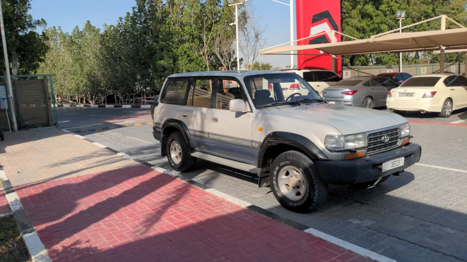

Build spinning the roulette wheel (twice) on a 1996 Middle East HDJ81 at auction

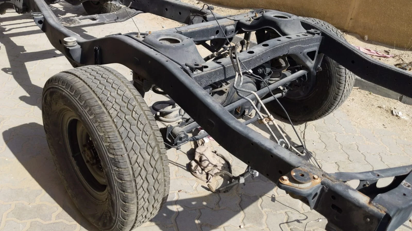

BTW, our friend CruiserMatt down in Florida and I were discussing the frame swap today and I sent him some photos of the original chassis and the donor chassis now on the truck. It has been so long that I had kind of forgotten that the 1991 donor had front and rear lockers on it. The downside is that he donor also has rear drums, and I'm sure that the guys did not swap out the master cylinder which turns out to be something we should have done. Here are photos of the original RHD frame now sitting beside the garage:
I went back and looked at old photos of the donor frame but I was at that time focused on the engine and transmission mounting brackets and not the axels so I don't know that I have good photos of the axels now on the truck. I am going to have to climb under there and see how it all looks currently, in terms of the lockers.

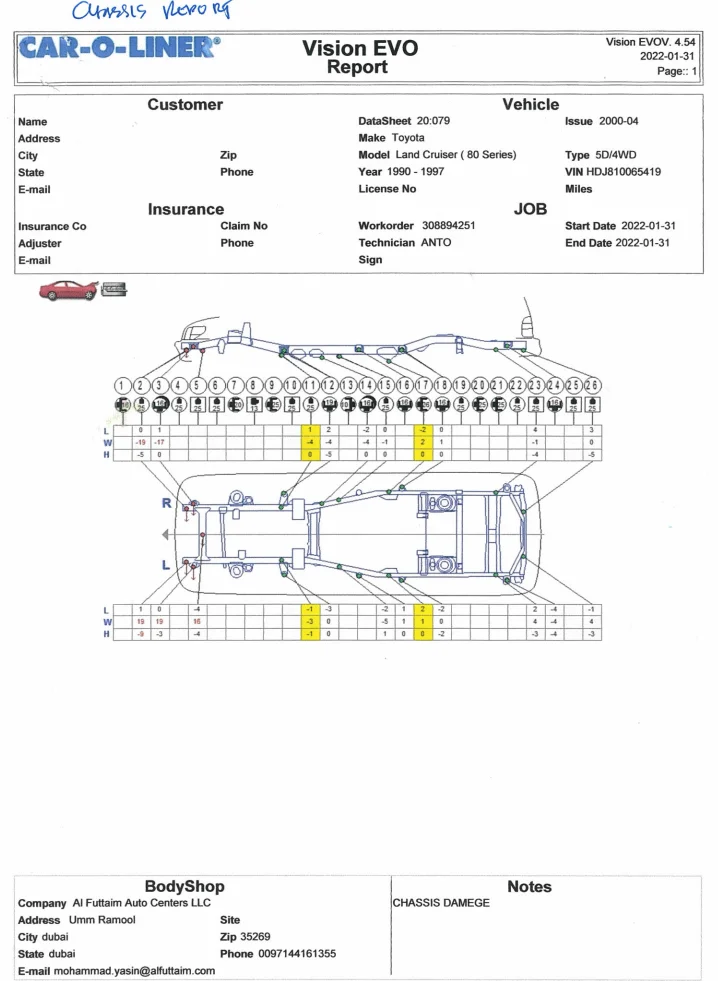

Some of you may find interesting the 'frame measurement' results from Al Futtaim. I tried to talk the service manager out of doing it, and I don't think it was necessary for the RTA process but they did it anyways and charged me 1800 AED (about 500 USD). I did not want them doing it because I suspected they would then start poking at the whole RHD to LHD conversion which had not actually come up. Here is what I got for 500 USD:
Maybe some of you know how to interpret this? They concluded that the frame had been in an accident. I saw no evidence of that at all on the donor body or on the donor frame before it was put under the truck. I suspect it may simply be the differences between a 1991 and 1997 frame; or maybe the motor and transmission mounts? Any ideas?

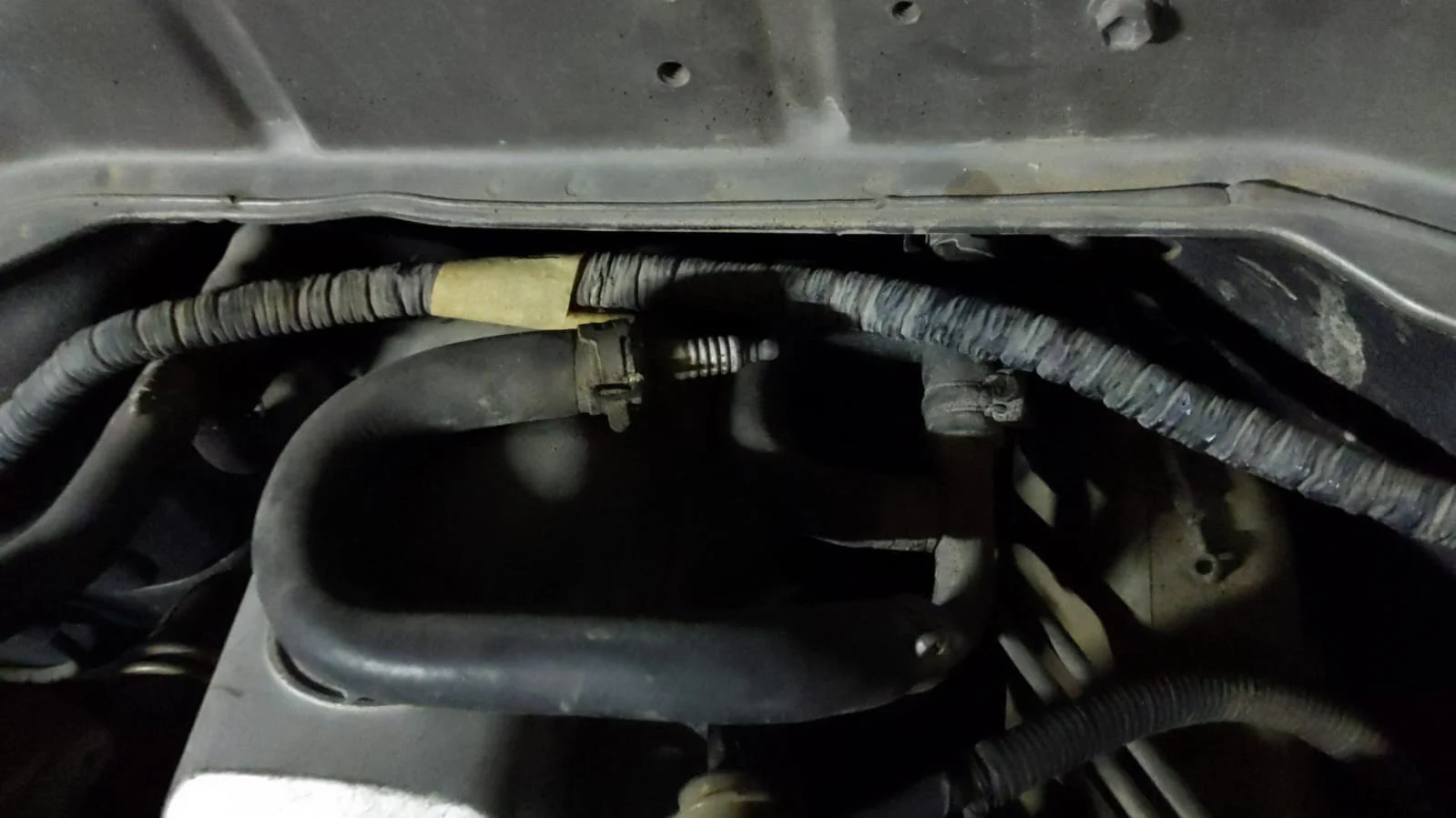

It turns out that when the guys put the engine back in they hooked up the hoses to the heater core...but....
Look Ma, no heater diverter valve!
Yes that is a field expedient plug for one of the coolant hoses.

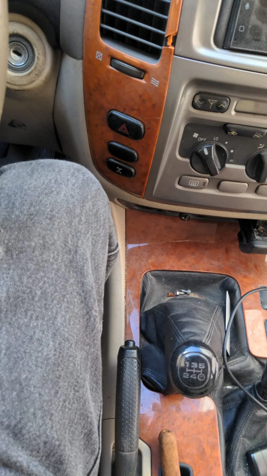

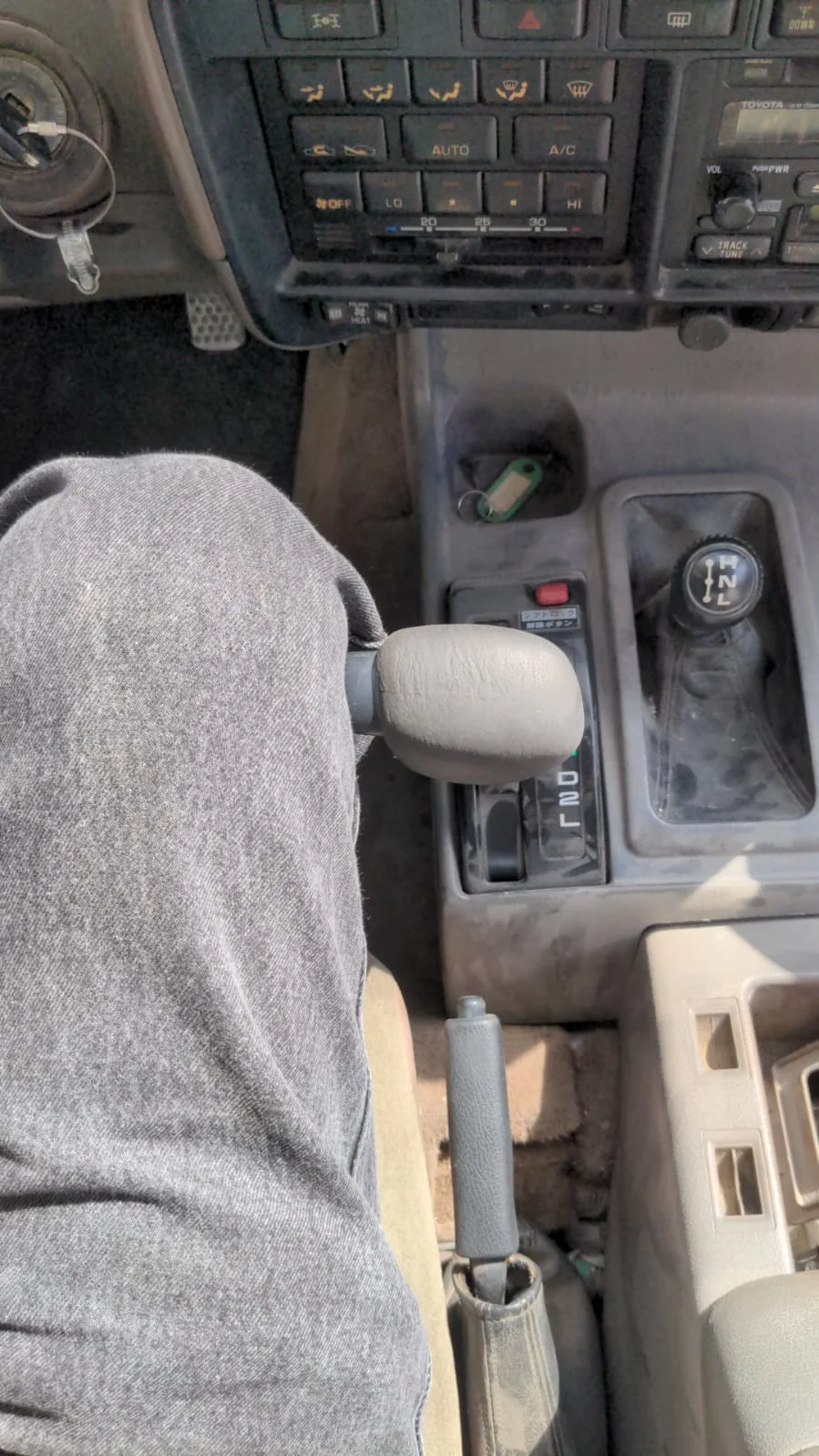

But here's an illustration why I just want this truck out of my life. Here is my leg driving this 80:
The button is pressing uncomfortably into my leg.
Compare this to the position of my leg in my daily driver 100 series:
So I am going to list it on here for a few days before throwing it back on Emirates Auction. I'd rather it go to a Mud member than to a stranger. I think I've picked a reasonable price. I'm pulling a few items off of it, like the factory winch and bumper, but it is still a diesel with a solid body, running and driving, with a factory swing away rear tire.

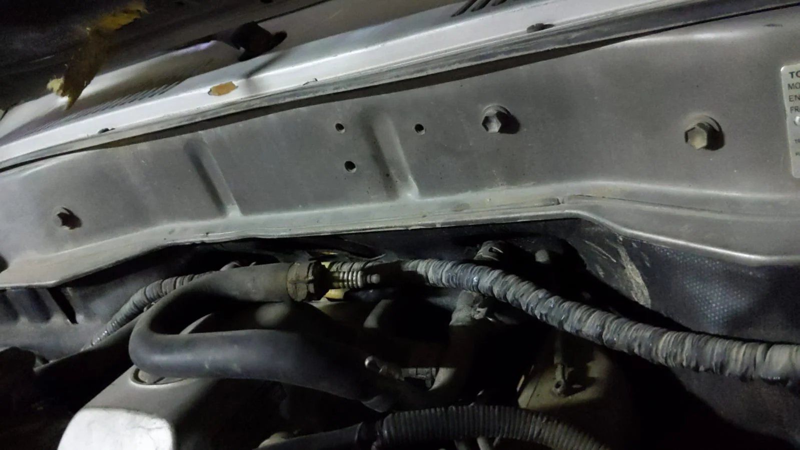

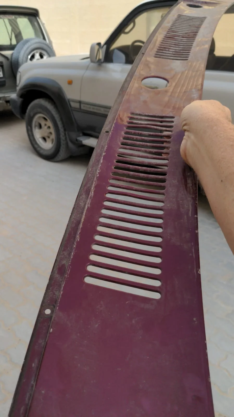

I get there and the truck has been cleaned and the kick panels are back in but the cowl is nowhere to be seen and everyone is at lunch. I go into the office and ask them to call the foreman, who does come, and then the body/paint guy and they have the cowl and I breath a sigh of relief...until they start to install it.
80 series cowls are different for RHD and LHD trucks....
In my haste I had picked up a RHD cowl and the holes for the wiper arms are in the wrong place.
I take a beat and decide to forgo the cowl and ask them to just put the wiper arms on, and I will go. They do that and I climb in, light a cigar and drive. It is now about 1:55 pm. I am NOT going to make the appointment on time. I am just going to go and hope for the best. I get on the highway and try to relax. And I'm reflecting on 3 and an half years battling this truck and all its issues and it feels SO good to have the end in sight! I'm about 30 minutes into the 45 minute drive to Emirates Auction when I notice....the temp gauge has skyrocketed!

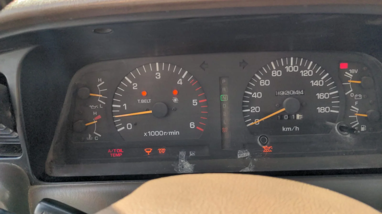

I make the turn off the main road and get to the wholesale Fruit and Vegetable Market about a mile from Emirates Auction. I took this picture while stopped at a (long) traffic light. Despite idling and even turning off the engine, it was getting hotter and hotter by the moment. I've never seen any of my LC's get hotter than 1/4 of the gauge so this is pretty stressful.
What do I do?
Do I chance it and drive one more mile in the afternoon heat with the needle above the red line (which it was by that time)? Do I pull over and let the engine cool and then try to make it? But will I be able to start? And I'm already late for a -government- appointment.
I was so tired and so fed up by this time I decided to chance it and if the engine seized up I would have the truck flatbedded the rest of the way. So on I went. And I actually made it to EA:

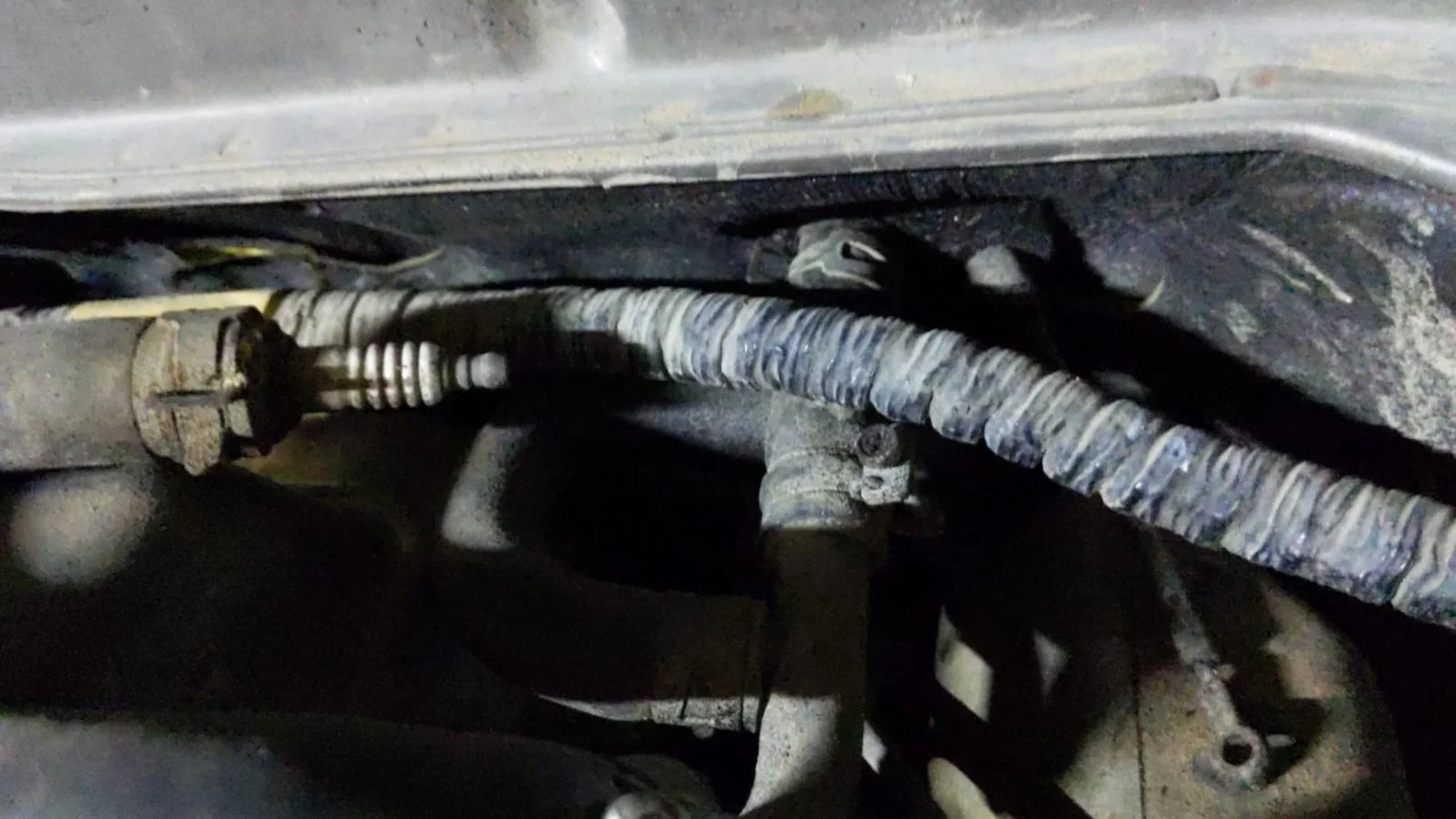

Damn. Water is streaming down at the back of the engine. I had looked at all the heater hoses and had not seen anything amiss, and I'd also looked carefully at the water outlet at the back right side of the engine and had not seen anything.
Ok; obviously I cannot get any more coolant in the system. But maybe there is enough to safely get over to the testing station while it boils off... I decide to seek expert advice. I call the owner of the garage and tell him what happened and ask his advice. Keep in mind that this fellow is an unflappable Aussie who also happens to be the acknowledged expert on race-ready desert trucks. He's seen it ALL before and he knows what engines can stand when it comes to cooling under these conditions. I had driven a 1FZ-FE 100 series 5km through soft sand and 120 degrees in a medical emergency a couple of years ago so I knew these engines could take a good amount of abuse in exigent circumstances, but would this be too much? There was silence on the other end of the phone for a moment, and then a heartfelt.... "Oh no..." I told him that I had not seen any evidence of a heater hose problem and he opined that it might be the freeze plug at the back of the engine, which would be bad because it would require engine removal to address. I asked him if I could drive a kilometer or so to the testing place and he though that would not be prudent. He asked me to flat bed it back to the shop and he promised his guys would take care of it quickly--which is important because the car's registration had expired a few days earlier and the tags on the licensed plate said FEB and we were now at the end of the month. I had taken a chance driving it over to EA, technically. I would not take that chance if we passed into March.
