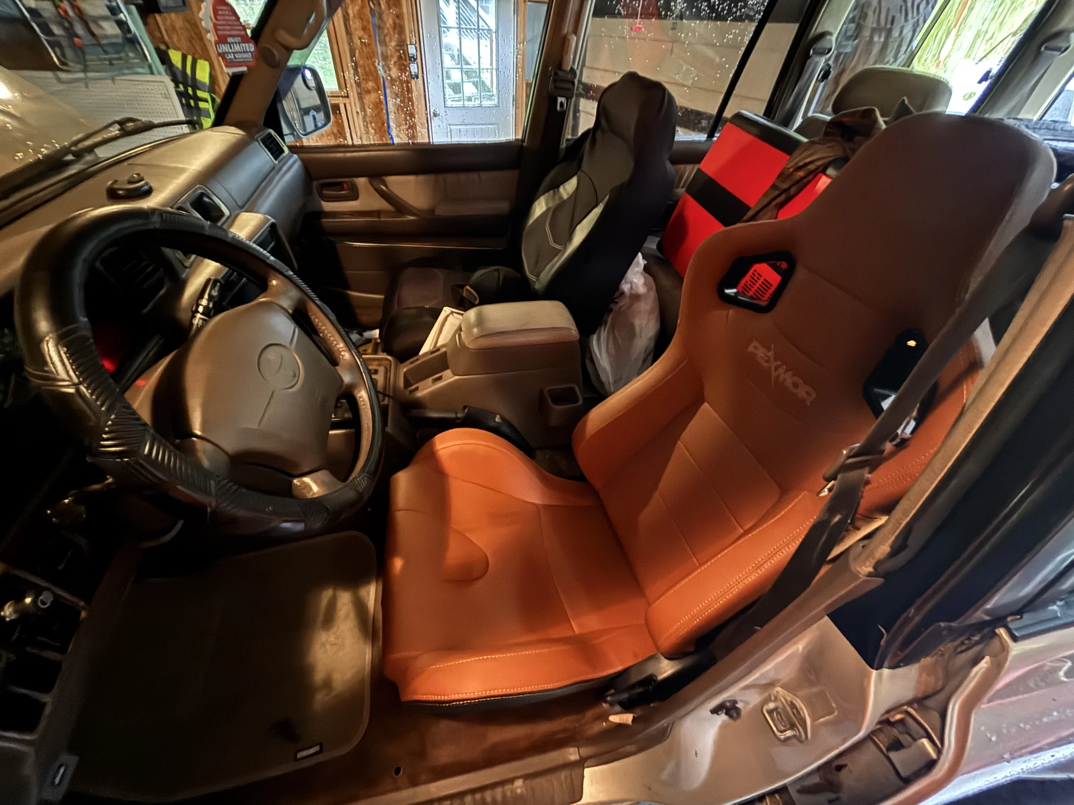

Busy day, Chinese seats are a no go. Side bolstering makes the improved leg room seem “not worth it.” The factory seat has been reinstalled. I’m sure for someone with a sub 36 inch waist, they’d be killer. (For sale for $200 so I don’t have to ship them back)

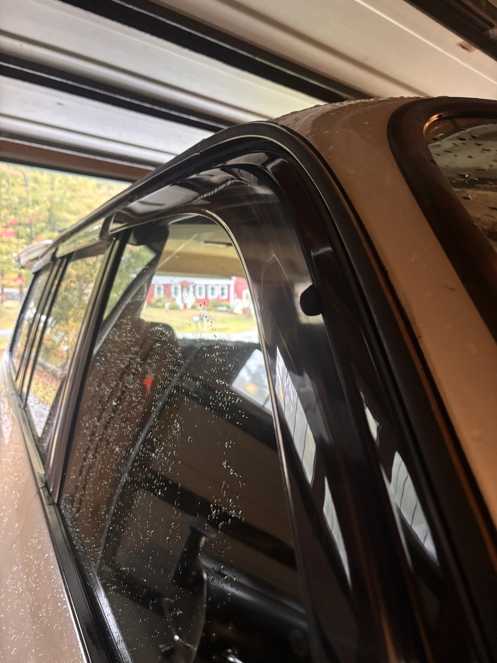

Rain guards installed in the rain, could say the activity was quite fitting.
