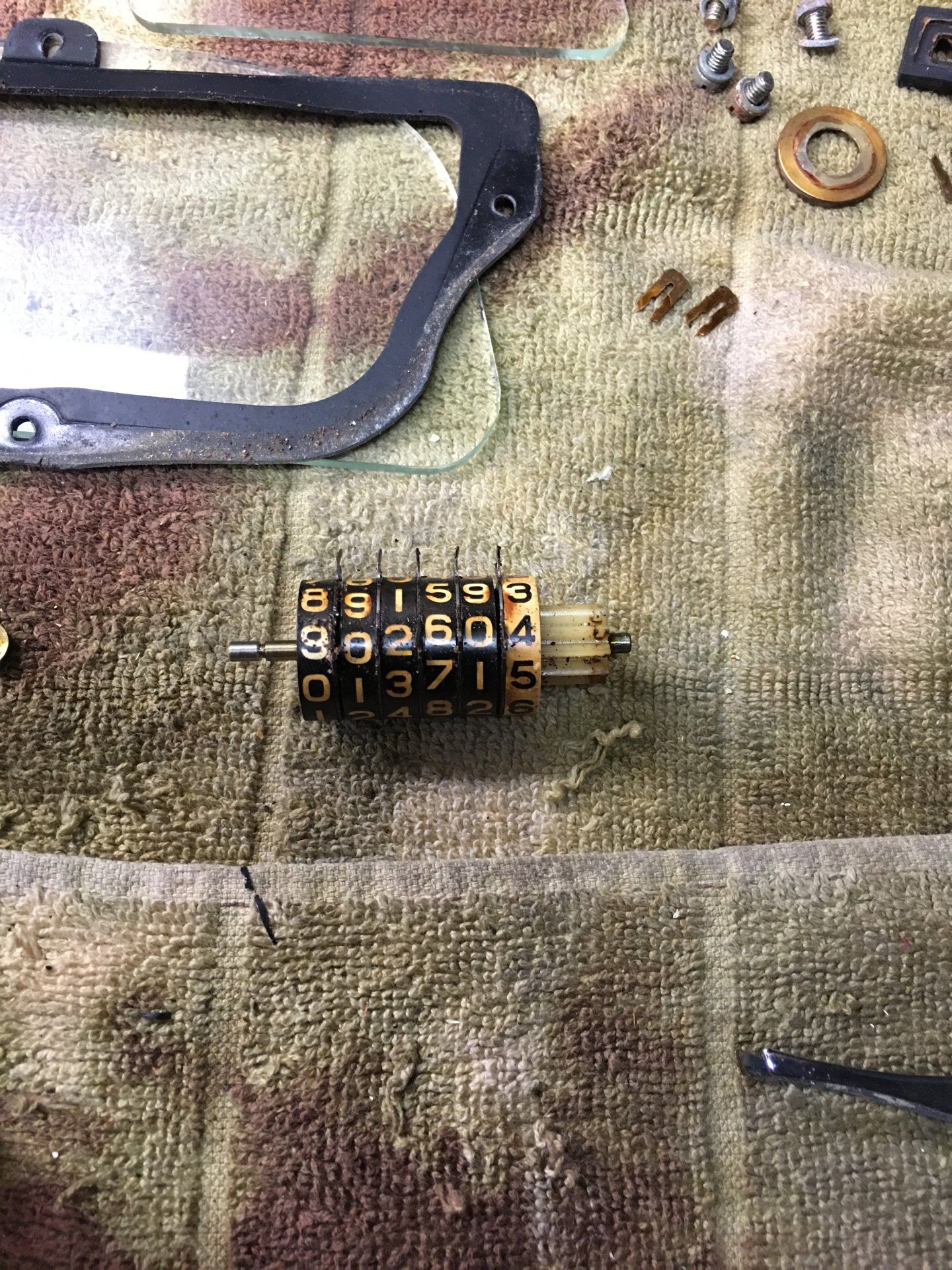

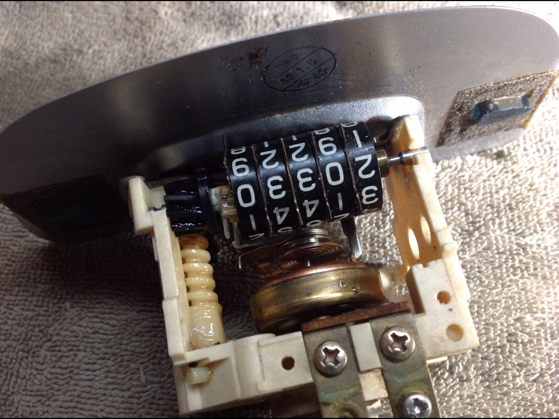

Here's how I fixed mine;
Actually I don’t really and I haven’t had to get inside mine since 2017, but let’s see if we and/or others can help with your issue.
The reason I took mine apart was the 1/10 part oh my odo was broken. Take a look at a couple of my pics and see if your gears that actually turn the odo look nice & clean and have fresh lube.
Lets see if others can point us in the correct direction and if not, I do have another cluster in the garage I can pull out to refresh my memory.
