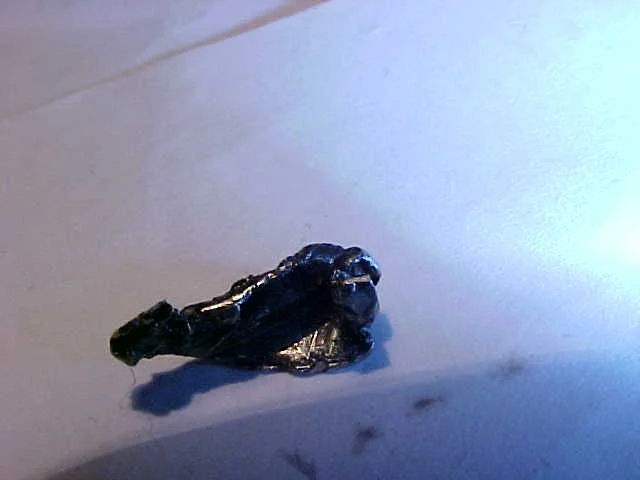

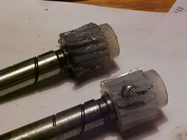

Bought ans installed a new Speedo driven gear from CDan last week for my speedometer which started working good after about two years without having a speedometer. Well, after 215 miles it went out again on me:crybaby:. I pulled it off again and I found a chunk of metal (not aluminum) stuck to the gear (2nd pic). The one before lasted 100 miles and the gear was also messed up on it. 1st pic shows the metal piece, 3rd pic shows the gear that lasted 100 miles on top and the newest one on the bottom.
This TC was rebuilt when the wagon got the vortec (~10K miles ago) and I have only used 4wd about 5 times (no more than 20 miles). Is there a way to look for something obvious inside the TC without pulling it out?

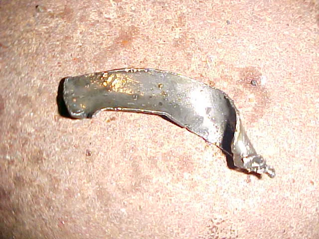

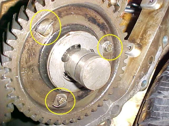

Finally got to open the TC and found more metal pieces inside including the one in pics 1 & 2. Any ideas??? picture #3 shows one of the gears with what appear to have broken pieces.

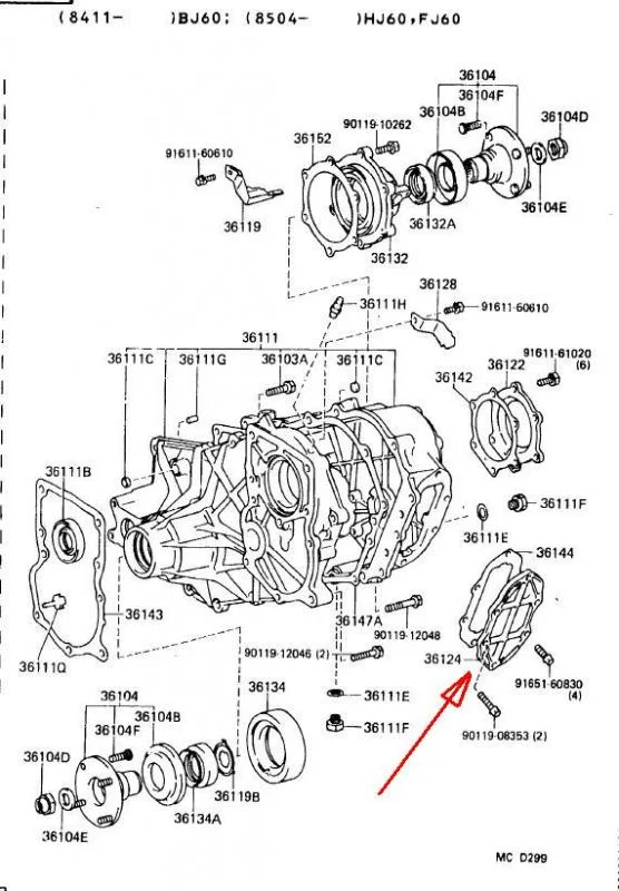

there is normally a big ring shaped splash shield that bolts there, looks like it got totally torn off somehow.. how does the rest of the stuff look? are the gear teeth OK, I can't believe it ate that part...
some of the teeth have small chip on the edges but not too bad...
anybody have a picture of what the shield looks like?
