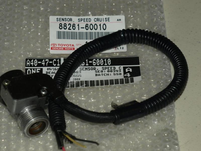

I purchased and installed the 31 tooth gear from Slee on my 5 speed manual 1991 HDJ81.
My cruiser has a speedometer cable and is not run electrically, and my original speedo gear was 33 teeth and not 32.
I was concerned that the 31 tooth would not engage properly on the transfer case drive gear, but it works fine.
I did this while installing aftermarket cruise control. My cruiser has 285's and 16 inch rims , rather than the stock 15 inch rims and prior to doing the speedo gear change my speedometer was out about 7%, and the drive gear change has now made it essentially correct.
The pictures show the original gear, and gear housing, and the speed sensor that I installed for the cruise control
