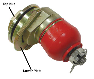

How abut something like this:
I'm just weighing the benefits between the two.
Uni-Ball Pros: Strength, Increased Droop/Caster/Camber, User Replaceable
Uni-Ball Cons: Prone to Squeaks, Must Lubricate, Cant get the replacement at Napa.
Ball Joint Pros: Sealed, zero maintenance, Longer replacement cycle. User replacement with widespread parts availability. Potential for increased travel/caster/camber over OEM.
Ball Joint Cons: Slightly less strong, maybe (unknown) less droop and alignment adjustment.
Dunno.

What about an offset balljoint? Can we get that too? To me, in theory, it sounds like a good idea to get most of the adjustment at the balljoint and then fine tune at the inner pivot points. With the OE design, it just seems like it binds when adjusted too far.
Can an offset ball joints hold their set position over time and abuse?
^ packaging gets a little trickier/impossible to retain full/extended droop clearance between the off-set balljoint/arm and a 2.5 can shock. A clean sheet design can accommodate whatever offset, laterally and/or fore/aft as necessary for any ball joint...
like to know the articulation range, in degrees, on any of the mentioned ball joints.
Good point. How about a standard ball joint but the arm slotted fore to aft for caster adjustment. Should not need too much extra room. Ball joint would be responsible for caster and inner pivots for camber... less bind?
But, as you said, building it in would be best. And seems like everyone has a 2-2.5" lift and so it shouldn't be too hard.
