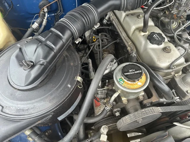

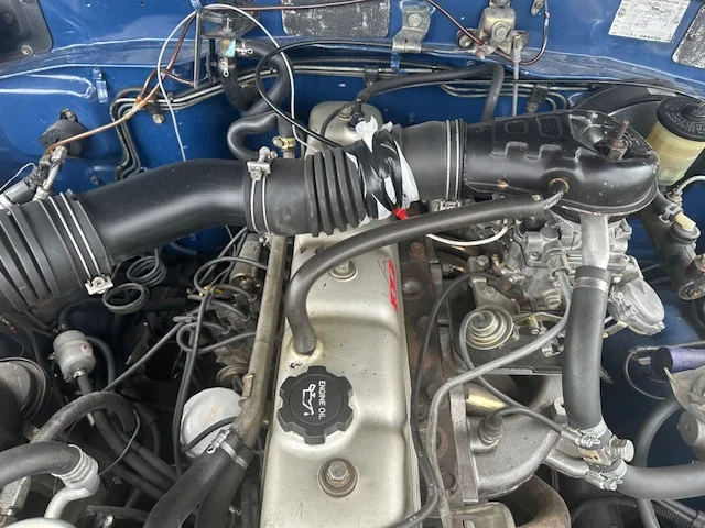

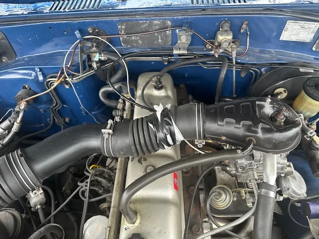

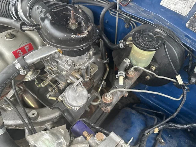

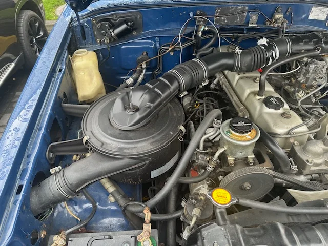

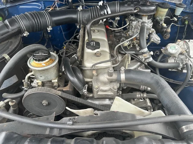

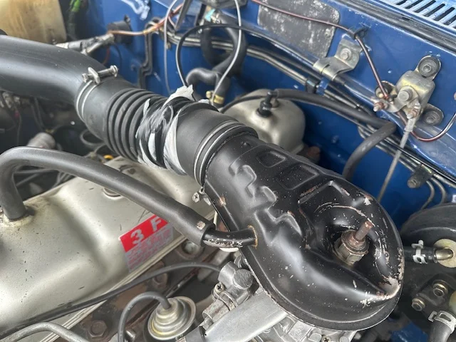

Could you share a photo of your engine bay? I wasn’t aware that South American–spec 62s had emissions requirements. Are you sure you’re not just seeing normal vacuum lines?

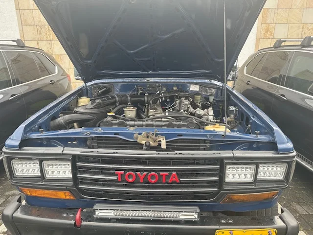

Apologies if im all over the place. I tried to keep it fairly straight forward. Yep. Ill add those fotos below.
Nice looking engine bay. Looks pretty much like mine, minus a clutch booster.

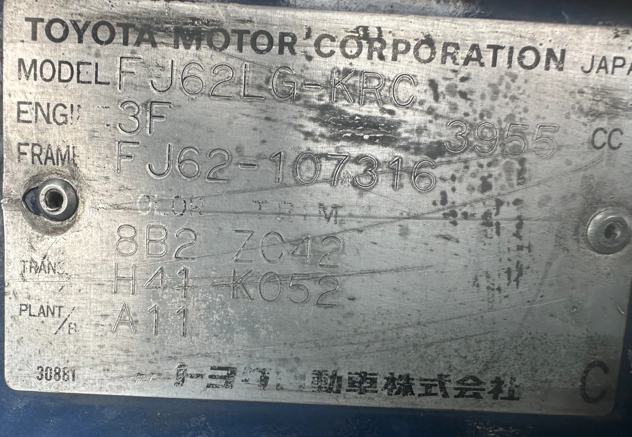

If you’ve got a VIN, frame or model number and you want to DM me what you’re looking for I might be able to help.
Oddly enough. No Vin. But the Vin plate does have frame, motor and chassis number. I checked inside of the driver side door and no dice. None of my paperwork has it either.

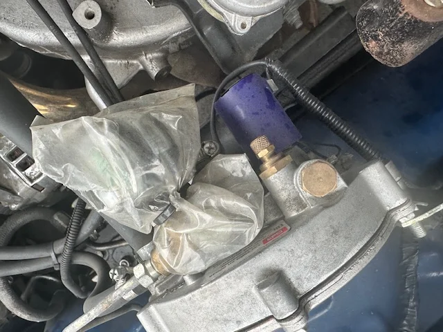

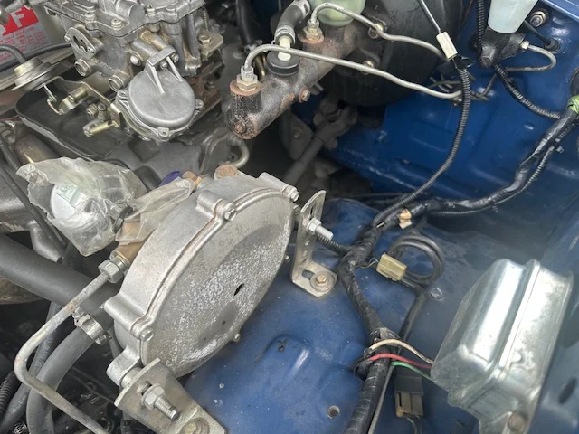

When you talk about a smog system, are you referring to the cylindrical assembly which has a hose running to the carburettor? That looks like an LPG system to me.

Yes, I am. And thank you for the suggestion I’m going to do just that and read,
