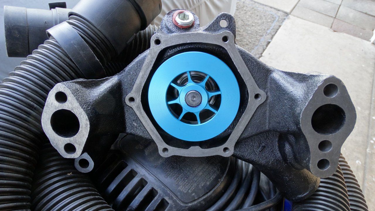

Now in the past I've always just pulled the pump out of the box and bolted them on. Because there are some differences with this pump I decide to read through the instructions provided in the box. Much to my surprise it state: "c) If there is a backing plate, remove the plate and install sealer on backing plate gasket. Tighten securely to seal." I'm glad I read the instructions this time because finding a leak after everything was back together would really chap my *ss!
Here is what I found when I took the cover off:
Not your every day impeller.

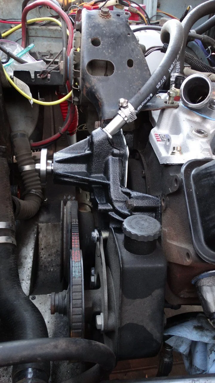

So after adding some sealer to the gasket (not shown in photos) and putting things back together I shouldn't have to worry about the water pump any time soon.

I would contact them because they may make an impeller to fit the factory water pump or be able to modify yours if you sent one to them.

Are the Flowcooler guys too cheap to use their own sealant? Just wonderin' :meh:
FWIW, at least twice in my life (long, as it is), that rear cover has been the source of grief when it rusted through and sprang a leak. On the up side, a silicone trail fix (with the rad cap loose) will get you home.
