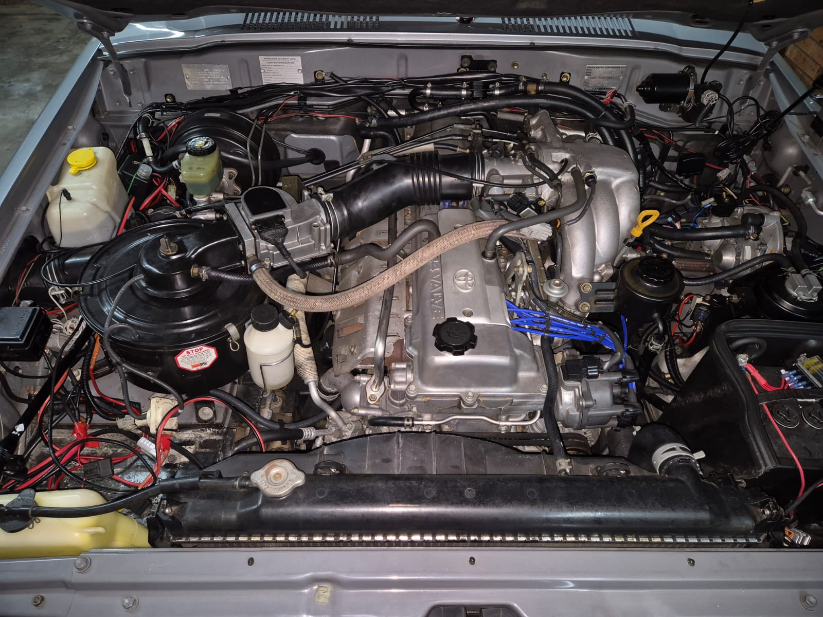

can you take a photo of the whole engine bay showing both sides of the engine and LPG items. In the video I could see the converter but not the mixer (usually an Impco 225) hence my assumption that its injected LPG.
Normally the intake tube just prior to the TBody on Vapour LPG setups is replaced with another pipe that has holes in it to allow for any backfire to escape there and protect the MAF. That pipe is usually covered with a BFS backfire sock (stubby holder)
Intake configuration on mine below
Air Filter > MAF>Impco Mixer>intake tube with holes and BFS > Throttle Body

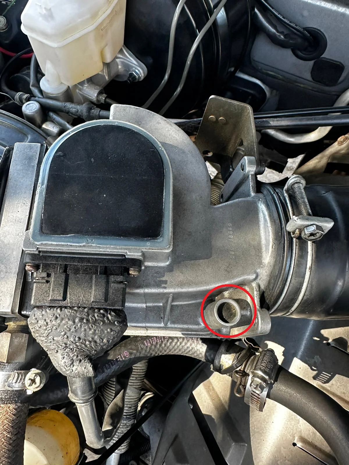

- my parts guy at Toyota last week, told me that you can adjust the VAF, modifying it via a screw... so I looked at mine on the car and sure enough, it's been filled with black silicone. My dad's best friend then told me he had the car dyno tuned around 15 years ago and they "tweaked the car" and got an extra 15kw. I'd bet my bottom dollar that they modified the VAF to adjust the AFRs then bumped the timing right up to compensate for the extra fuel. The spare VAF I have, does not have any modifications. I think there is a way to bench test the VAF's, so I'll do that to the spare one, and if good, I'll fit it to the vehicle and see what happens (obviously being careful with the timing settings). I also heard the VAF is responsible for an initial signal to the fuel pump for starting...
- I still need to remove and clean the IACV, but it might be a few weeks before I can play mechanic again
- Coolant needs a flush and change (brown under radiator cap)... so this would be a good opportunity to remove and test the engine coolant temp sensor, as it could be faulty and affecting cold starts.
I feel like I'm getting closer......maybe.... haha!
pics of VAF on car, and spare below:
spare
It looks like the one fitted on the car is an aftermarket one?? The "spare" actually has Denso on it... probably the original..

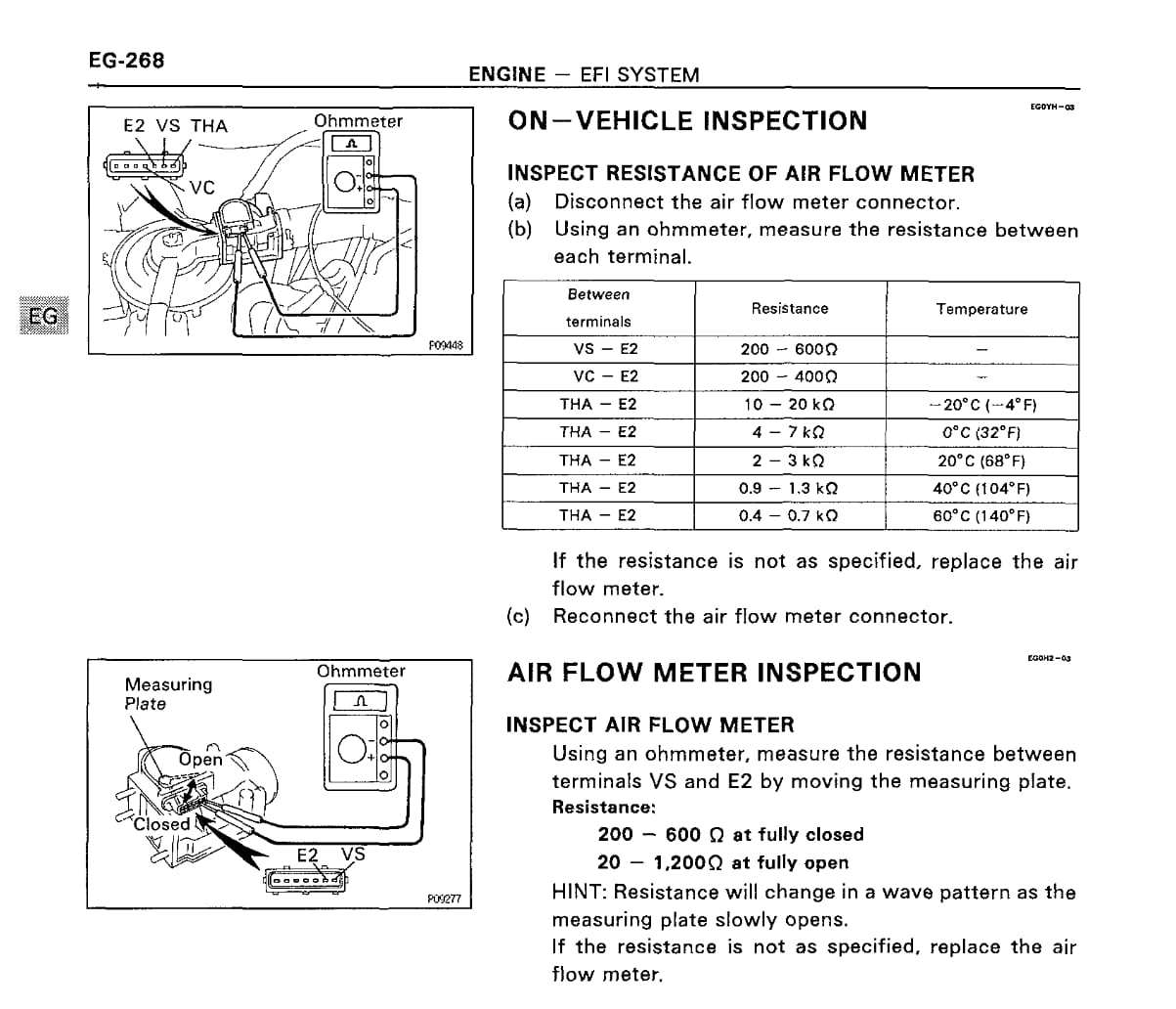

VAF testing procedure:

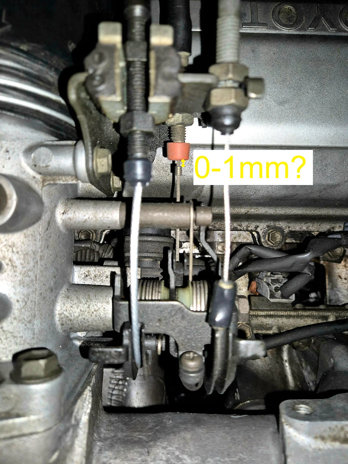

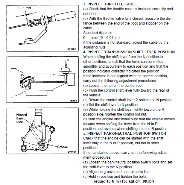

throttle (transmission kickdown) cable adjustment:

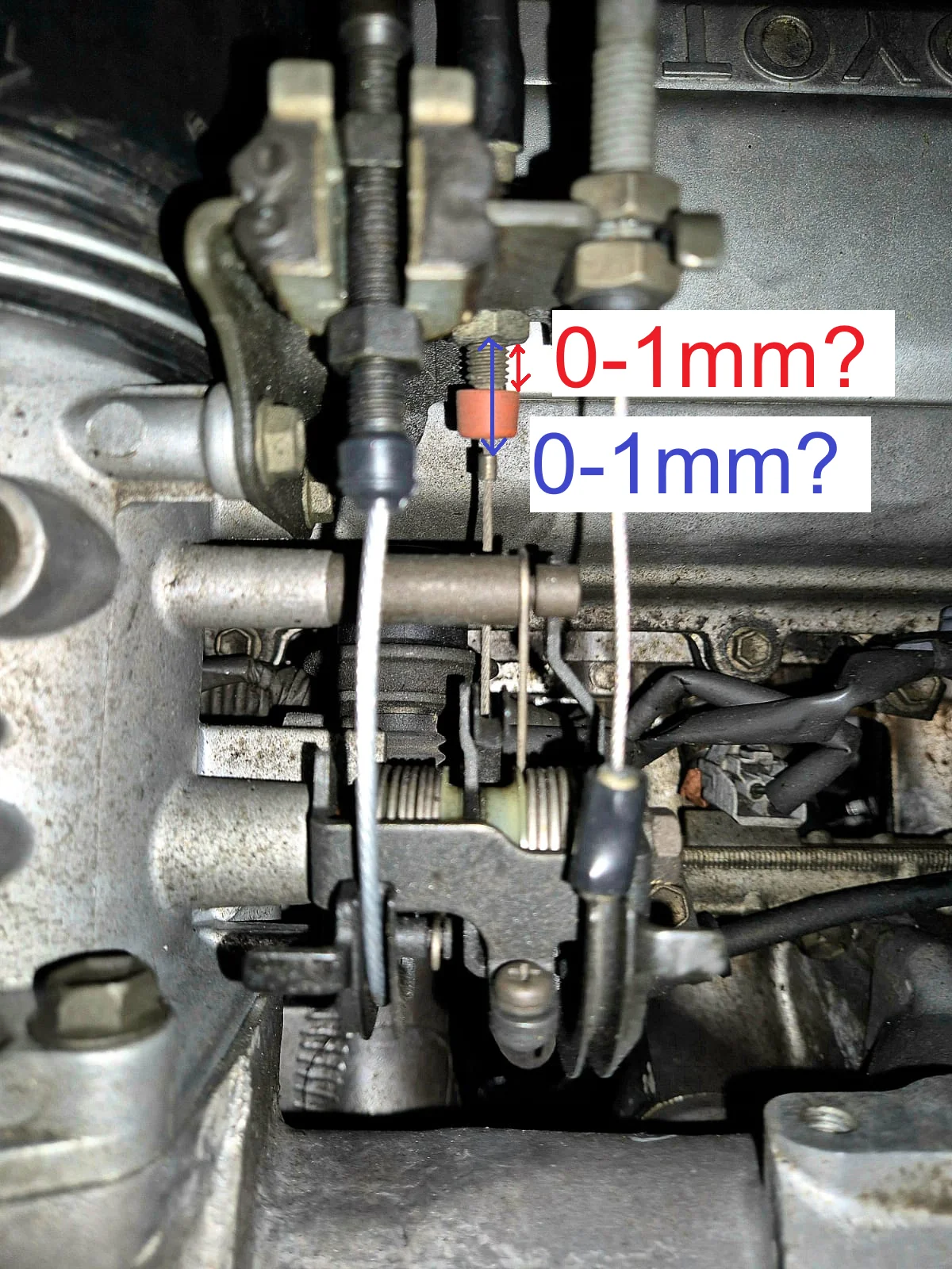

looking at my throttle kickdown cable... and trying to work out what's going on here... Is the 0-1mm adjustment in FSM adjustment procedure referring to the distance between the orange boot and the little metal retainer/pip on the cable? or the orange boot and the adjustment screw?
Also, I know my cruise control cable on the far right is shot.. it's loose, but someone must have touched it before as the thread is stuffed and I can't tighten it and have the nuts hold. The accelerator pedal cable (far left) also has a bit of slack, as you can see from the wave/bow in it.
Any help/advice before I touch these (especially kick down cable), would be greatly appreciated.
Just tested the genuine spare VAF I have with the multimeter.. all values check out. Can't wait to install this and see how the car behaves.
