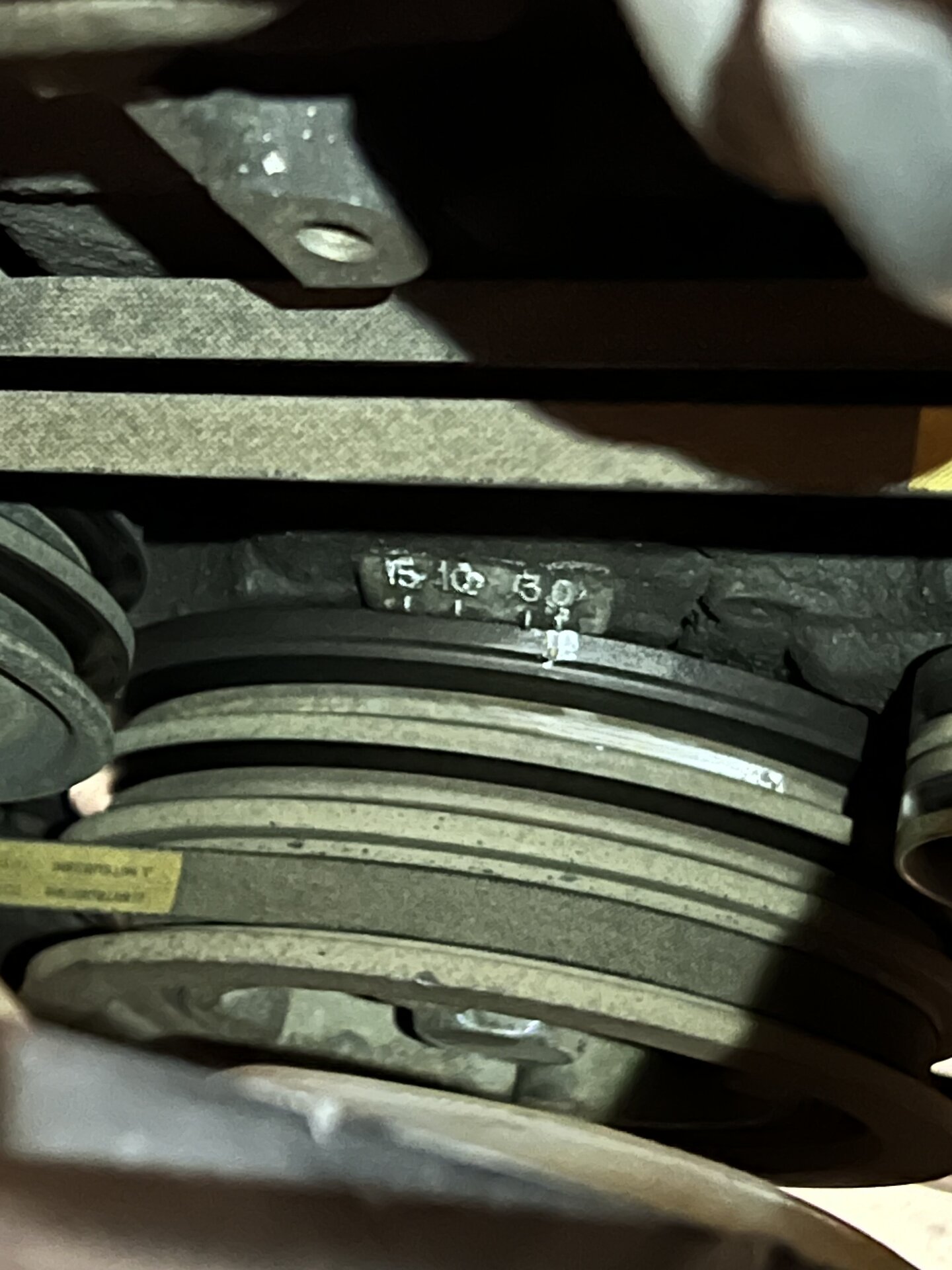

Your pic.
If this is what you're seeing with the timing light, that's roughly 25⁰BTDC.
Its advanced.
You're seeing #1 cylinder fire BEFORE the crank rotates around to TDC.
This is 100% what I'd expect to see with the ECU not in service mode.
IME it will fluctuate anywhere between about 25⁰-0⁰ BTDC when idling.

ok, so I managed to find TDC and can confirm that it lines up with the zero on the timing marks. Where to next?
@petegangies , I think that rules out any issues with the harmonic balancer. Now that you found TDC, don't rotate the motor. Remove the distributor cap and take a picture of the position of the rotor and post. Does it appear to point to the #1 spark plug lead?

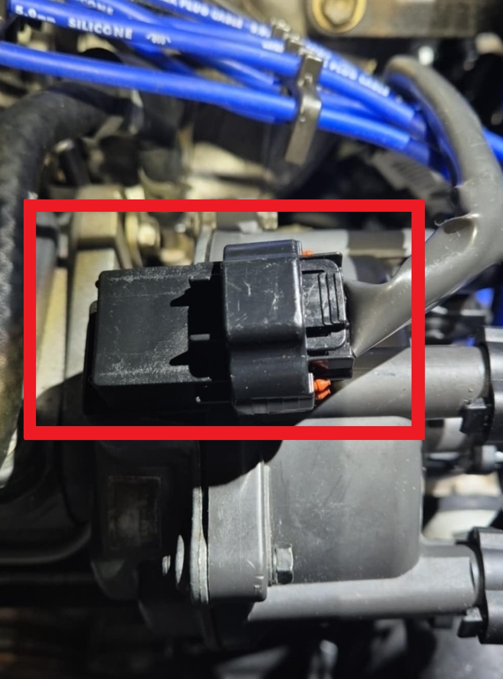

Jesus christ, my heart just skipped a beat. I started the car without the black connector on top of the distributor plugged in properly and heard a few loud bangs and clangs and immediately stopped trying to crank. Discovered that was not clipped all the way on...... plugged it in and started fine, no more bangs and clangs! I think my soul just left my body temporarily—I thought I'd done something to the motor!!... 😐😳😳😳😳😅😅
It did throw up an o2 sensor code (21) after that incident but it cleared after pulling the EFI fuse AND negative terminal off the battery....phew.
To anyone following... make sure this is plugged in properly BEFORE you start your car!
