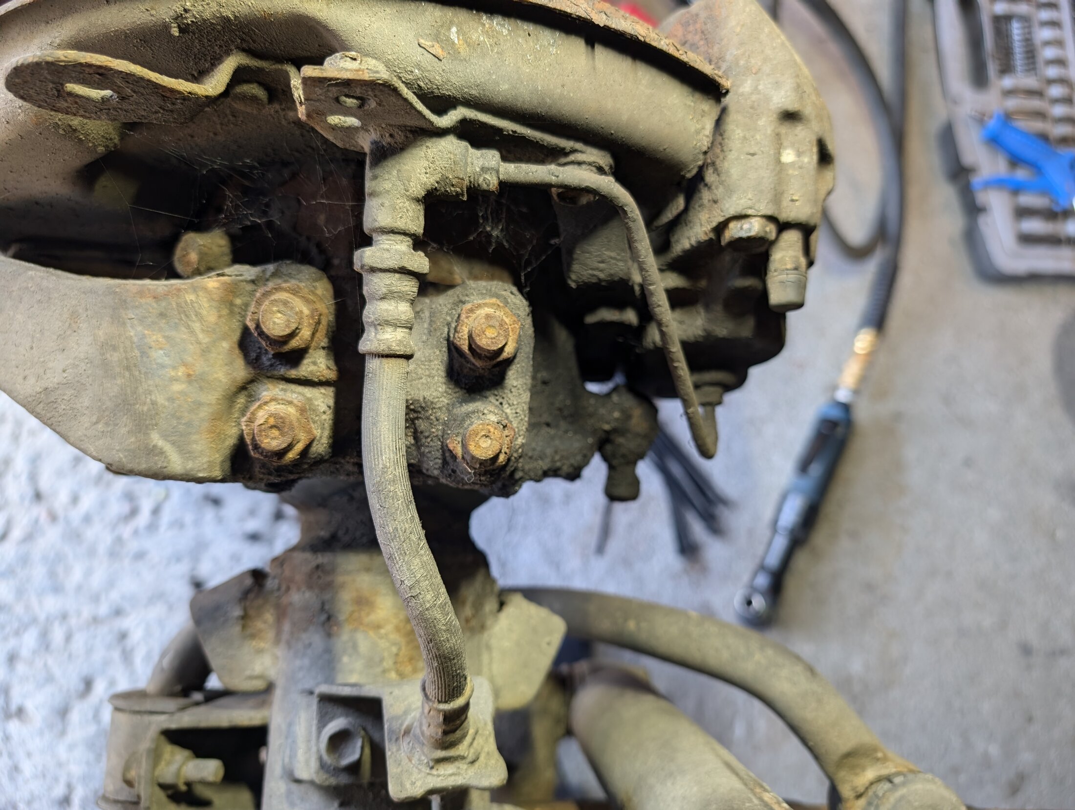

I'm doing the front knuckles on my 70, I remember on the 40 I replaced the annoying little hard line to soft line to hard line setup with one longer hardline.
Does someone know the part number or what it was from? I think maybe from a Suzuki samarai or something?
70 one vs the 40's replacement
You mean longer soft line?
Yes it's a longer softline that I connected directly to the caliper from the axle, removing both the short soft line and the short hard line on the brake shield.
This allows me to take the caliper off to do brakes etc without draining the fluid and bleeding...

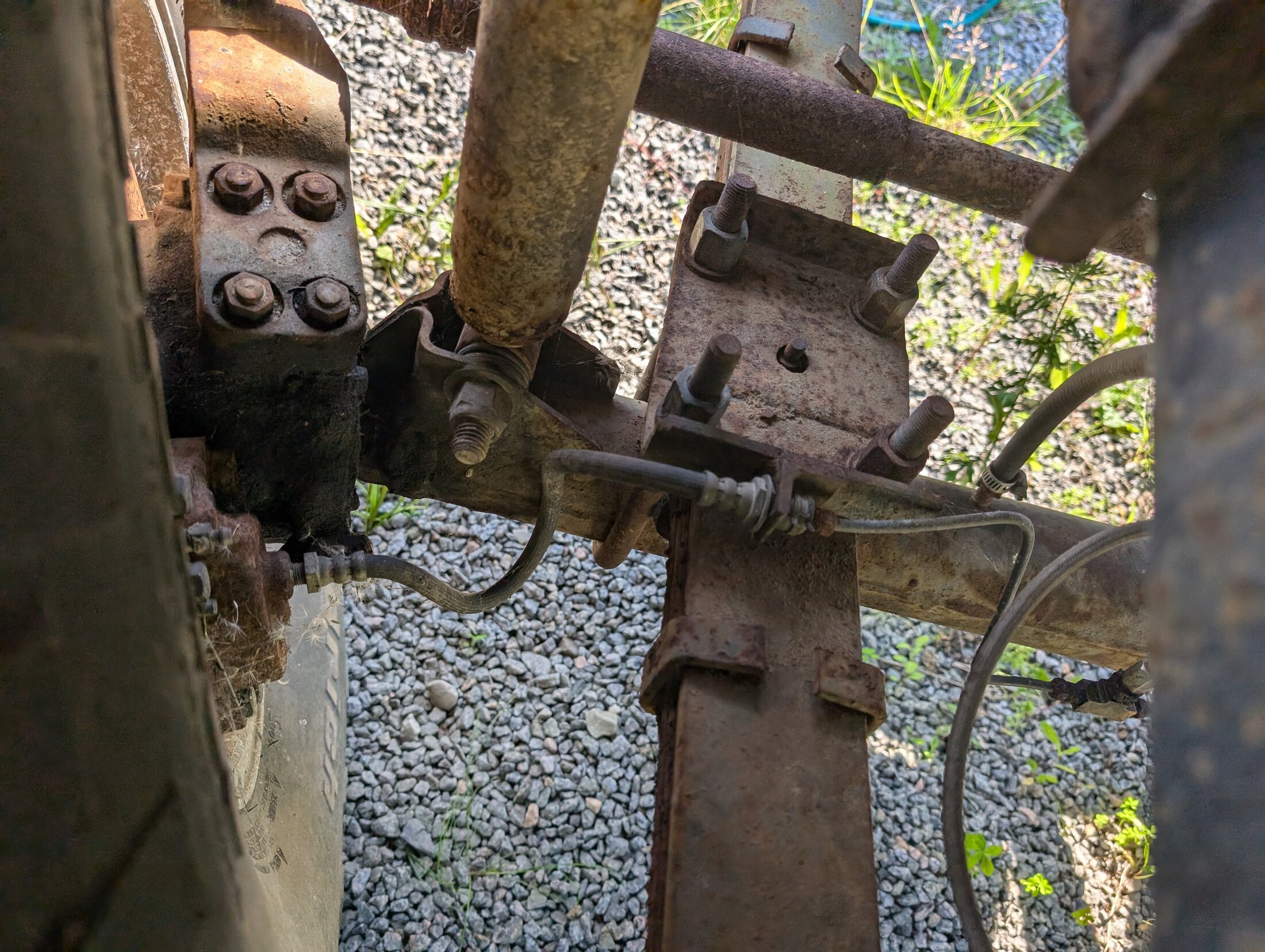

That flex line looks a lot like a stock Toyota line that goes from the frame to axle. When I bought new lines I checked on Rock auto for lengths.
On the older dust shields that little transition connection (from hard to soft line) was bolted on. Which allows removing without draining etc.
At some point they started riveting it on.
Can't help with the p/n but I ground off the rivet and welded in a stud to make mine removable for the same reasons.
Yep mine are riveted and annoying... Thinking it's nicer to just get a longer line and go that route... Any reason not to and instead weld a stud?
I think I'd already bought the short flex lines, and had forgotten about the rivet when I got in there.
I guess in theory the less soft line in the system the better, but I'm not sure those couple inches would be noticeable. (That's what she said)

These ones are good for frame to axle. About 22" long which is a fair bit more than stock.
Still need to install one on the rear of the 40.
