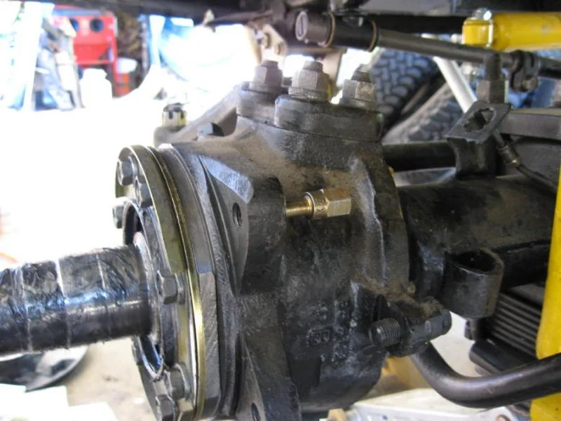

here is the long hose. ,old pic
everything has been cleaned up alot since pic was taken :grinpimp:

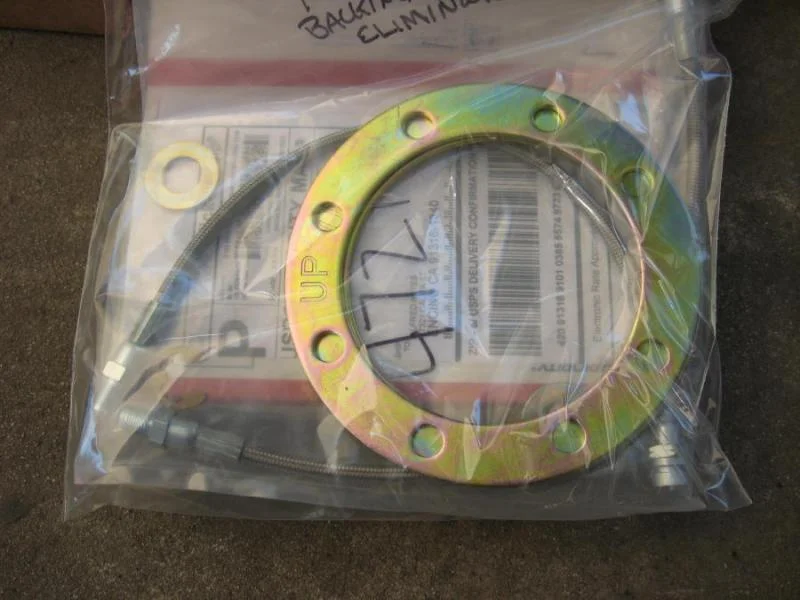

Rather than cutting your expensive backing plate to make a spacer, you can get a kit from Mark A at Marksoffroad.net that includes DOT SS braided brake lines and yellow-zinc spacer. You could prolly sell your backing plates to pay for it.
attachment.php

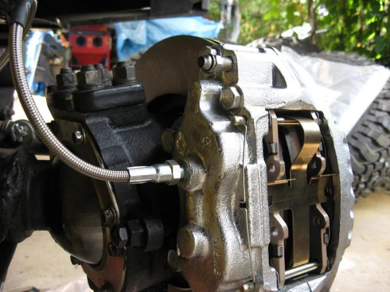

Installed on a 60:
attachment.php
Backing Plate Eliminator installed:
attachment.php
