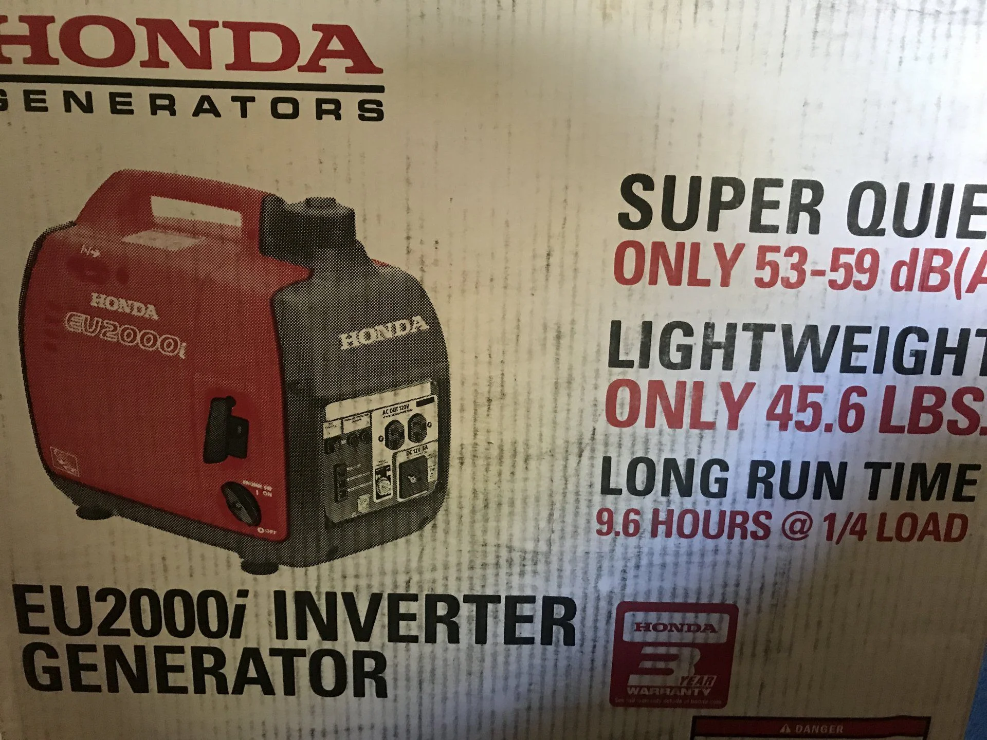

Appreciate the replies
Pulled the trigger on an eu2000.

You will love that thing. I own both an EU1000i and EU3000is. By far the biggest and potentially only problem with the 1000 and 2000 sized units is their tendency to grow legs. Keep that thing out of sight and chained. If you happen to be planning trips to cold climates there is a cold weather kit available. However it is really only necessary if you are in Canada like me...

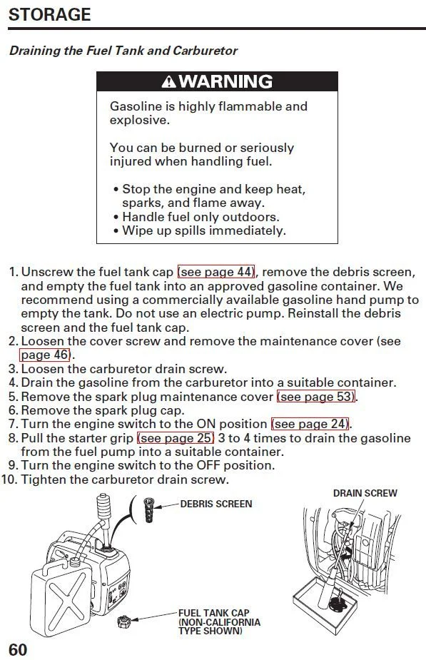

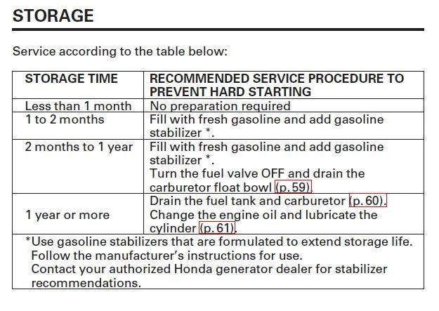

in case that helps somebody here is a copy of a couple of sections from the manual that describes the suggested storage precautions. Interestingly, there is something about emptying the fuel pump too. And yes, the engine switch also shuts off gas it seems. I would think that the ultimate gas emptying for storage would be to first empty the tank, then run the engine until it stops and then empty what may be left in the bowl if any. Hopefully that should take care of everything just about everywhere.

E9999 is exactly right. There is no need to go to the aggravation of putting a fuel petcock in. If you really needed a fuel petcock Honda would have installed one. If you follow Honda's instructions you are getting rid of all the fuel in the gen and shouldn't ever really need to rebuild the carb. I have a older used eu2000i and a new eu2000i companion. I also have friends who have the Honda 1000k and 2000k models also. None of us has ever had any problems with our carbs. We all follow the factory instructions. I never leave any fuel in the tank and drain carb per instructions. I have a backup tool kit stored with the gen that has a carb rebuild kit as well as spare spark plug, air fliter, oil and basic tools to service the gen. If I never have to use the carb kit I will be happy but it is there if I need it in an emergency.
