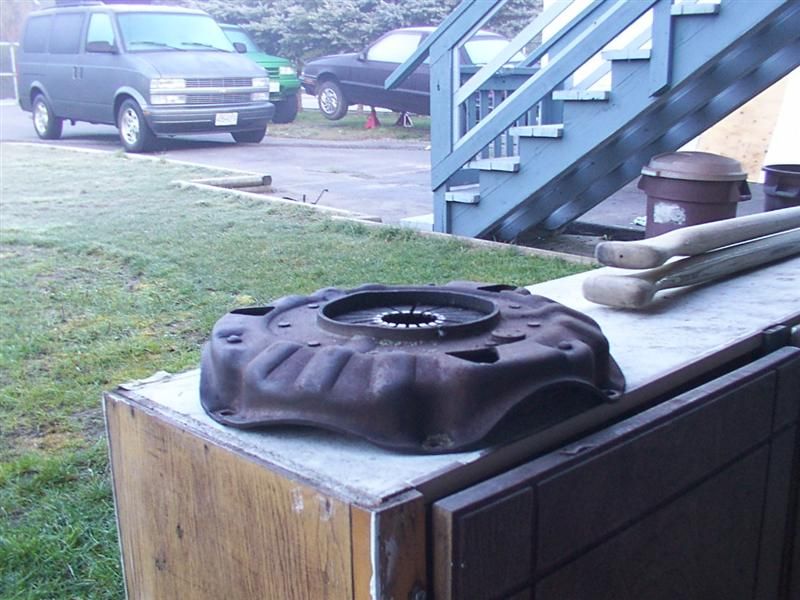

This one works best notice the flat fingers. The standard Chevy PP
Fingers will be taller which won’t work with your oem Toyota hydraulics
You will need this low profile short ratio pressure plate to work with what you have.
