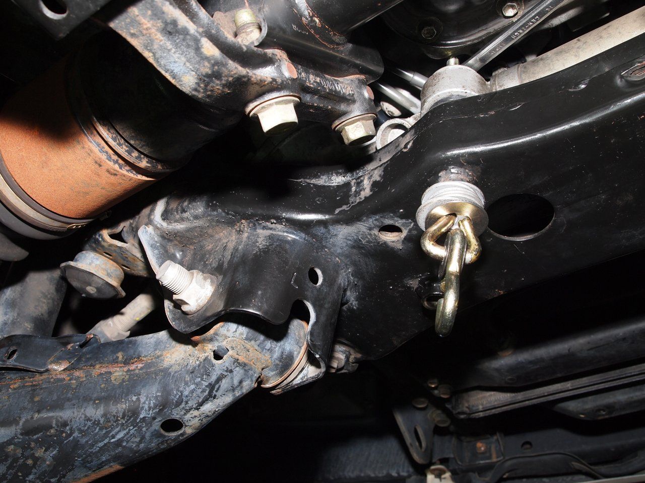

My poly bushing kit should be here on Monday, and I am wanting to use the LC to commute to my pickup location for UPS so I am really hoping to have them in ASAP.
