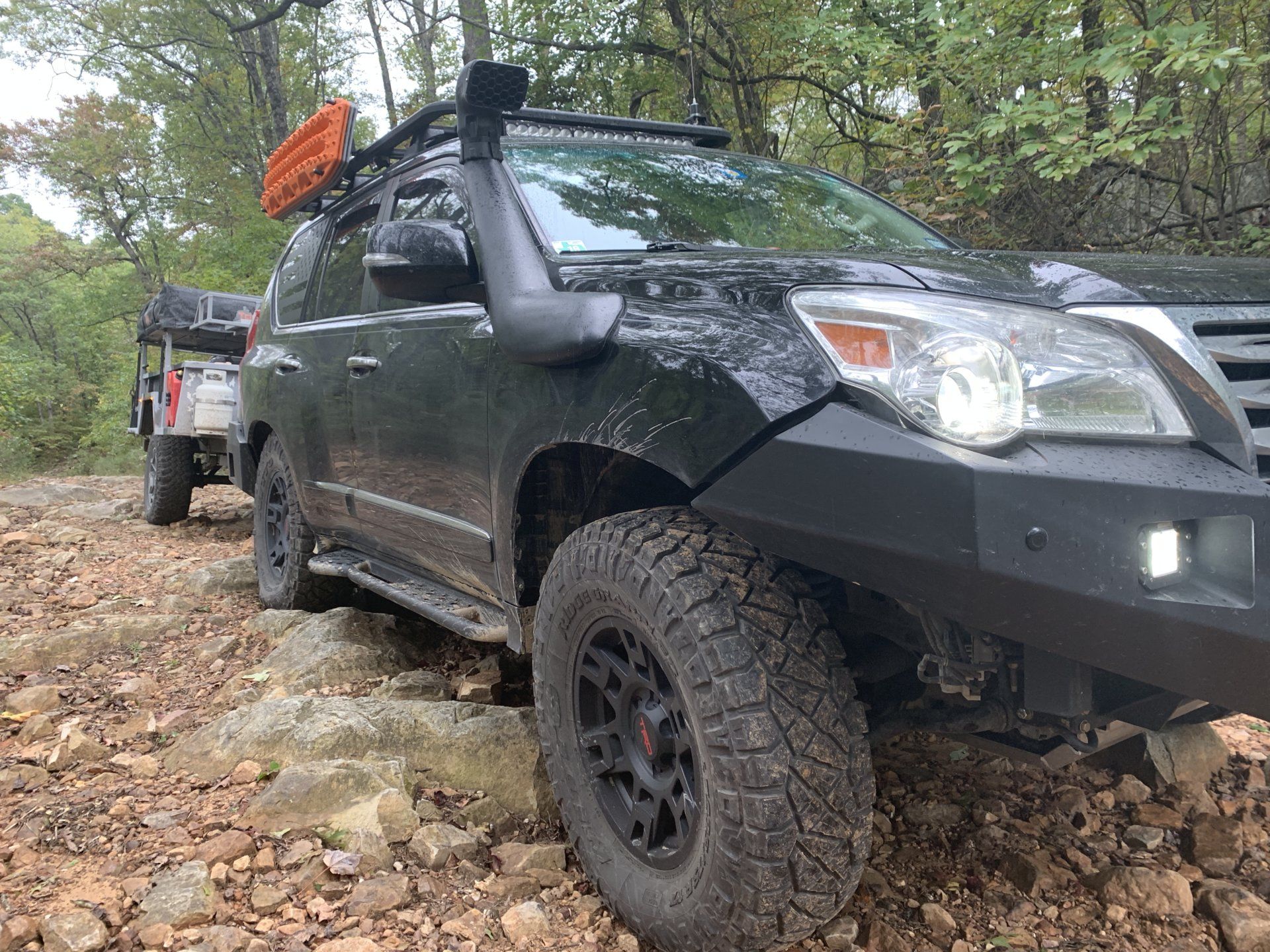

For the 460, SSO and MetalTech OPOR are the most popular. I run the OPOR sliders and they have worked well for me. Good step, good jacking point, and good protection. SSO hadn't released their 460 sliders when I got mine, but they have some of the best designed stuff in the business and although I haven't used their 460 sliders I know their products are always top notch and would not hesitate to purchase from them.
If you use it offroad I do recommend a little more bump out in front of the rear tire than the OPOR due to the flare out of the body panel. As you can see below, the OPOR didnt save the body from a tree. The damage could have been with a little more bump-out (or a slightly longer one).

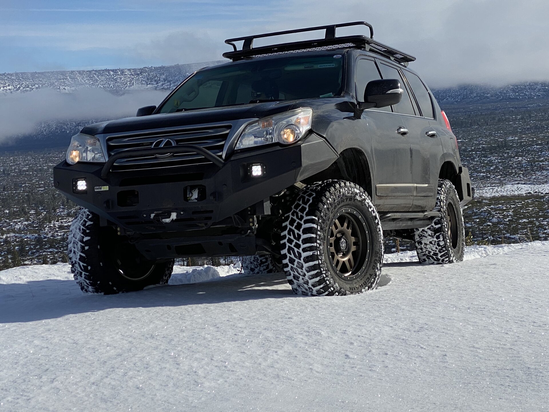

Here is my rig: R2M 2013 GX 460 Expo
I plan on replacing these some time in the future with sliders that are 2 to 3 inches wider for several reasons:
1) the reason as above, not to buckle panels.
2) more pivot room if you have to pivot on the slider, again you won't buckle your panel.
3) not as likely to get door dings from little old ladies with their 5' long Cadillac doors swinging into mine or any other mindless person who just pushes their door all the way open when exiting a vehicle. Did you happen to notice that this is a pet peeve of mine???
I don't mind trail pin stripping but I don't like dings in parking lots or fender bashing on trails.

On the photo above, regarding rails sticking out farther. I designed those sliders and have wheeled everything from East TX to the Rubicon with the same kick outs on different trucks. That photo shows a hit right past the slider before the rear wheel. Unless a slider stuck out like pontoons and went straight away from the body of the truck, (still no guarantee it would in that situation help) that is just the rare hit that truck had in whatever spot it was on a trail.
Why not go straight out from the body in the back and make a big loopy kick out? A. Blunt ends = Rock hooks
#1 Blunt ends, as in flat ends on a slider be it the body of the slider or the rub rail, when flat away from the truck = ROCK HOOKS. Slide past the obstacle, the obstacle then hooks behind that flat part. Now you can not back up, or you back up and the 3" root/brank or larger loose rock, kicks up and impales the truck, thus damage.
- Solution, front and rear of a proper rub rail should be tapered to allow both directions of travel w/o hooking obstacles.
So why not stick the slider WAY out? A. Stick out too far = Pontoons limit access
#2 Its a fine line how far to stick a rub rail out. We want it out far enough that a vertical obstacle can not hit the radius of the doors. On the Metal-tech 4x4 and OPOR sliders we use that as a guideline. We have the kick outs of our Trademarked designed two stage rub rail on some sliders go just slightly past that. The front rail where you are getting in and out, well that is just past the radius of the door. Any wider and we as the slider manufacturer are guessing all the trails you run are wide open space. Too wide of sliders will act as trail pontoons and in some obstacles be the difference of driving through or not. (b.) None trail: the other reason is if its daily driver you open your door and step out past the slider the back of your leg, wipes off the road grime. Fastest complaint from significant others, have heard first and second hand! (yes all still great roof access steps)
We want rails to protect and be as universal as possible. There will always be that one obstacle if you take it just right, or slide just right that will get ya. We hear it all the time how the rub rails save trucks in parking lots! (bumpers too for run away shopping carts) Since we have been doing this professionally for over 23yrs, and wheeling what we make all across the US the sliders we build are the perfect balance.
