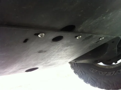

I looked at both Slee and BIOR, why does the Slee have so many holes in it? Seems like they may get snagged on something...
Access to certain bolts and also for drainage (mud)... and possibly holes for cooling. But I think the pictures on his website are of the old model. Some of the position and sizes of holes have changed.
