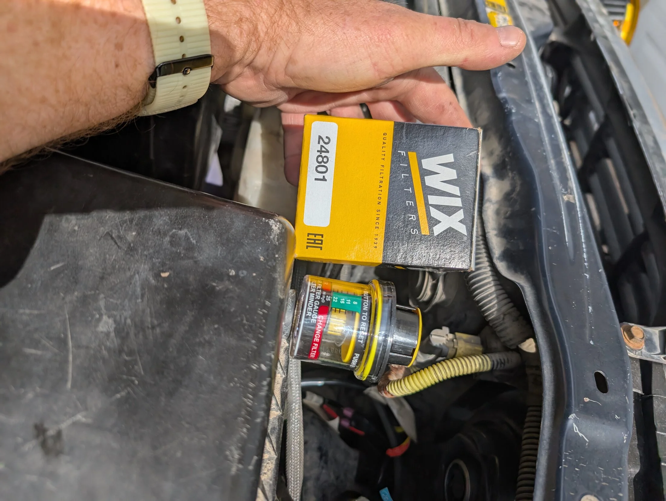

I am hoping that by lengthening the intake with my snorkel it will help maintain a smooth air flow. Unrelated but relevant I also just added an air filter flow restrictor gauge to help keep an eye on things. Wix part #24801, requires drilling an 11/16” hole in the top half of the air box.

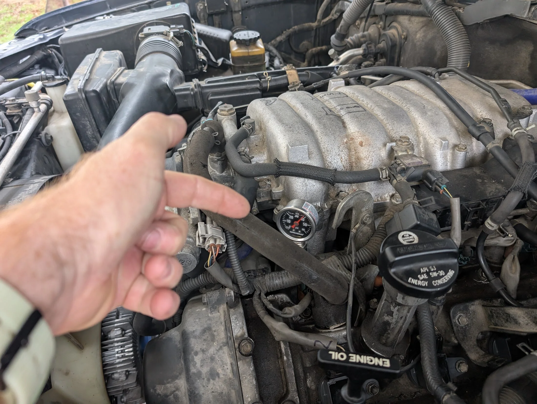

Nice FP gauge. Is it permanently attached, or was it just a picture during a leak down test.
The truck was running poorly and i did some maintenance which included permanently installing the fuel rail pressure gauge.
I came back from a couple thousand miles off-roading in Mexico with a misfire. I apparently picked up a tank of bad gas and blew the iridium tips off of my spark plugs. I replaced the coil packs and plugs, and then decided to check up on the whole fuel system.
I don't think the bad gas ruined my fuel pump, rather it has been going out for a while, which manifested as two long crank hard to starts over the course of a week. So I went ahead and replaced a bunch of fuel system stuff which included the gas cap, fuel pump, fuel sender gasket, fuel filter, fuel pressure regulator, fuel pressure dampener -- all OEM parts except for the fuel pump. I was getting 31 PSI at the fuel rail, and as seen in the photo I'm now getting 43 PSI. Also replaced the air filter and the fuel trim temperature sensor.
