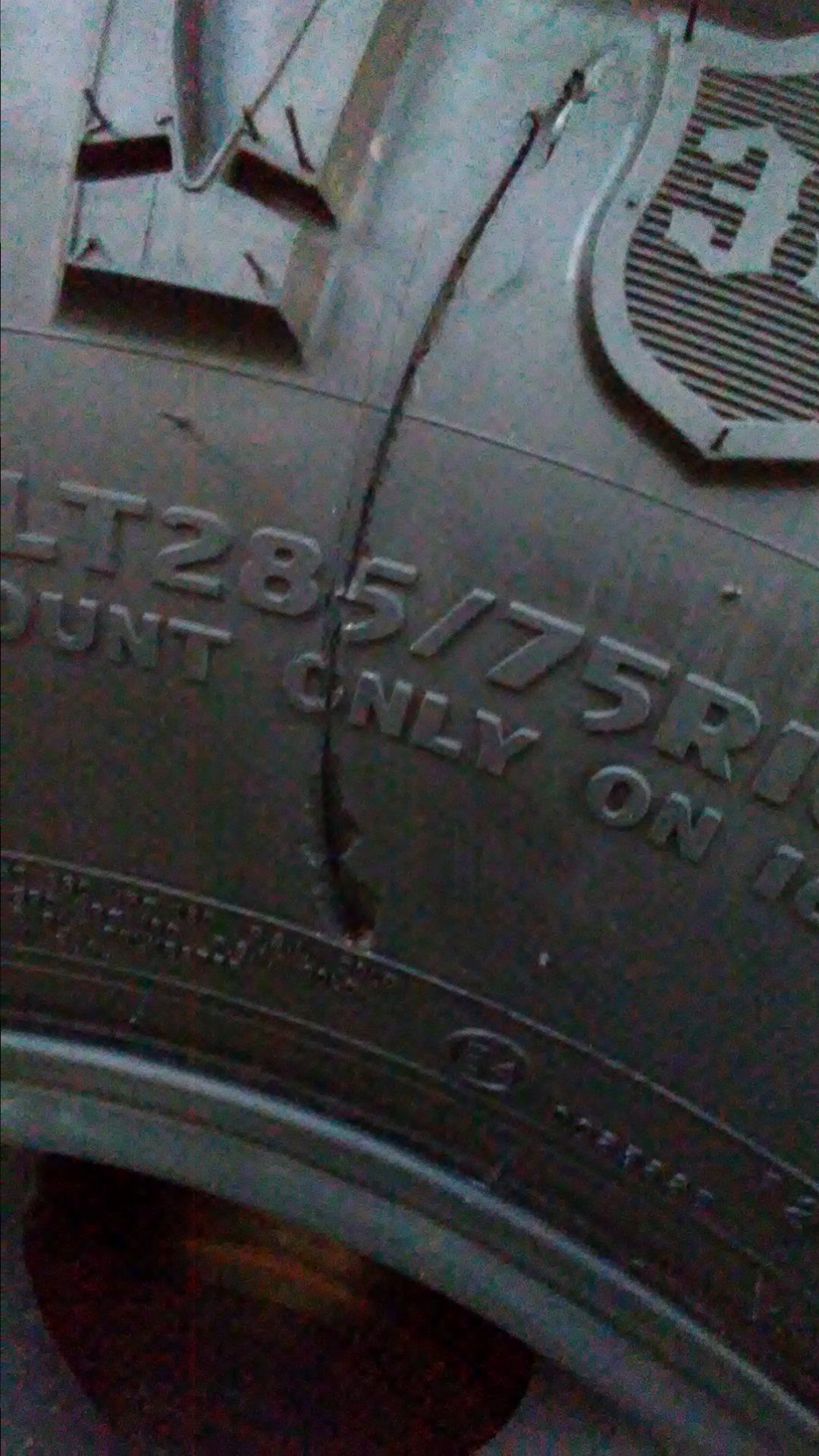

New 285/75/16 Mickey Thompson Deegan 38's. Was wheeling two Sunday's ago with some FJ and 4R guys and sliced one of my tires. Nothing crazy as far as sharp rocks go, just mud and river rocks. No matter, it happened. Love the tire but now I'm rethinking running them for rocks etc. Has me thinking a trip to Colorado would cut them up. Anyone else have issues like this with the tires they're running? Opinions on toughest sidewall tire?
For a narrow slit like that, it would've been something pretty sharp. Different manufacturers have different "technologies" for sidewall durability, but aside from steel-steel commercial tires, many won't hold up to extremely sharp cutting objects. Abrasion sure, but cuts can typically ruin almost any sidewall.

Looks more like a 'split' to me than a cut.
For that to be a cut it would have had to of been something extremely sharp.
I'd have that tire evaluated at a tire shop.
Looks like a cut from a rock... lower part where the rock tore in, then split the sidewall.
Hmm.....so by "split" you're thinking possible defect?
Don't know.
Just doesn't look like a cut (all of it) to me. The bottom part looks like a cut/chunking from a rock or something, but the rest (except the very top) looks like 'stresses' split the sidewall. Its just so symmetrical and thin. A tire store 'might' surmise that the tire should have held up better, I don't know.
They see enough of that type thing to determine whether it was actually 'cut' or if it split (stress) and if the tire performed up to standard or not. Can't hurt.

The cut isn't deep at all. Looks mostly cosmetic.
Looks like a cut, not a defect to me. Unless you have road hazard warranty I'd be surprised if that's a warranty thing. At least one review of this tire (4waam.com) talks about thin sidewalls, bulging sidewalls, and questions about rock durability. Are you running with a matching spare, or just the 4 tires?

I think the first major step you could take would be to start airing down every time you go off road. I think any tire, no matter what brand would have a chance of cutting a sidewall at 45 psi on sharp river rock. The benefits of airing down are numerous, one of which is greater resistance to cuts on the sidewall. Also, the ride is going to be so much better going over rocks.
Seems strange that it is so perfectly perpendicular to the tread. And unless BFG changed, I'd hesitate to put them in the strong sidewall category. And aren't river rocks usually rounded?
Perhaps it was there prior to installation? Kinda looks like damage that could happen from packaging straps.

I think this kind of damage is sometimes seemingly random. I've come back from Moab area (not known for sharp rocks) trips with some pretty puzzling surface cuts (not fully through), and even some real punctures. Sticks, roots, and branches can kill a tire too. I lost a Toyo ATII to a tiny piece of pinion through a small sidewall puncture. Although I still think airing down is the best thing to do, sometimes airing down just puts that weaker sidewall closer to the hazards.
Airing down notated for sure; and looking at the chunk/slice is a bit perplexing. Seems if the tire is rotating the cut would be horizontal, not so vertically extreme as it is. Almost as if the chunk caused the sidewall to split.

Had Kauffman Tire examine the cut and notate the findings on my receipt for the Deegan 38's. Completely cosmetic and none of the damage has affected the integrity of the tire itself.
