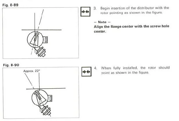

Had spark to dist. and to plugs, fuel in the bowl... turns over but thats all. I switched the wires opposite in case it was 180deg out. Nothing. Managed to find TDC without removing the alternator again, and re-removed the dist. again. If this is correct, I was about 55deg out or something. Anyways I have reinstalled and it is aligned as per the pics in the link (fig. 8-90) and will put everything back on and try again in daylight.

Hm I think I can bump it like you say with how I have it set now to try and confirm. I jumpered the starter when I did the compression check so I could control it from under the hood. I should be able to do the same with my thumb over the hole. With the dist. still in place make sure it points to 1. Thanks guys I'll give 'er a try!
