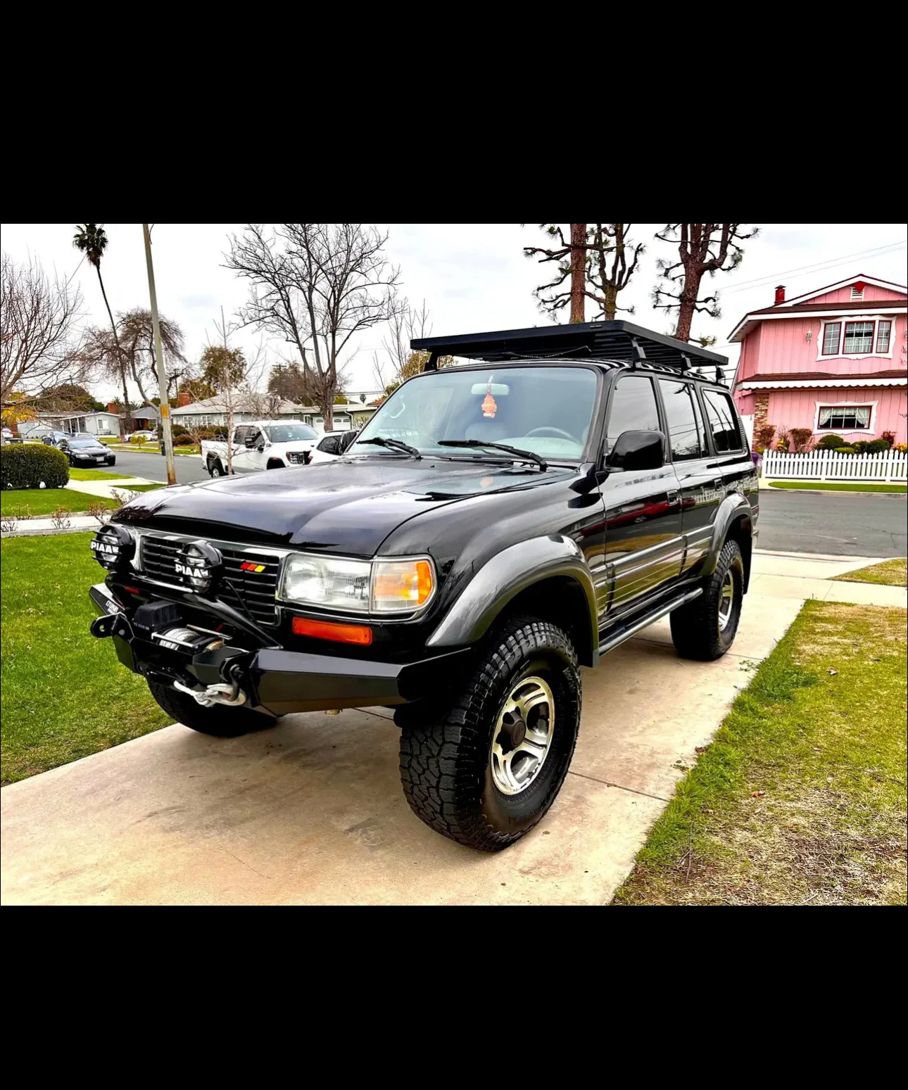

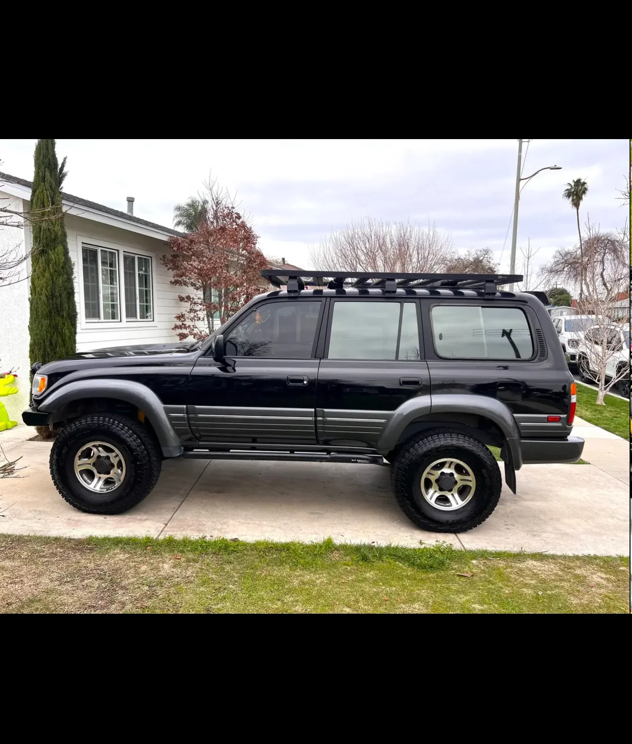

They’re asking $27,500 for it with 221,333 miles. Everyone I’ve talked to says that’s too much given the mileage, or they say it’s a Lexus so the maintenance will be expensive. What do you guys think should I buy it or keep searching? Also, apologies in advance if I posted this in the wrong forum—I’m new to this whole forum thing.
Here are some of pictures of the car:
