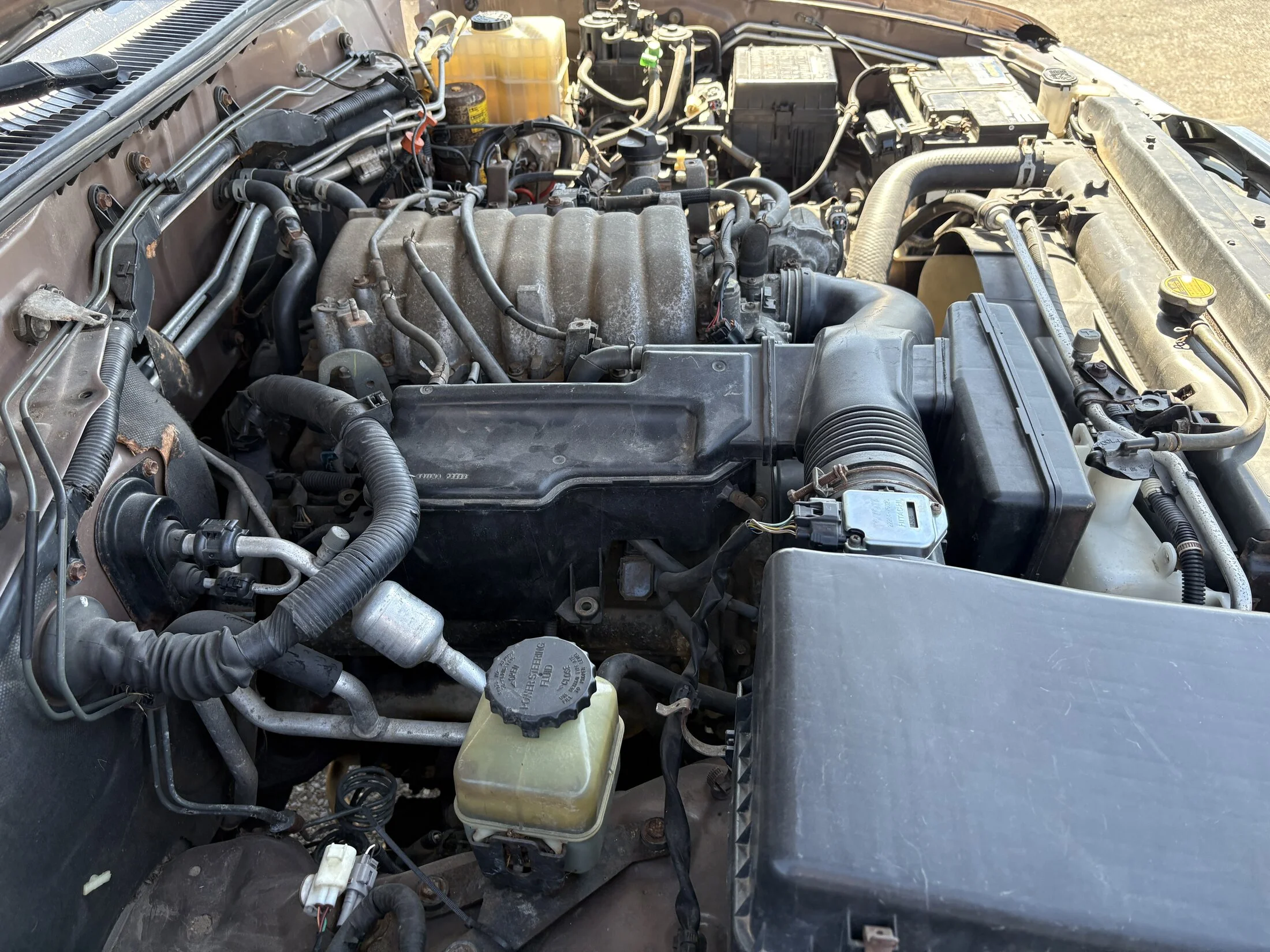

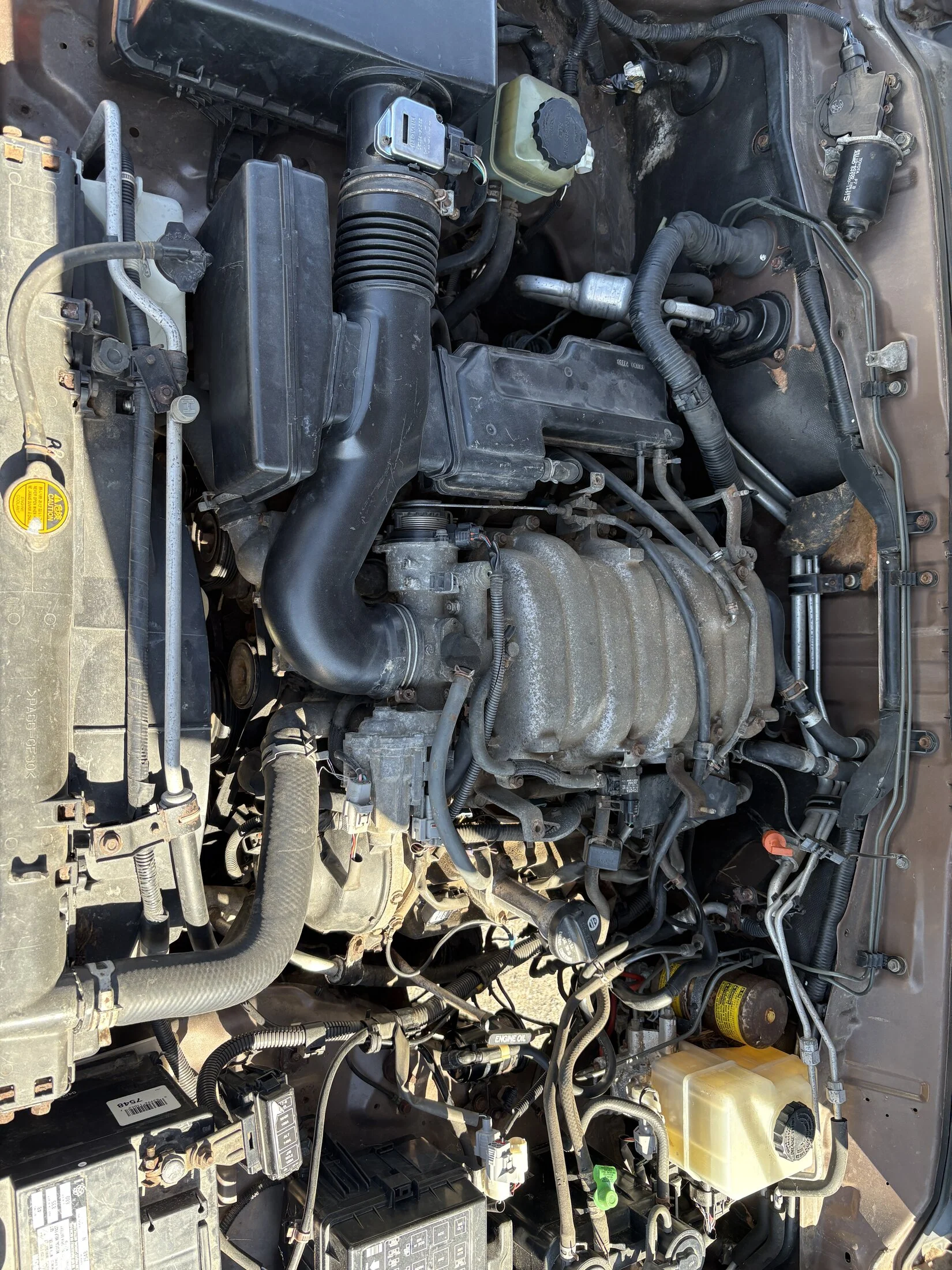

Any pics of engine bay, brakes, and suspension?
Sure do! Engine and a few undercarriage photos as well!

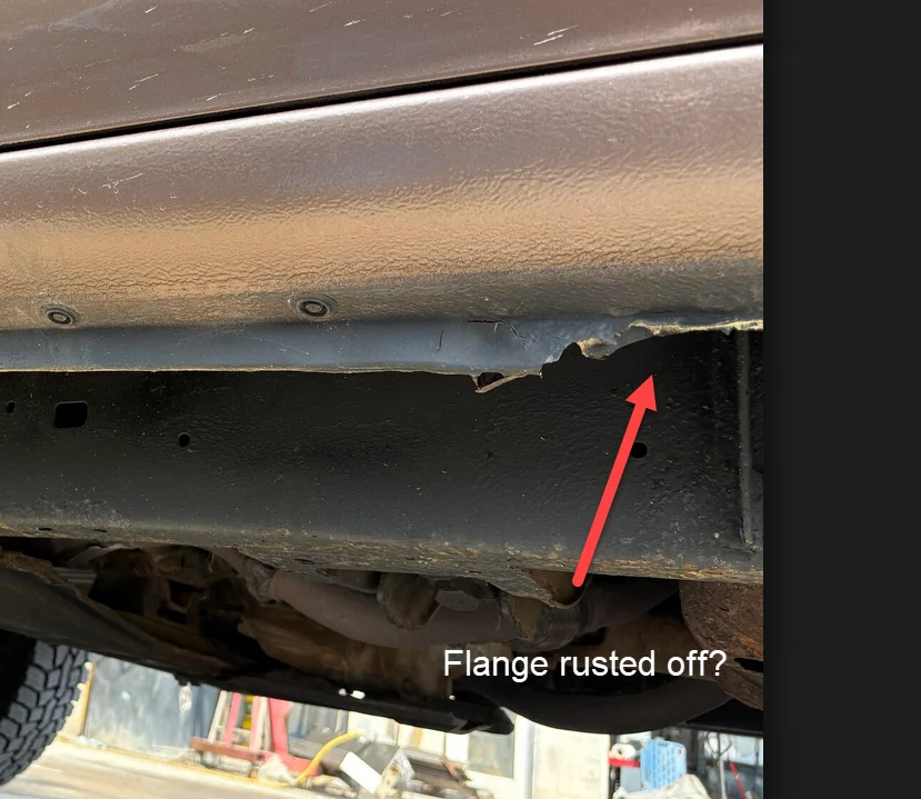

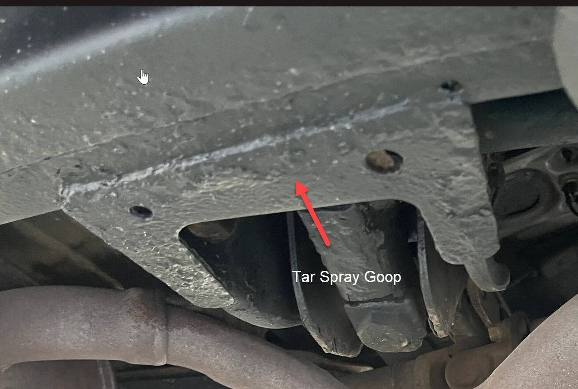

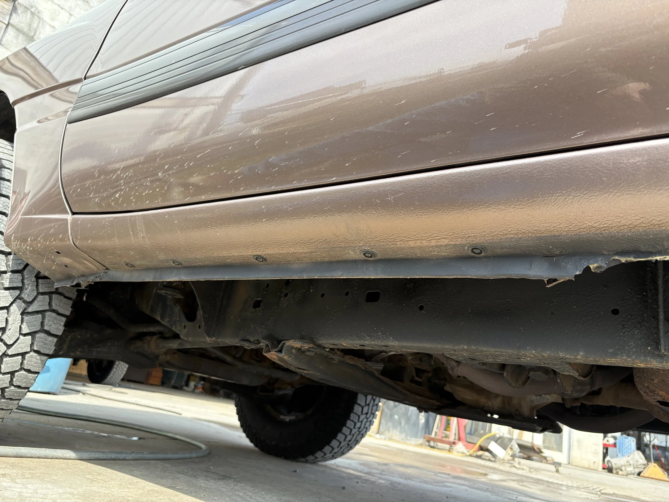

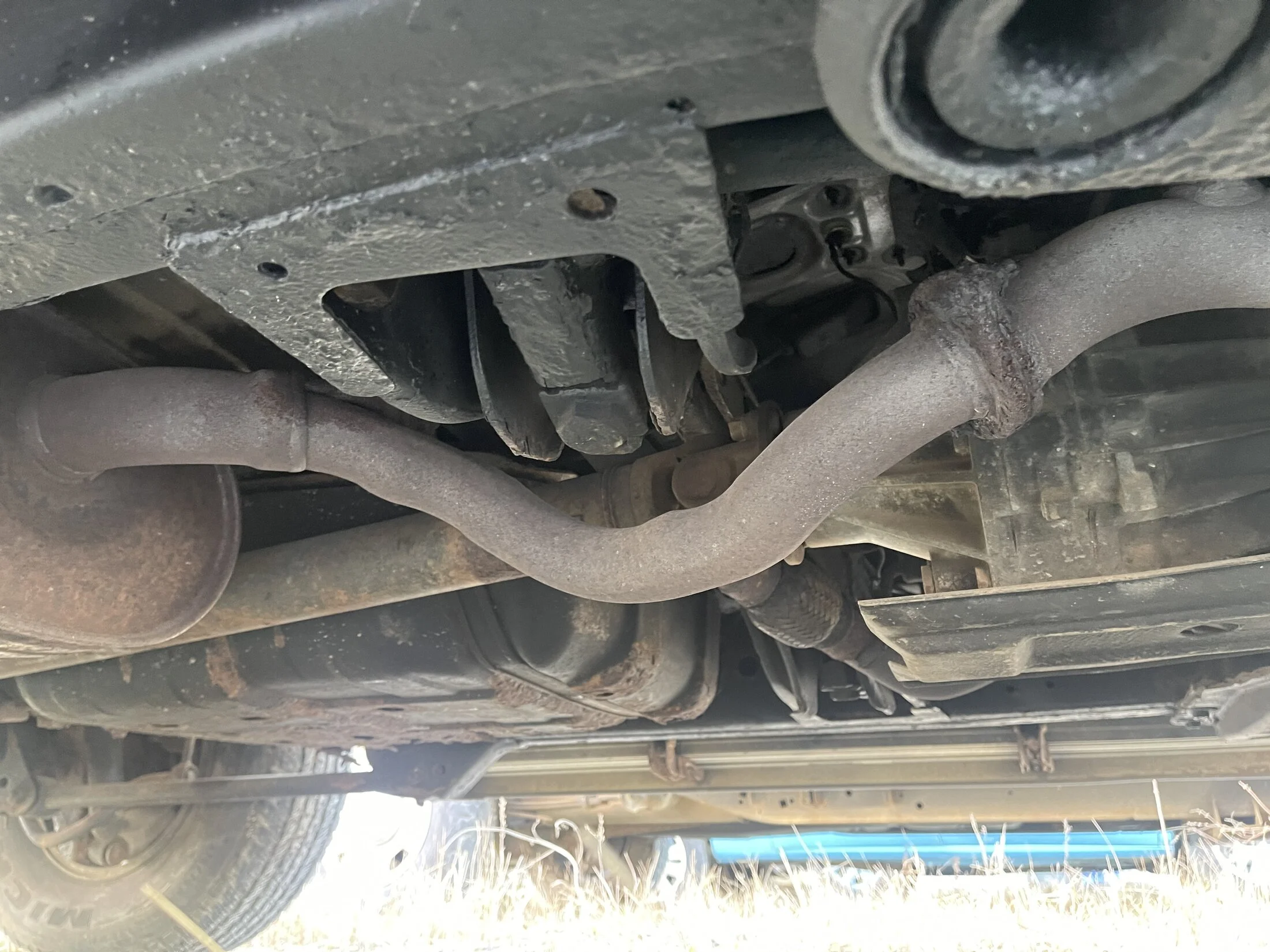

If it were stored outside in Illinois, the brake rotors would have been destroyed from rain/snow/moisture. But, I see some underside rust and some tar/spray crap on the frame, so don't buy this without a seriously detailed underbody and suspension rust inspection.
The brake fluid looks suspiciously clean, unless someone just replaced it.

Thanks for the tips. The Toyota dealer is fixing what we think is a fuel line issue before we move forward, and I am having them perform a pre purchase inspection while it’s there. Anything besides underbody and suspension that I should ensure they thouroughly check?
Looks like most of the bolt heads in the engine bay are rusted, the aluminum on the motor appears corroded, def some rust underneath and looks like someone tried to paint over frame rust?
Unless the dealer smacks the frame with a hammer, I wouldn't trust their rust inspection. This hammer smack method is how you see if there are holes in the frame where the rust just hasn't fallen out yet. You can also use a screwdriver to poke/gouge the weak areas. Will the dealer let you into the service bay to look underneath (along with them)?
Now that you say that. I think so. Is this the typical texture the bottom of the doors? Or has this been tar sprayed and painted?
They’re 5 hours away, so that’s probably not an option. I can request photos though, if that’s what you advise!
Those photos don't help. I live down south (TX) so frame rust isn't something I see or deal with. If it's as bad as it appears I'd have to walk away.
