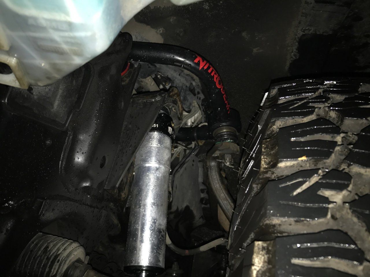

Thanks. I always was curious how much caster the Nitro's would provide. Looks pretty good. Do you know if there is any room left on the cam adjusters to give any more caster? Small bump on the top of the camber plate will be centered or rotated to one side.
