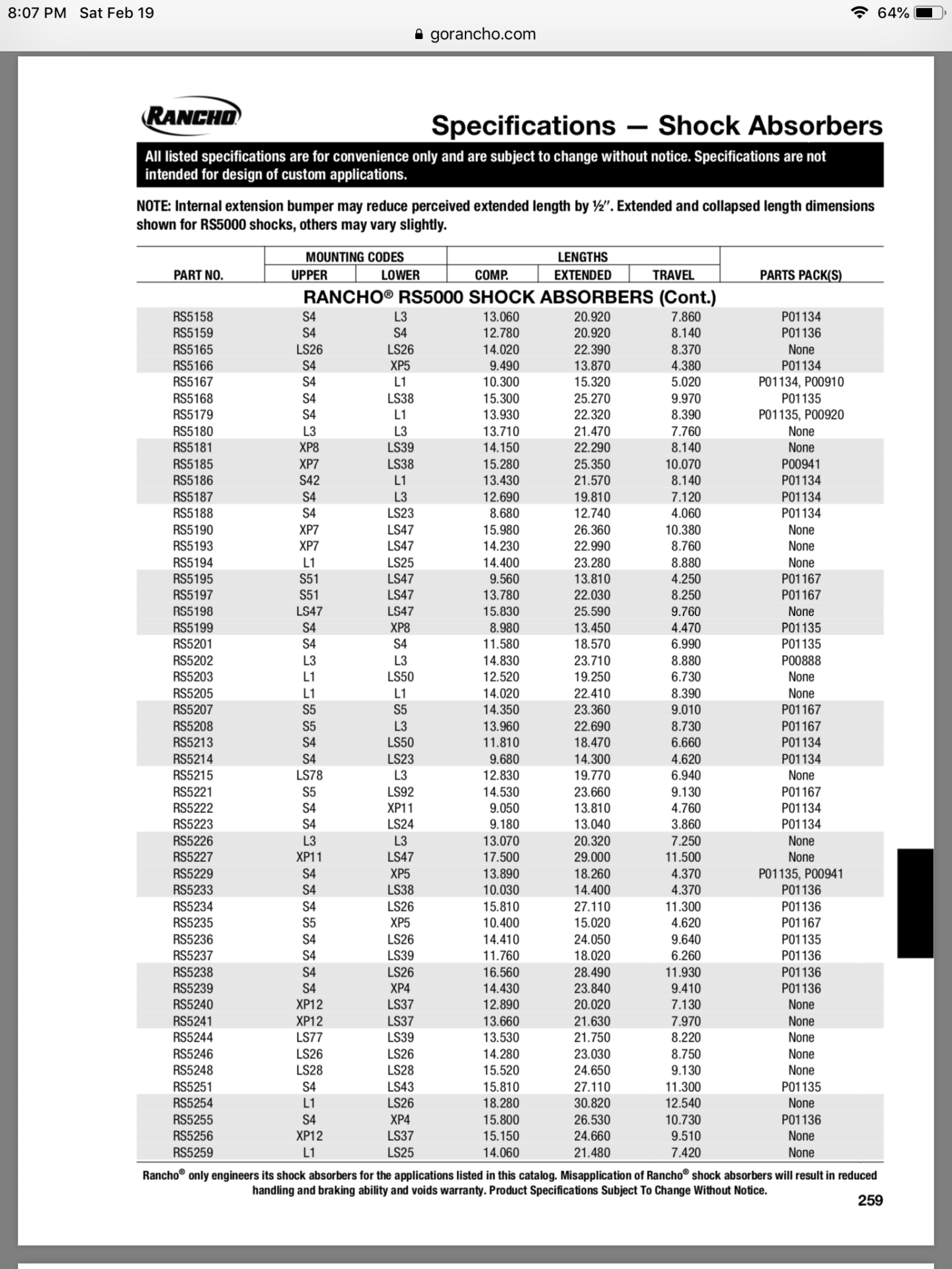

I have a 72, SOA, spring flip, running 37s. I added the Ford front shock towers years ago and here's what I have. The Ford front shock towers were from Ford Direct Online, part # E5TZ18183A. I coupled that with Rancho RS9000s front and rear. Front is RS999012 (19"-32") and rear is RS999112 (16"-26"). I love the articulation this provides me!
