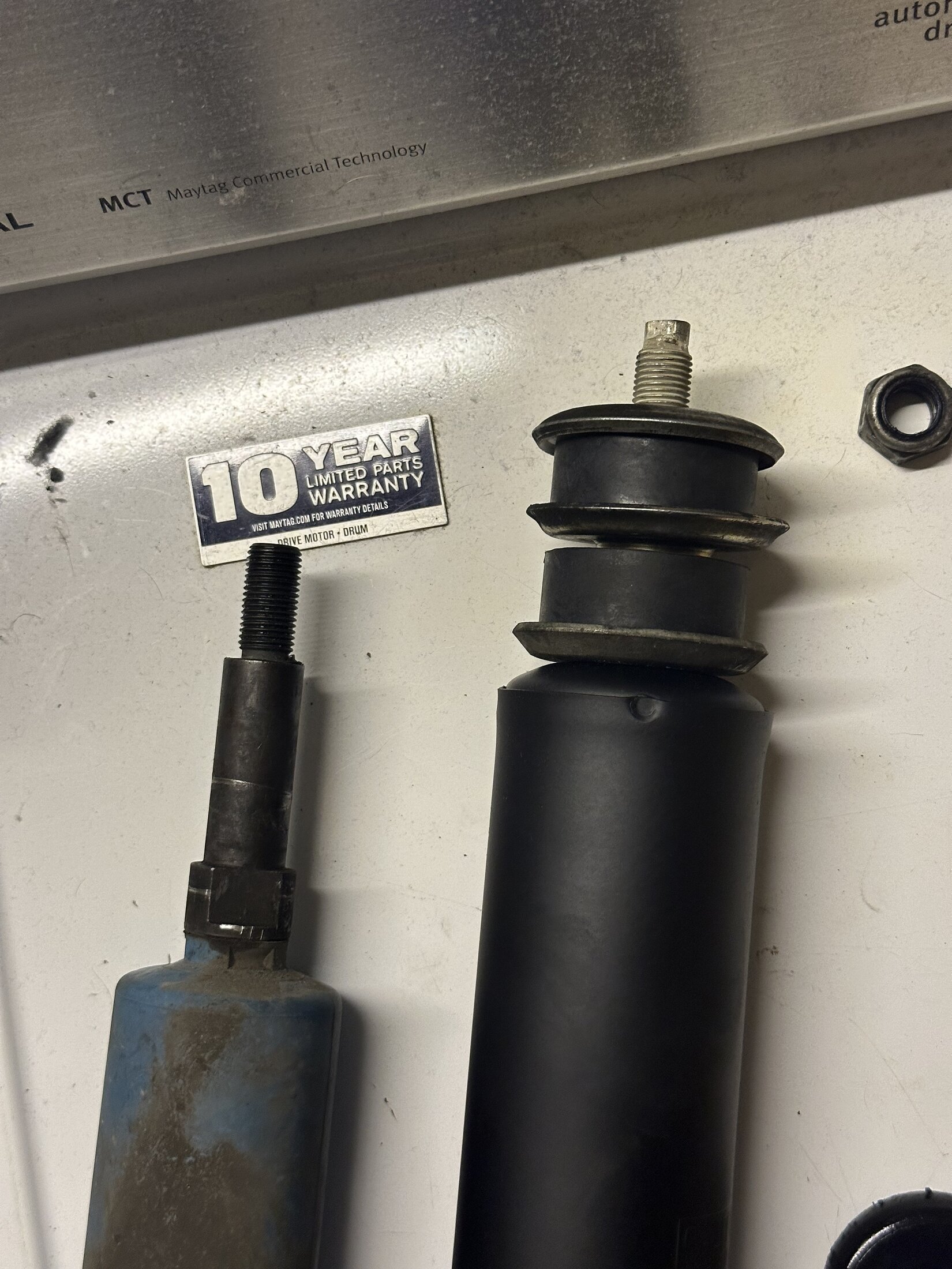

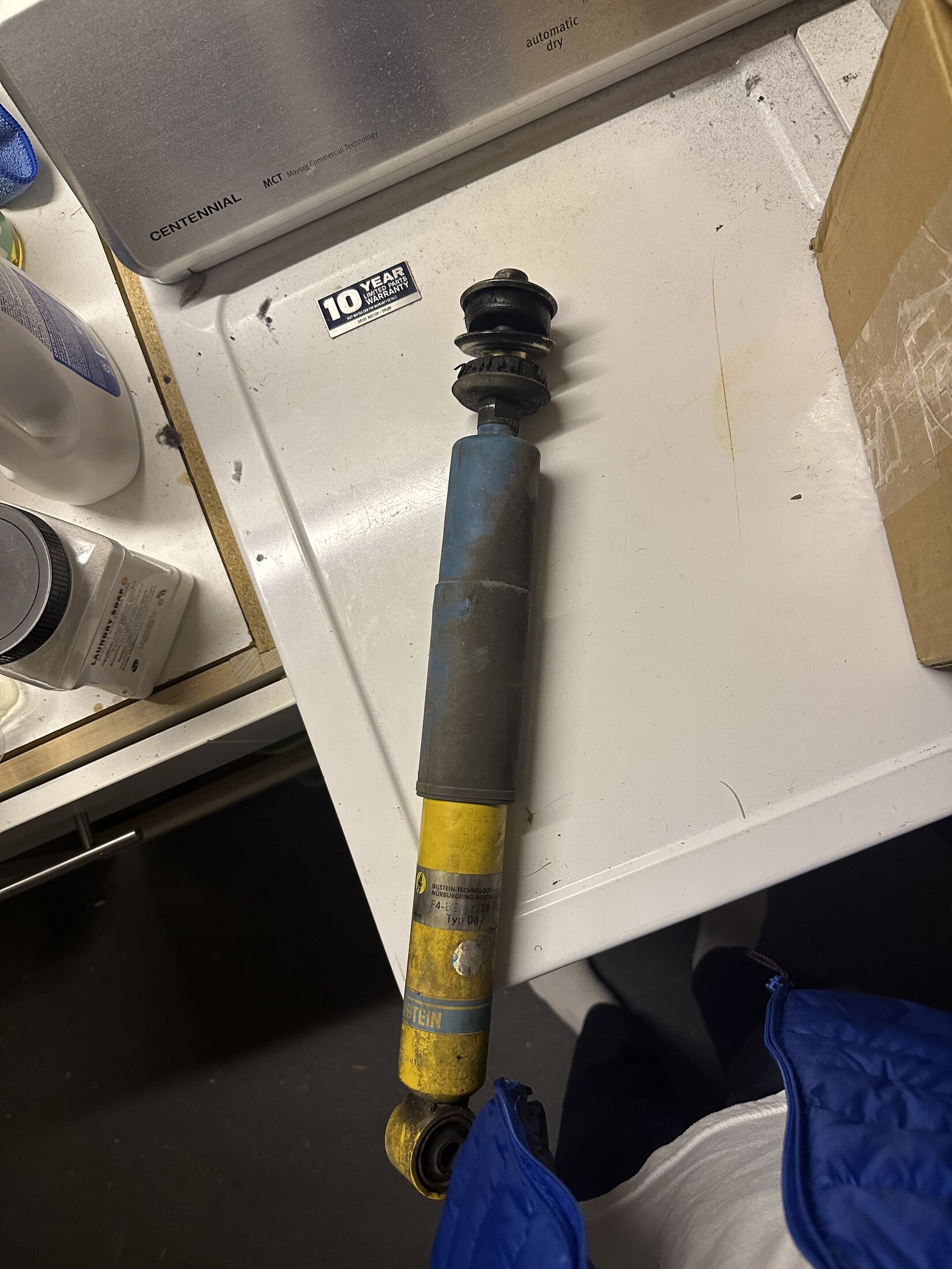

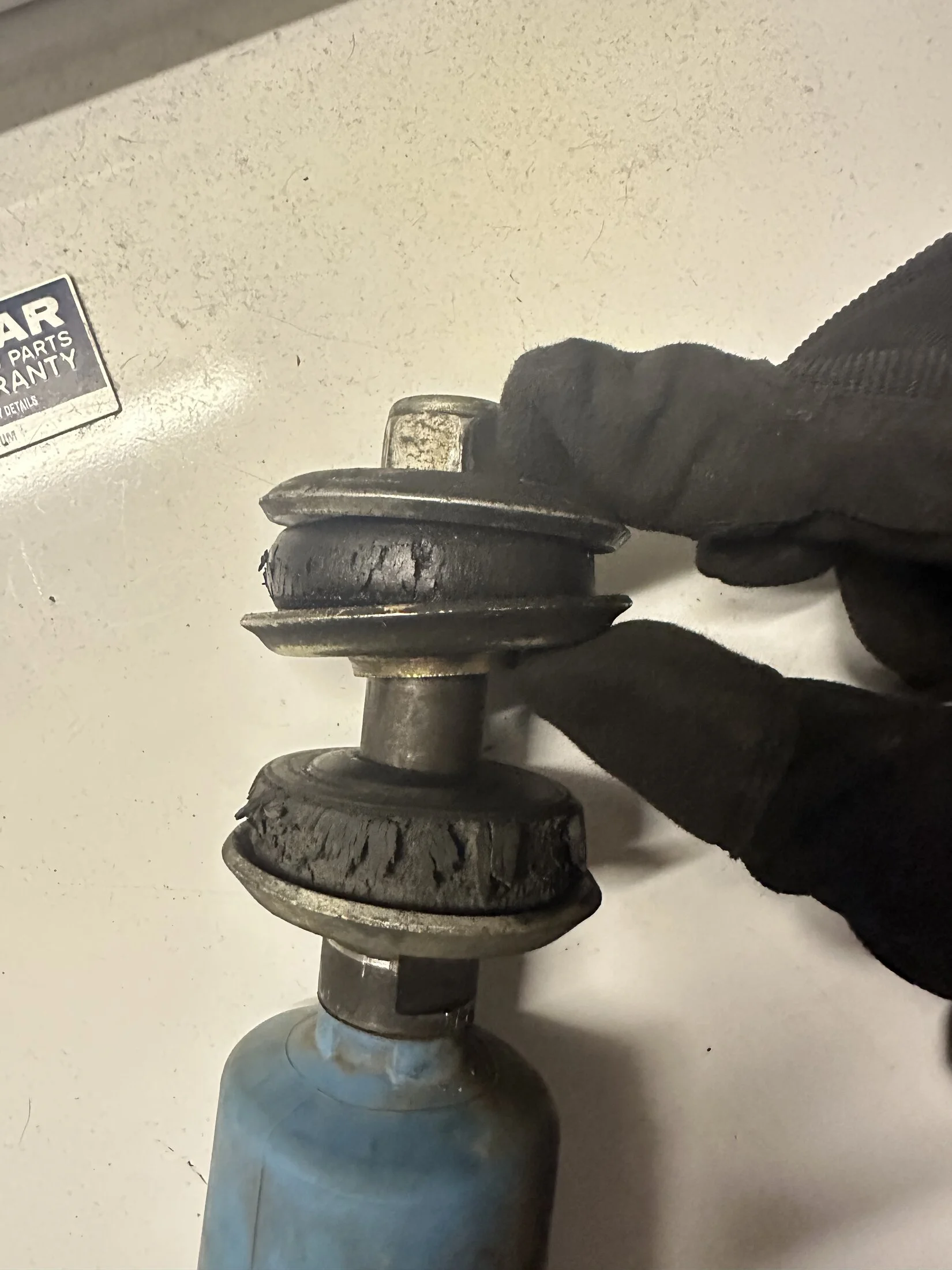

Everything was going smoothly until I found that the Bilsteins only had three metal retainers on the rubber bushings. I was expecting 4 total per shock from the videos I’d watched. You can see in the attached pictures what I’m talking about. Like a top bun missing on the bottom rubber sandwich lol.
The OEM Toyota shocks do not come with the metal retainers. Just the rubber bushings. So the plan was to reuse the existing retainers. Do I need to track down a 4th retainer? Or just install it how the Bilsteins were installed, with three? I can’t really find video or images of how OEM shocks are supposed to look in regards to the bushings and retainers. My mechanic mentioned that the suspension was not valved correctly during an inspection a few months ago, and maybe this is what he meant by that?

I don’t think they’re difficult to track down.. they’re just a bit expensive for what it is. A dealer can get them

They are $8.39 ea from partsouq.com. Fill up your cart with other things to make the shipping worthwhile, or pay a bit more from somewhere else.
