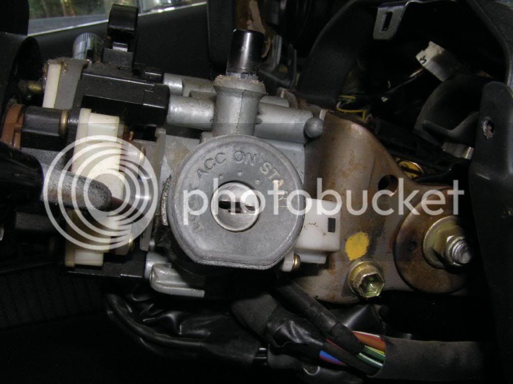

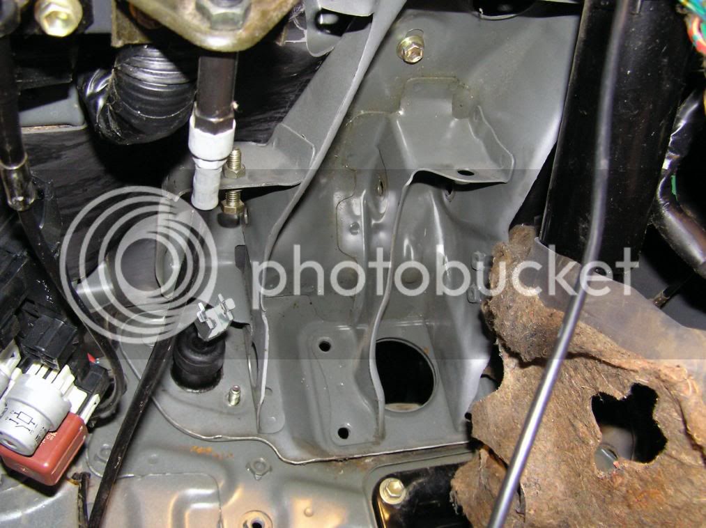

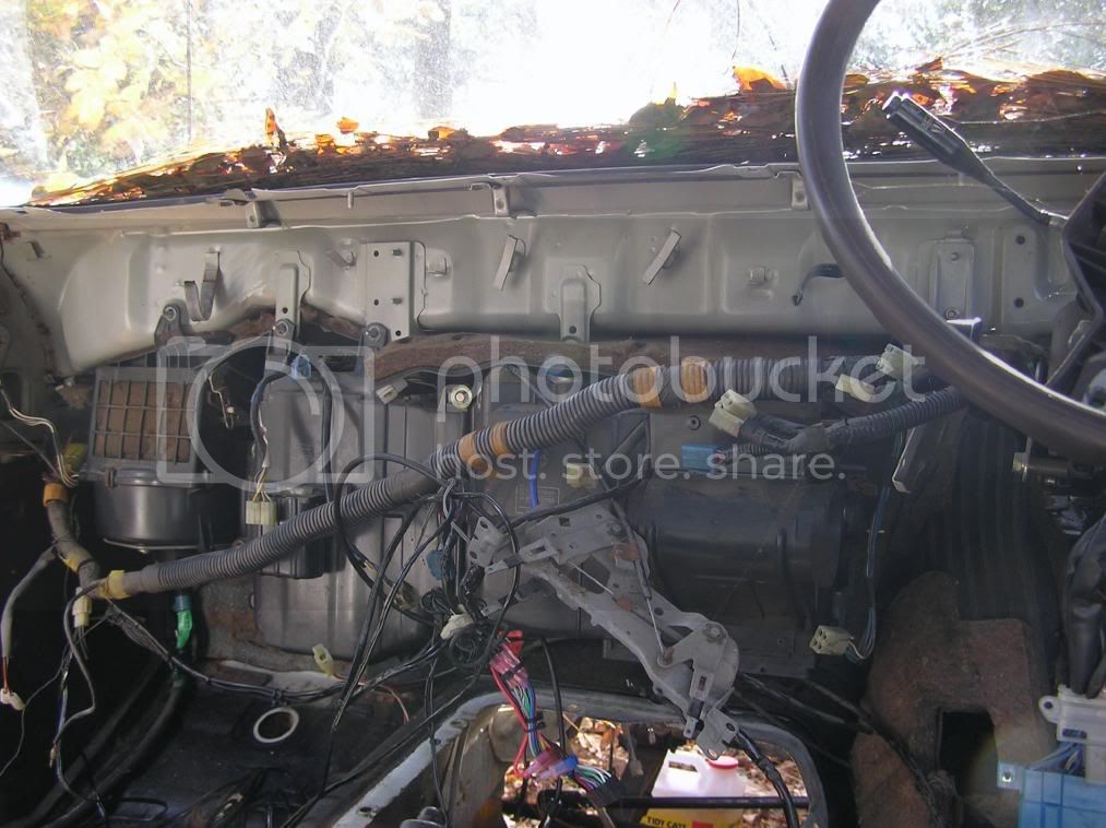

Installed the pedal bucket. It went in easier than the original one came out (no pedals :idea::rolleyes:). Drilled holes in the firewall for the c.m.c., uneventful. Put steering column back up, installed the c.m.c... half-hour job, 20 of which was getting the two bolts in at the top of the pedal bucket. That's a hard job without removing the defroster vent, which is even less fun, yikes.

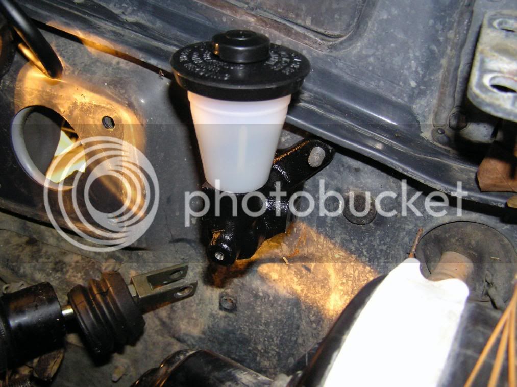

Slap your MC from the HJ on there and bolt up the brake pedal to it. Clutch pedal might bolt up as well ;)

And why do I need the MC from the HJ, as opposed to just using the FJ's? Are they not the same? How about the booster? Which one should I use?

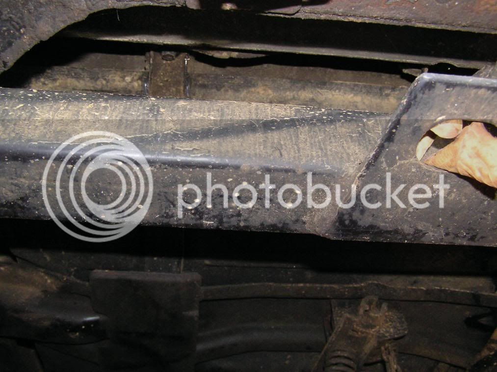

Crossmember in. Pedals in.
I had to use a combination of 3/8" and 7/16" x 3" long, grade 8 bolts to mount the crossmember in its new forward location. I drilled through the frame for this, which required a new tool, a close-quarters right angle drill (bought the Ryobi cordless).
I like this installation better than welding the crossmember in place.
Edit forthcoming to add pictures tonight.

Any pics of the crossmember?
