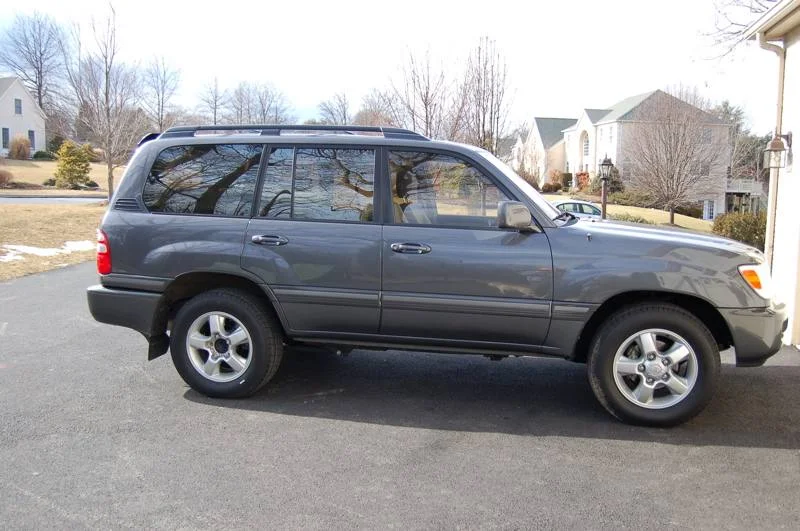

    Not a banner mod-day today. Original plan was to install Bilstein HD shocks and remove running boards. While removing the back tire, the last bolt that I was removing would not turn after it was backed out about ½ way. I tried to tighten it again to see if that would free it; however, it would not budge. So in my infinite wisdom, I decided to man handle it, grabbed the cheater bar and began unscrewing again. Next thing I know, I have a sheered off bolt on my hands. So can anyone tell me what I need to do to fix this fiasco?
    I was so pi#### that I stopped the shock mod and removed the side steps. I guess it is not a total loss of a day. LC looks tons better with steps removed. Ordering slee slider steps on Monday.

    ....but it does look nicer w/o the running boards. I like that color too

    Looks great without runnibg boards!

    Way better without the boards! :cool: Sucks about the stud though. Should be fairly simple to fix though.
