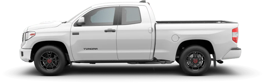

I have to wonder though why not start with a Tundra or even a Sequoia as the base? IIRC the Tundra is available in Australia now. (Perceived) durability I presume? I know LC parts tend to be even beefier than the Tundra/Sequoia but those vehicles are definitely not slouches

Yes, curious as to the answer here. If you start with a Tundra you could do a lot of reinforcement of the frame and other components for much less than the chop I would think.
They don't start with the Tundra in OZ for these because the Tundra isn't available there.

With Tundra availability here, I can't see the value in cutting up a 200-series. The Tundra is certainly the easier platform to start with. Maybe a nicer 1794. Surely miles cheaper! It's got some benefits between the stock longer frame, larger capacity rear axle, optional 38 gallon stock tank. It is missing key things like full time 4WD. That may be easier to retrofit with a bolt on transplant of a cruiser transfer case. No KDSS or ATRAC, but can be done old school with bolt on lockers and upgraded suspension.
Toyota doesn't sell it directly but it is available via import apparently

Based on the prices in the article of over $100k for a RHD converted pickup, chopping a Cruiser starts to look economical :oops:
For what we pay for a Tundra here, I doubt it would be economical - a base model Ram 1500 is 80k here and that's about the cheapest US Truck we can get.
Secondly, the tundra doesn't come with a diesel which limits fuel options out in the sticks. This should be an interesting build I think...
I haven't watched this video yet to know about the 200, but I know a lot of the other 200 chops are diesel. So I'd assume they do the 200s for the range and fuel availability compared to a Tundra.

If you've been under a tundra and a cruiser, you'd see that they're completely different frames and builds. At the most basic level, the open c channel used in the Tundra frame is a pale comparison to the fully boxed frame of the land cruiser. They also have completely different rear suspension systems. I don't think people are comparing apples to apples when trying to relate a land cruiser chop to a tundra. And I don't have anything against the tundra, they're for for a purpose, but they aren't built like a cruiser.
Easy now. Even though I completely agree with you, some folks on here think the two frames are similar.
