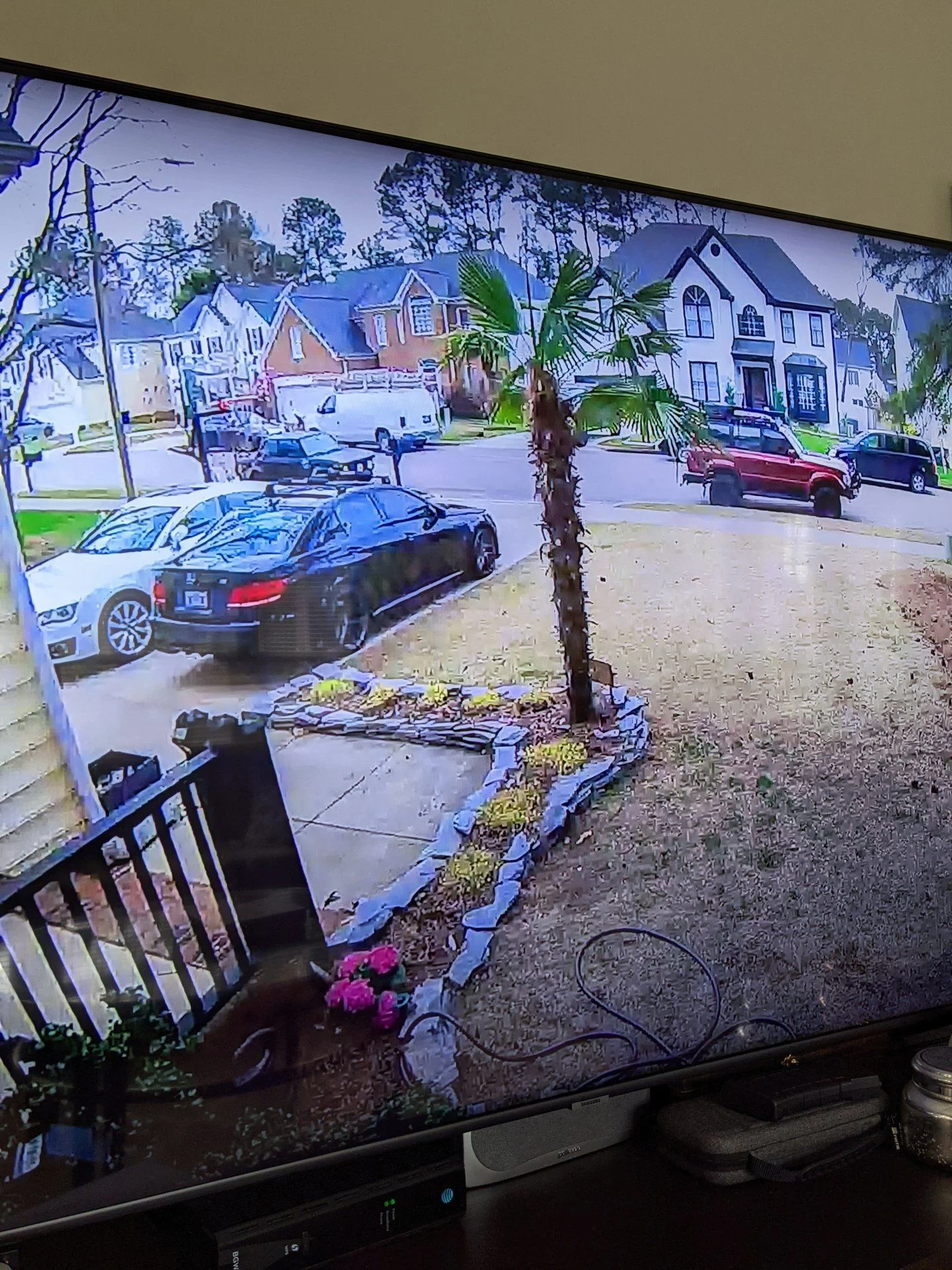

I actually got toyota to trailer it back home for me! Only 6 miles away... So for now, she sits...
I actually got toyota to trailer it back home for me! Only 6 miles away... So for now, she sits...View attachment 2623882
