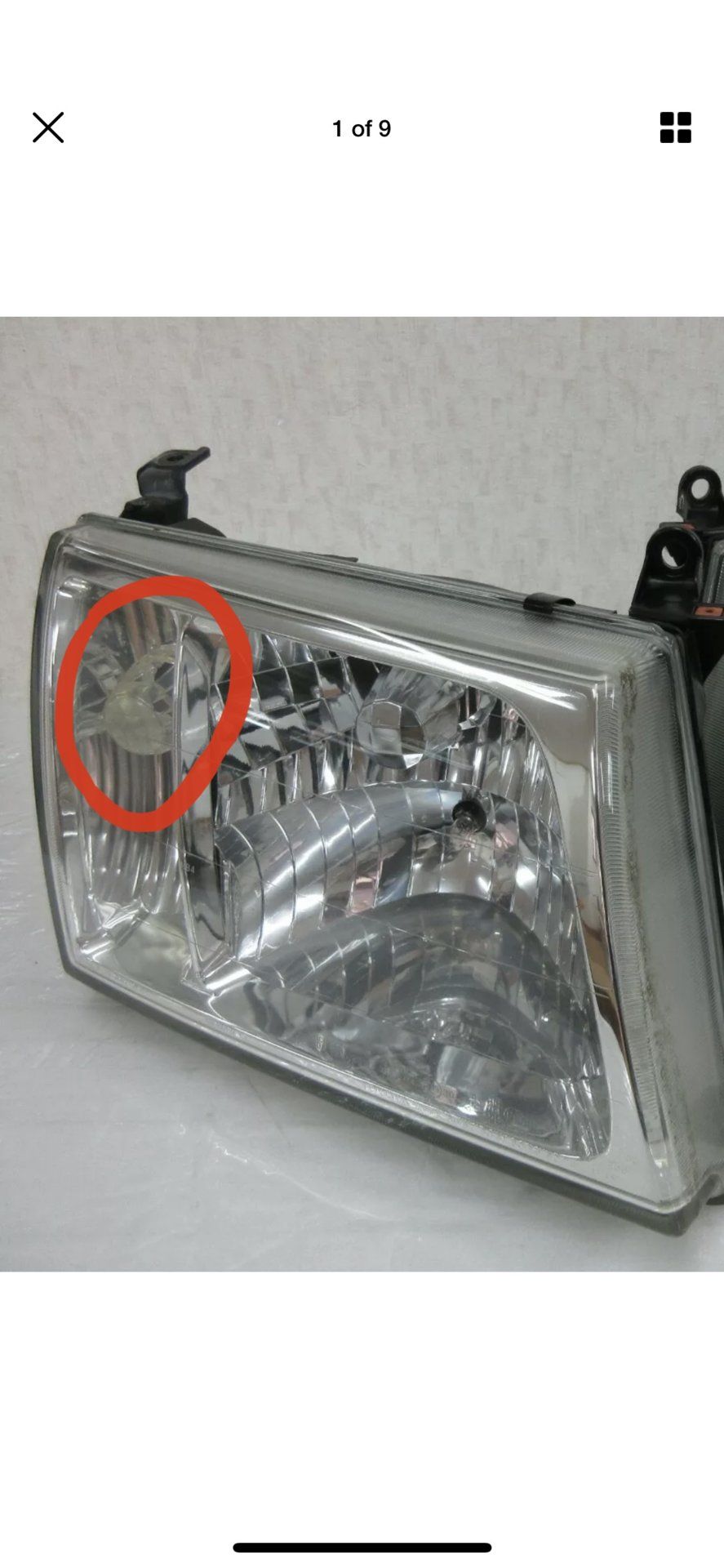

What is the name/function of the bulb here? I think mine are both burned out so I cant figure out what they're for.
Why do you think yours are burned out? I believe that is the flasher for the turn signal but could be wrong.
That could be, I think I assumed the turn signals were in the corner housing w bulb 1057A. The bulbs that occupy the space I circled are very small
True... just realized that as I looked at the picture more.. they could be the running lights as well which would be more applicable as you did not mention having the "super speed blinker" when you used the turn signals.
Will have to take a look at mine in the dark tonight to see what exactly they are.

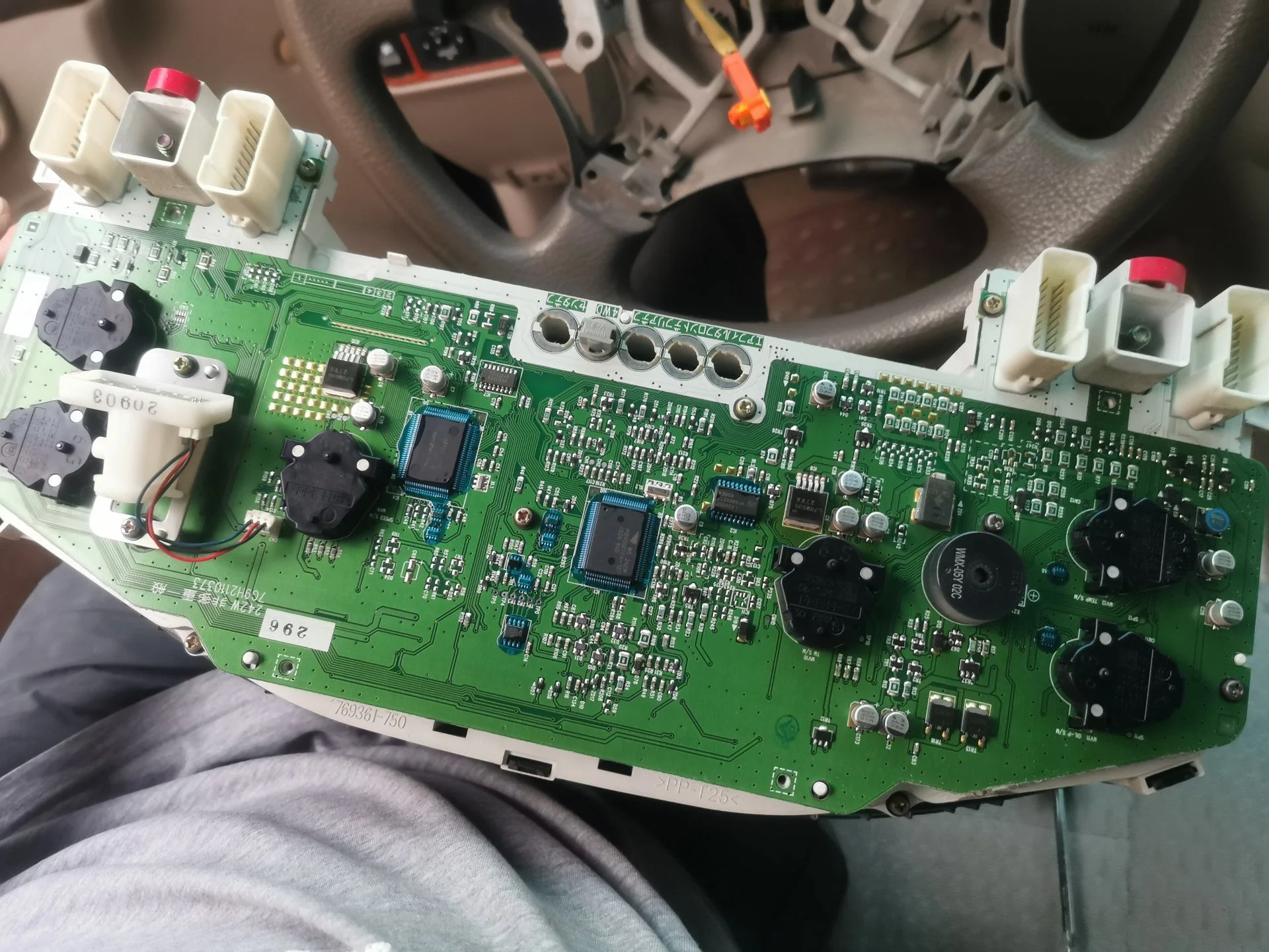

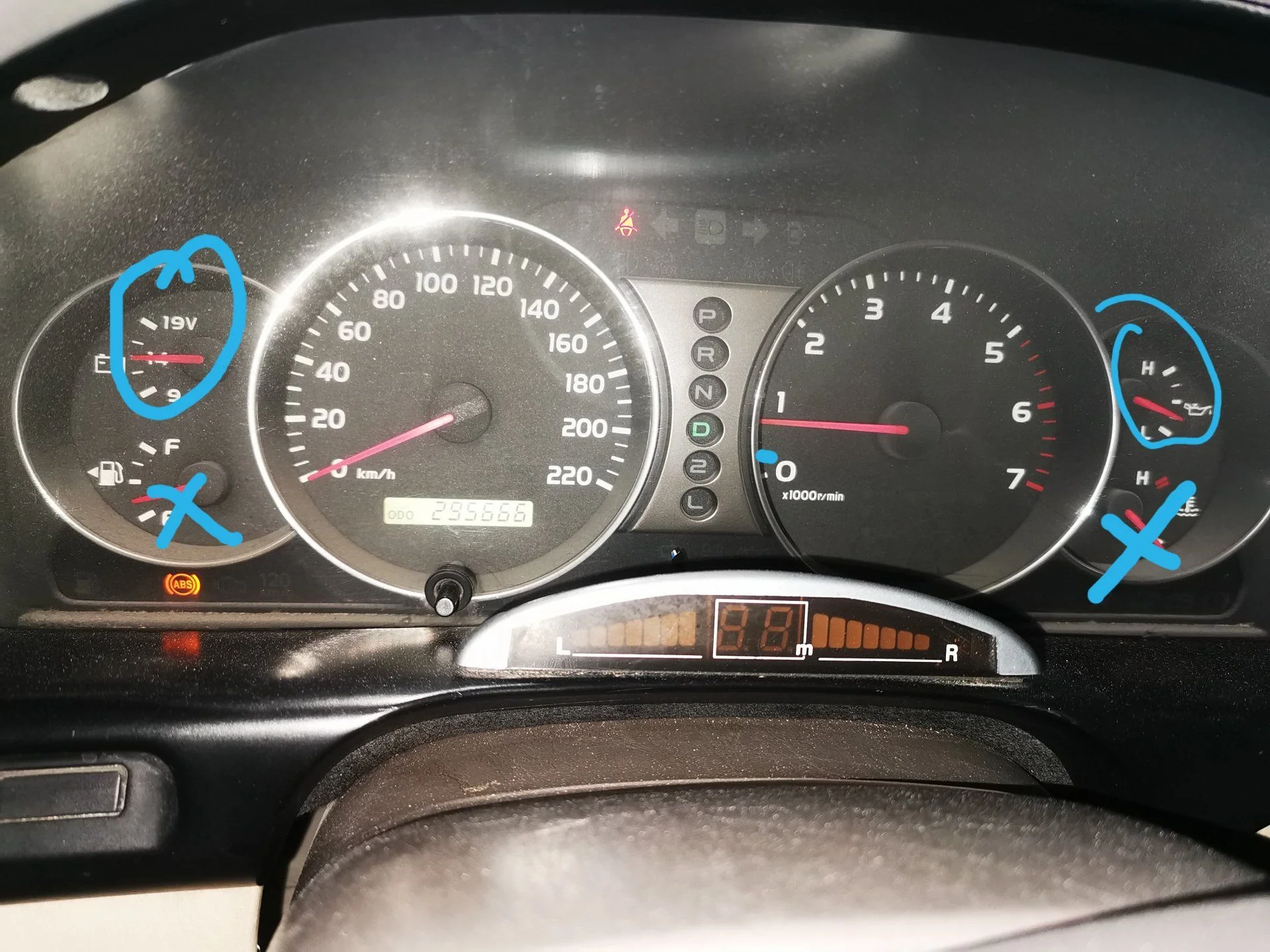

can anyone please tell where are the leds lights for my gxr 2003..? i ordered t5 from ebay but was surprised to see there were no bulbs inside the speedometer maybe it have leds? my oil gauge bulb and alternator gauge bulb are not working and for fuel and temprature also the bulbs are so fade..encircled gauge lights not working rest all so dim.. please help
