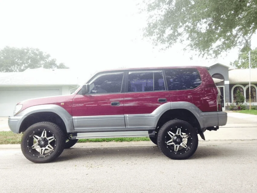

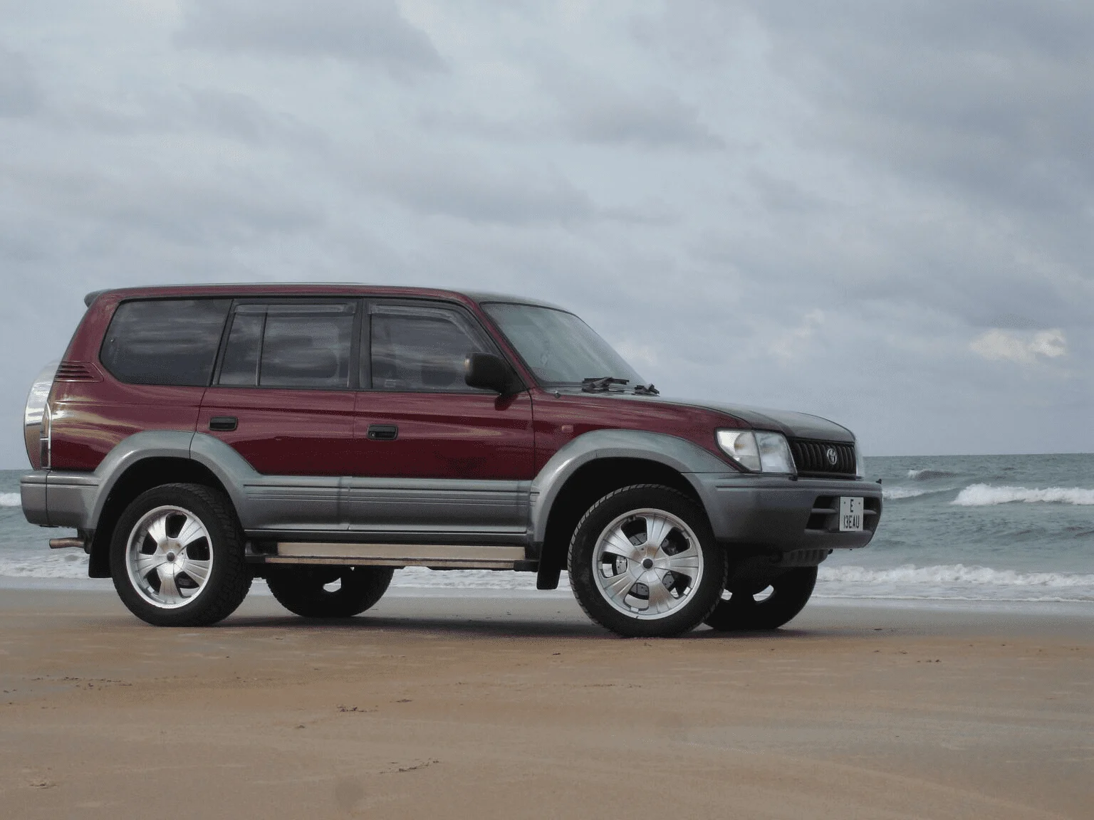

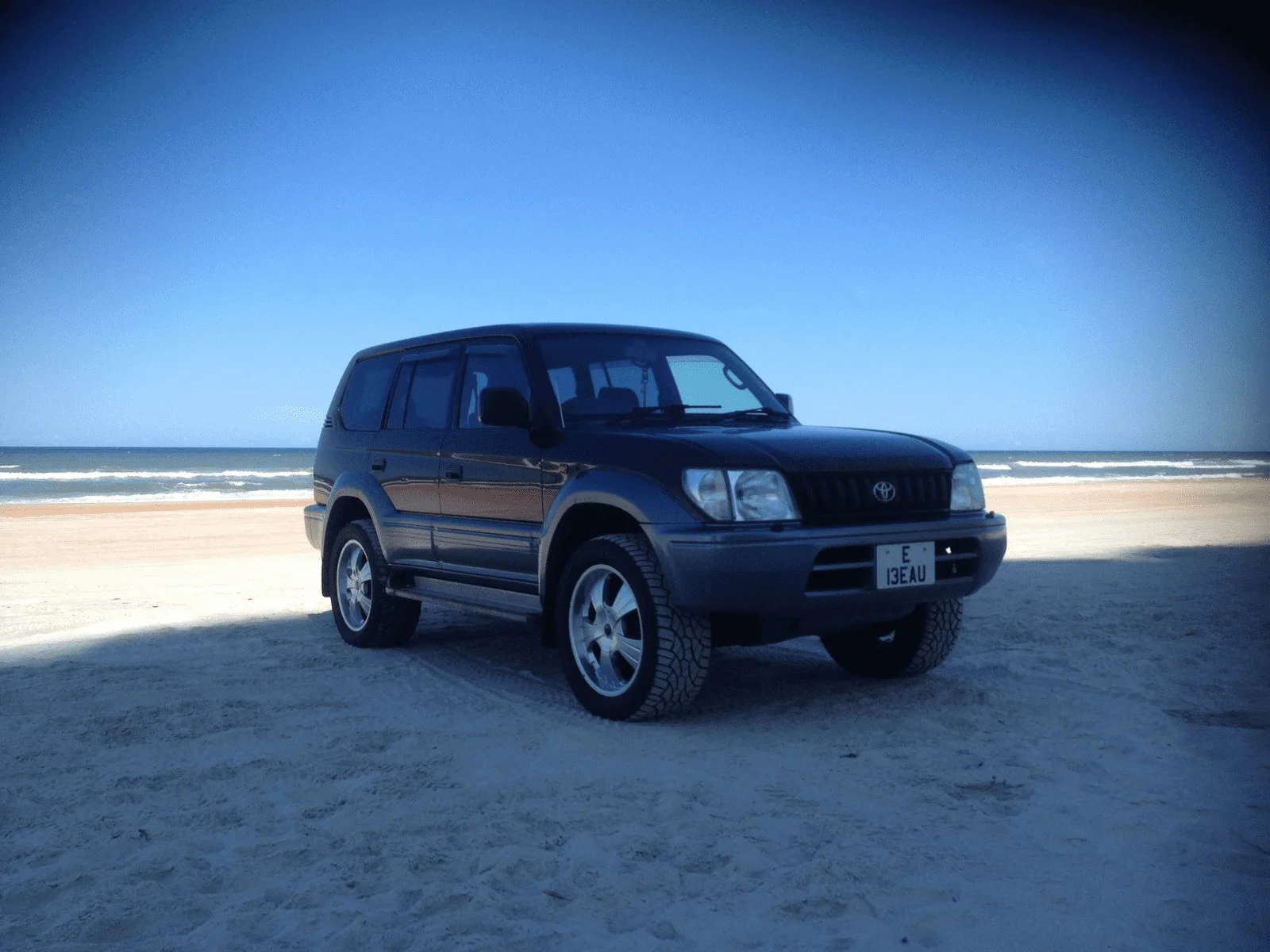

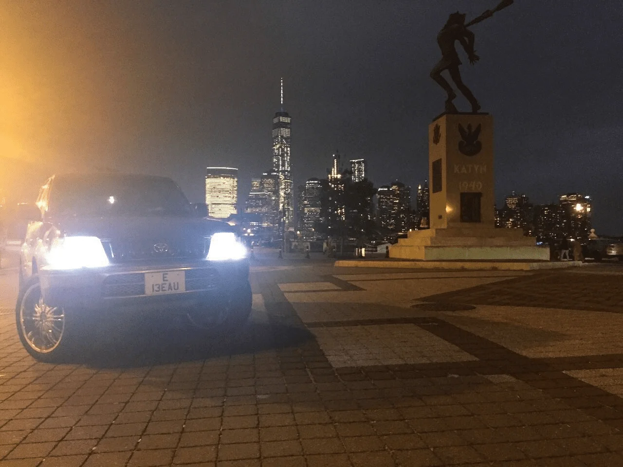

Yes, I imported the truck over when I moved to Florida from England about 5 years ago. It's a 1997 Prado RHD Diesel 1KZT-E. At present, I believe it's the only prado diesel in the US. Honestly wish they sold the diesel lump over here for the 100 series, the torque from diesel just allows for such easy driving. I personally find the 2uz a very lazy engine compared to me 1KZ.
You can’t tell us all about it and not post a picture!
