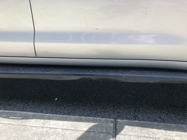

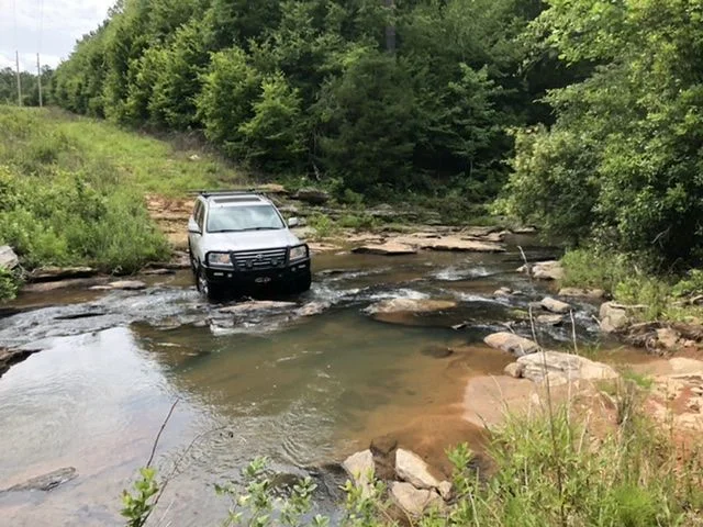

I’ve been off-roading for about 20 years in everything from rental cars, to stock 4x4s, to a full on Truggy, and I have always seen the value in sliders. I just hadn’t gotten to that point with the 200 series until I almost went too far in this creek crossing and mangled the stock step on the passenger side. That experience plus an upcoming trip to Breckenridge this fall pushed me over the edge... It’s time for sliders.

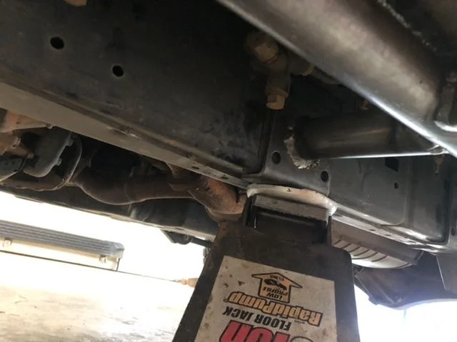

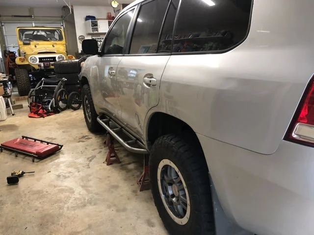

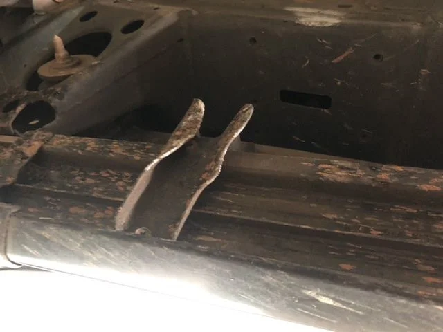

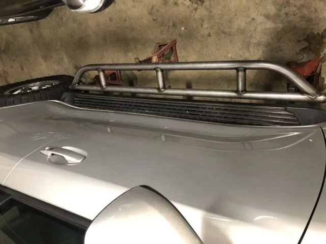

I removed the driver’s side step and did the Initial fit up this morning. I think these will turn out great!

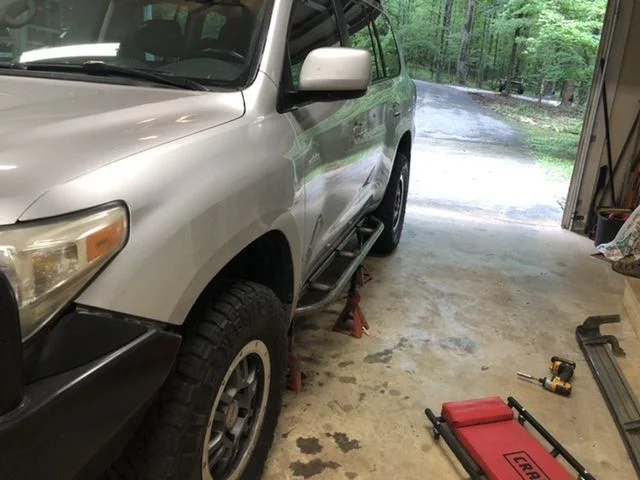

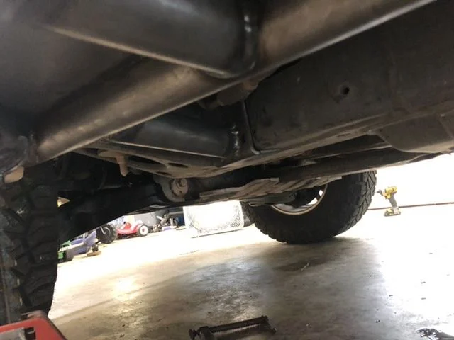

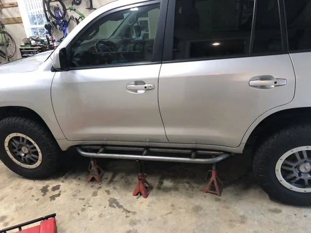

I got the filler plate and the feet and legs done for the first side. I made the mistake of fully welding the filler plates, and i got a tiny bit of warpage. I was able to straighten it out, but now I am stuck fully welding the other side to match. Oh well. I’ll just weld smaller stitches and cool it down in between on the second one. In a few days I’ll hopefully catch the other side up and get them painted for install.
If you stitch weld - do a short section, skip a long section, stitch a short section, and when you've done the entire length, go over it again with more smaller stitches, eventually having a continuous weld - you can avoid warping. We used to do that on rally cars when welding the seams to stiffen the car. If you tried to lay long beads, it would warp the heck out of the metal.
Yup that is the plan.
I stitched these, but obviously took too big of the stitches.
