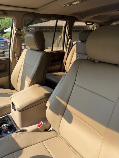

I finished the front seats. Ended up buying from USAutoseatnation.com I am very pleased with the quality and the results. The fit was perfect and the color match is spot on. If you do it yourself, budget a whole day for the two front seats and spring for an assortment of hog clips of various sizes and a good pair of hog ring pliers.
That looks awesome. Nice work!

I do believe that they offer head rest etc but I didn't need them. I'm no expert on leather - time will tell if these wear OK.
