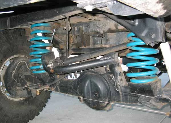

I'd defintely use a 3 link/panhard up front and probably a double triangulated 4 link in back (but possibly another 3 link....depending on space and gas tank issues).
The 3 link/panhard in the front is a good plan and relatively easy. The rear works pretty well, if you want it longer, make longer links and trim the rear of the wheel wells. Or make a U link for the upper and ditch the panhard.

A simple rear 3 link;
