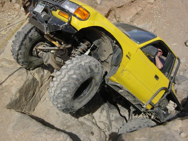

(aka the guy who's shamelessly posting a pic just b/c! ;) )
I don't see an 80 having much trouble on Upper Ajax or Martinez, but I could see some rock rash coming off of H2H and it has been so long since I was on Axle Alley, I don't remember much of it.
The 80 is a heavy SOB though. Just a lot of mass to pull up big verticals, and a ton of sheetmetal and glass up high on the rear (as John mentioned). Spike did a good job on Pyeatt (most difficult trail I have been on when an 80 was along), but his rig is kinda ugly so he didn't seem to scared of a new scratch or two.
I think you are going to have a difficult time getting an 80 to perform to the level your toyota did.

You really think so? I don't know....the old Toy worked good, but after driving my buggy around the little bit that I have, I can now see so much room for improvement in that old truck.....stuff I'd be doing on the next project.
Ahhh....maybe you guys are right. A Runner makes a lot more sense from a size and weight standpoint. Think I could make one of those comparable to my old Toyota, Brian?
